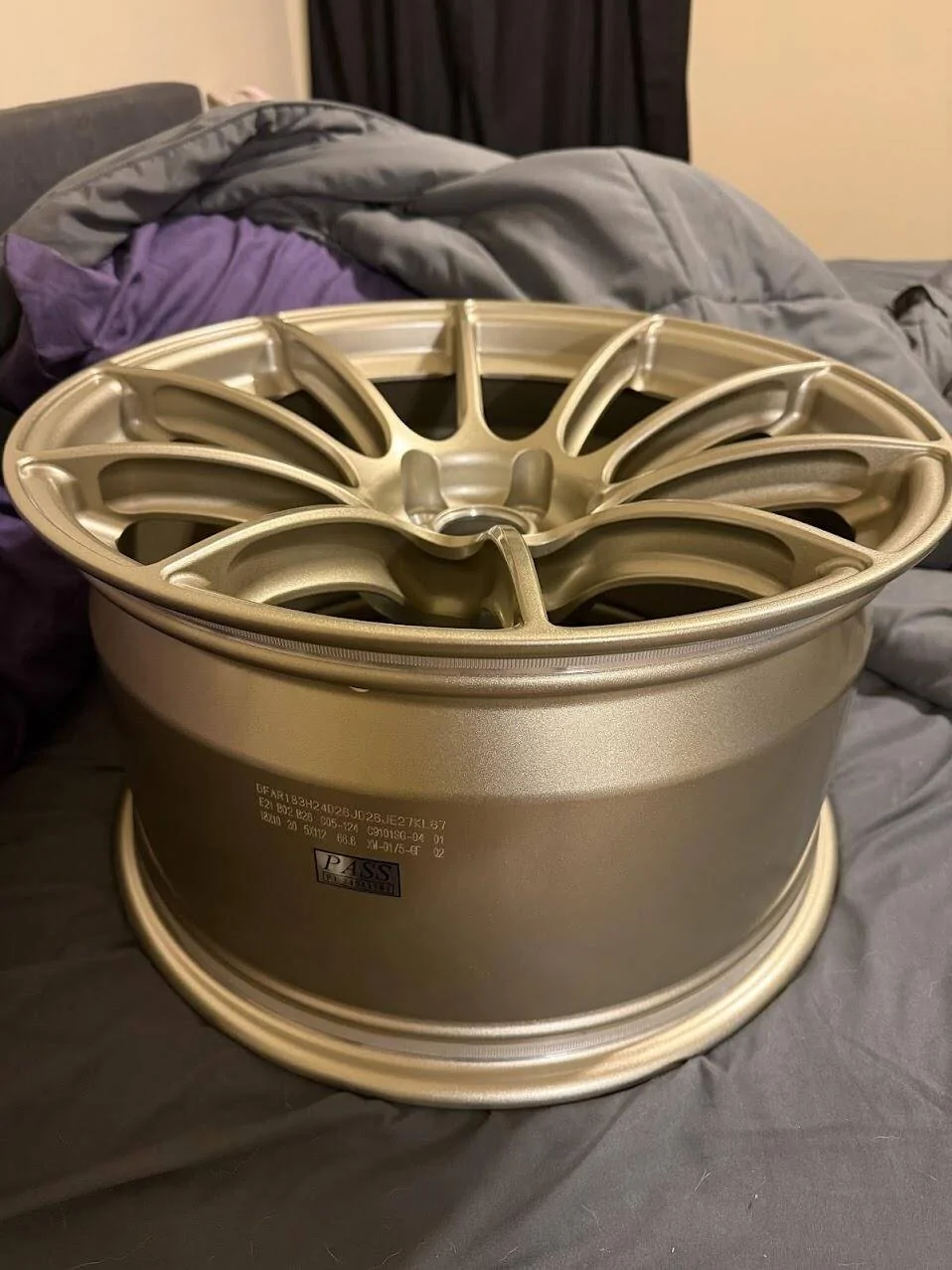

Saw that Apex was having a big sale on backordered rims - so I said fuck it and ordered a set. I was originally going to get a forged knockoff set from Alibaba but with such a big discount from Apex they basically got down to the same cost if I were to order from Alibaba.
SM-10RS 18x10" ET30 in Motorsport gold in a square setup. Hopefully I can run 275/40/18s all around without putting on spacers or messing with my suspension, but we shall see! I think the gold will look very good on my red car :)

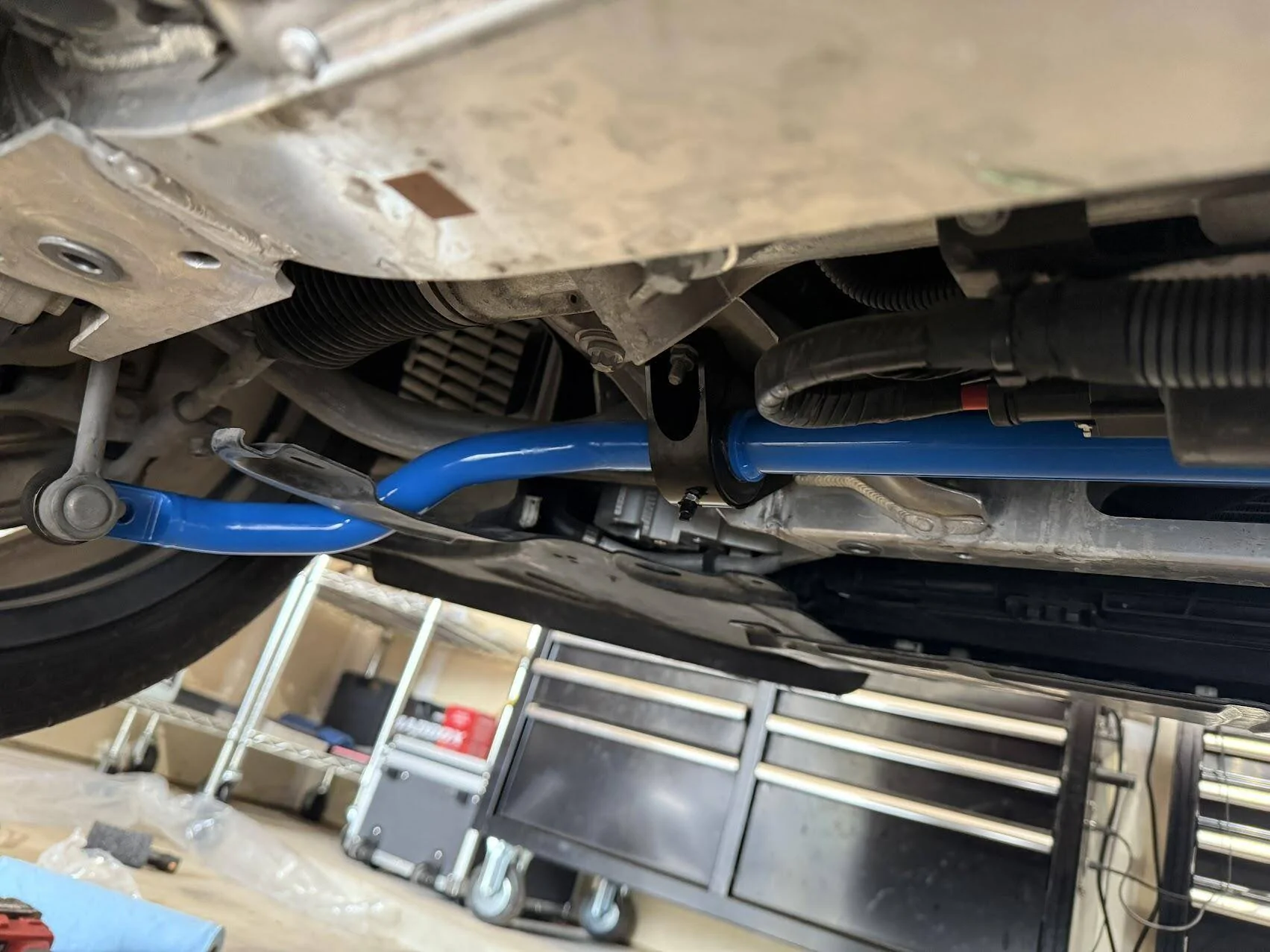

Installed an AFE front sway bar today. I actually ordered it on Nov 15, 2024 but I only got it yesterday - Yes it took A90shop 3.5 months to ship it out to me ? It just kept getting delayed and delayed but I wasn't worried about it as it was low on my priority list.
Zero increase to NVH and noticeably less roll out of the car even on the softest setting. Very happy with it! Eventually I might get around to ordering the rear counterpart but not anytime soon.

Nice!!!!!! Get the rear one to complete her. You won’t be sorry you did ?

All 4 rims arrived (2 on Friday and 2 on Saturday, unsure why half the shipment got delayed a day)
Apex SM10-RS 18x10+30
Have an appointment with Discount Tire to install 275/40/18 Continental Extreme Contact Sport 02s onto them after all the positive reviews I saw on the tire. Very excited! Really hoping they clear the stock suspension without spacers because I hate spacers on street cars (and in general but I'm more willing to put spacers on my track cars).

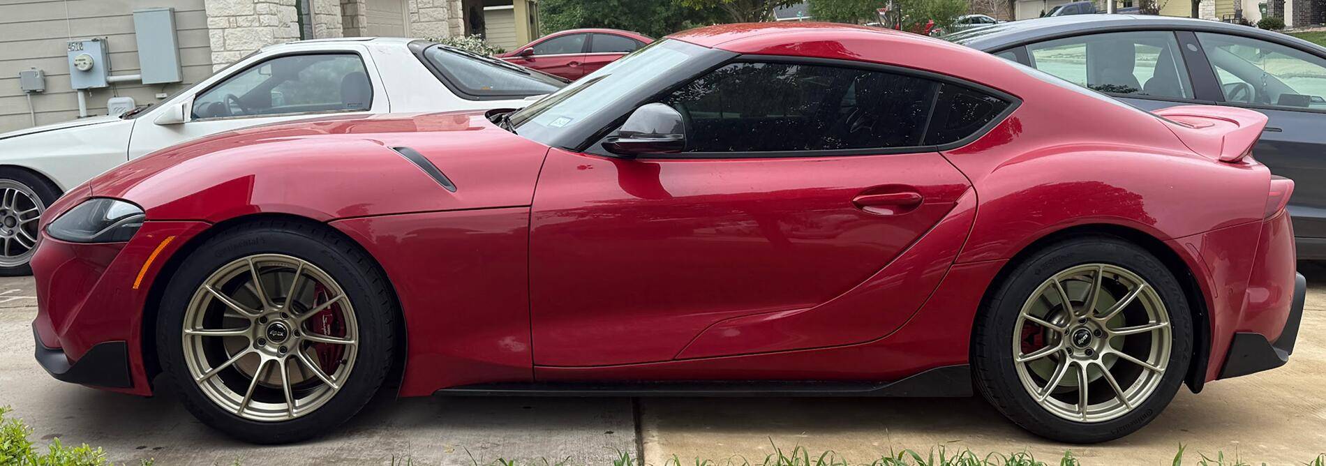

Installed new rims and tires
Apex SM-10RS in Motorsport Gold
Square 18x10 ET30
275/40/18 ExtremeContact Sport 02 filled to 33psi
Stock suspension, no spacers.
Just clears by a few mm. No rubbing issues that I felt on the 30 mile drive home. Thank Satan because spacers are the worst. I've ran spacers in multiple cars and still run them in my championship winning rally cross Mustang, and I still hate them ?
