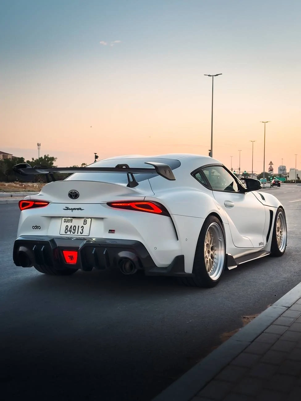

Got a custom made valved exhaust from Bullet Performance Exhaust in Abu Dhabi, UAE. Super happy with the sound, and they were able to extend the tips to fit the Adro diffuser!
Spec:
  • 3.5” Downpipe exit (DAW 5” catless)
  • 3.5” main pipe
  • 3” dual mid pipe
  • 3.5x10” dual resonators
  • Wireless valves to exit (muffler bypass)
  • Single muffler
  • 4.5” tips
  • All 304 stainless steel

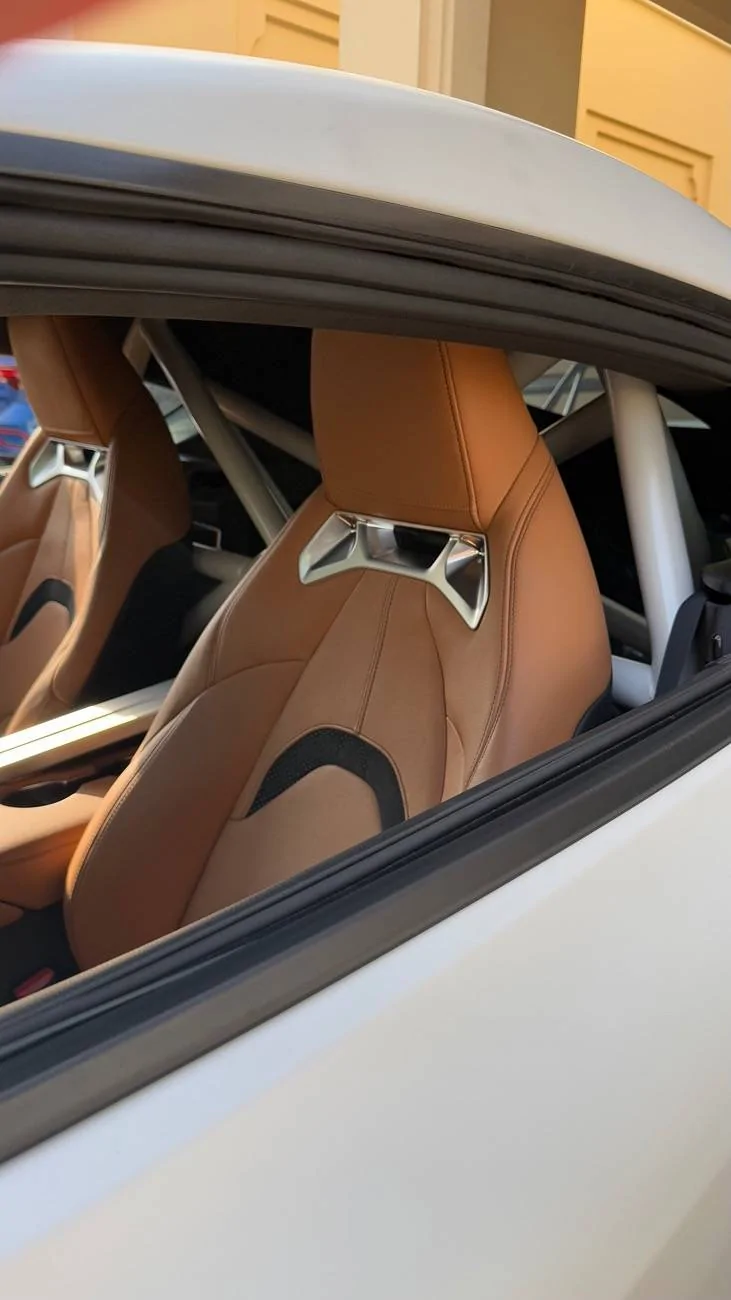

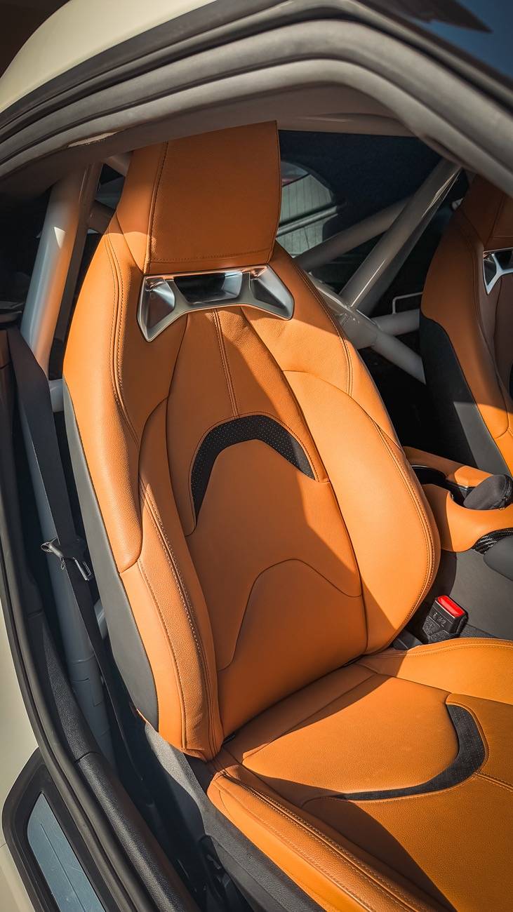

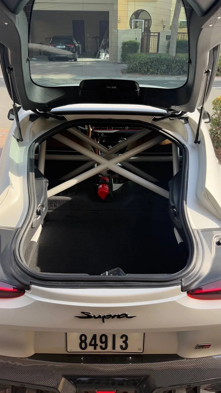

Got a roll bar done! Next up, seats! Stock seats are too thick and I barely fit!

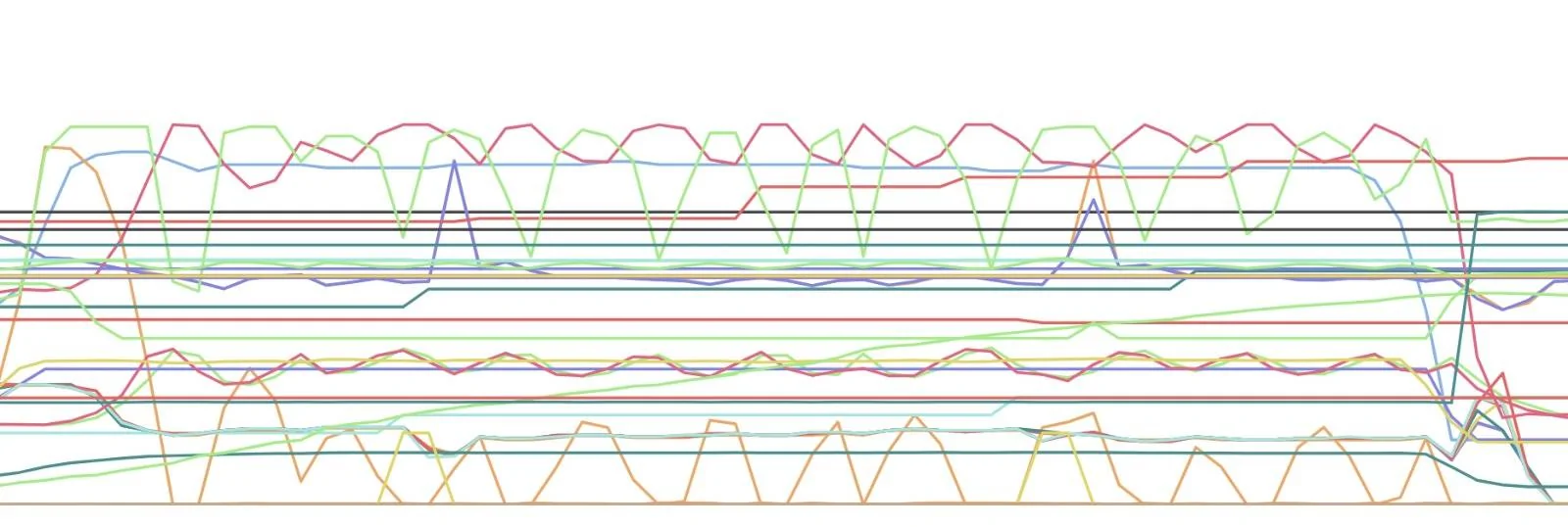

Another track day! Dubai autodrome Club Circuit. My PB is 1:16:62 but that video got currupted. Here is a 1:18:14 run. Still lots to improve. Best Supra in our group is 1:08:xx and the best overall car around the circuit that i know of is 1:01:xx
Intrestingly, the car was giving me very pulse-y power under high load. If anyone has any ideas why id love to know. Attaching the lodg of a street pull in Sport Mode with traction off. It does it in both drive modes and all TC settings.
Log: https://www.bootmod3.net/log?id=67bdd9cc2c00ea6dcbfcfc85

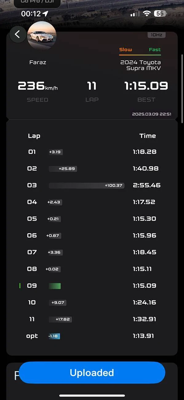

Another track day another PB! 1:15:09. Can probably shave 2s when I get 200tw tires. Seasons coming to an end though sadly
