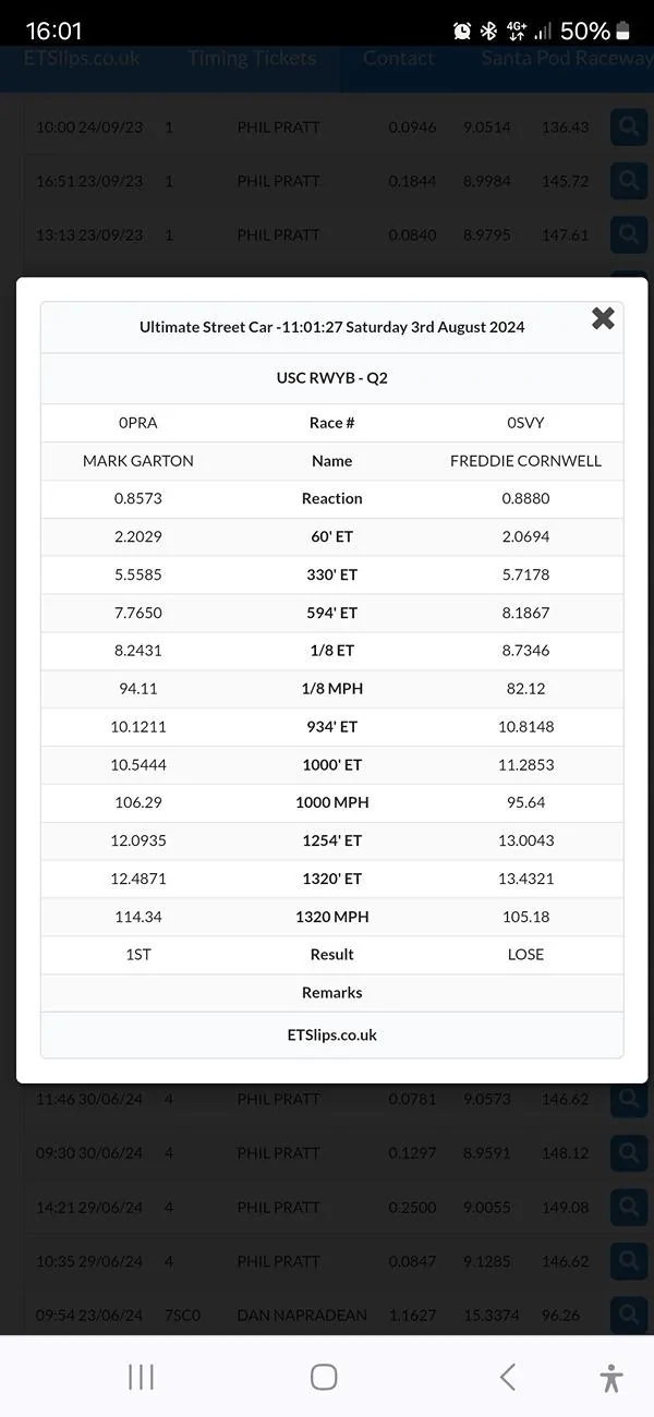

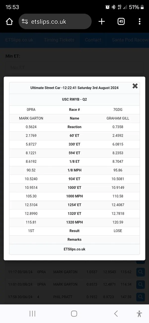

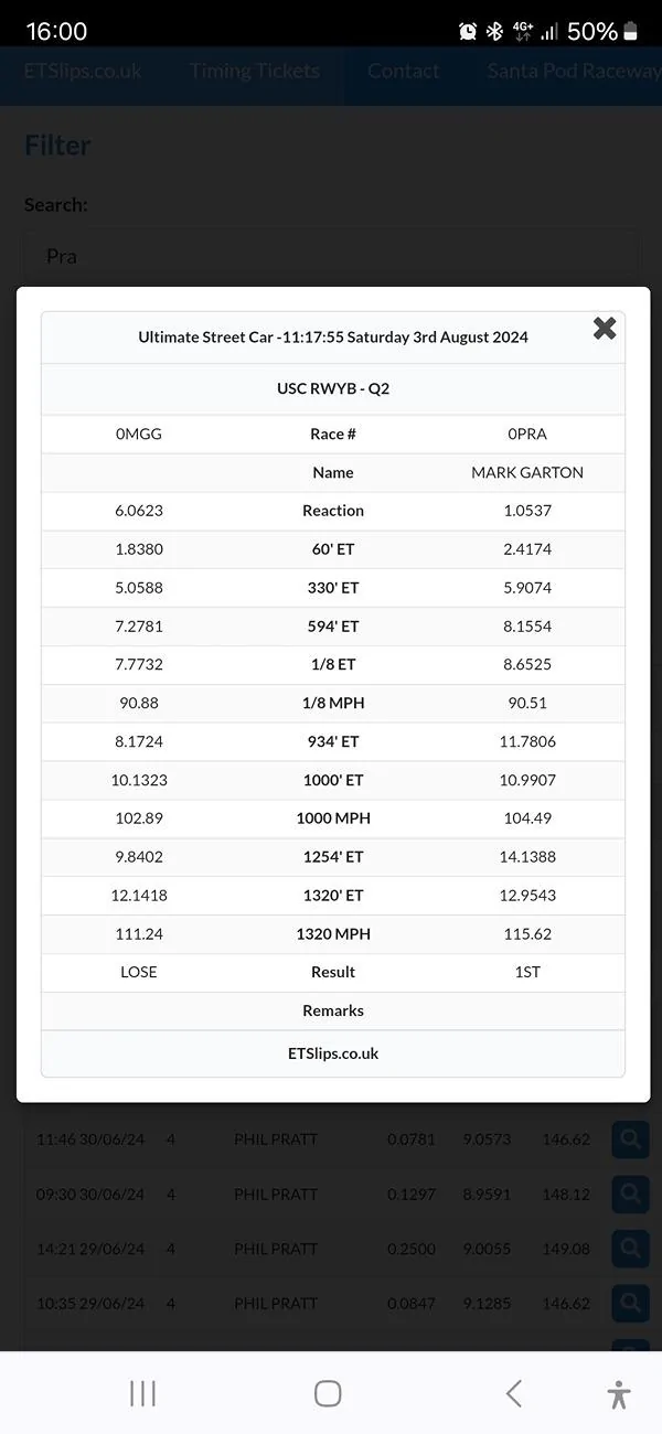

Tires and learning the car. The stock tires aren't doing you any favors on launching as evidenced by that 60' time.
As previously mentioned your trap speed is low for being tuned. Did you datalog these pulls by any chance?
bk5
BK
Oct 26, 2023
224
293
Ohio
CUL A91-MT
Stock tires are still good for a 1.8x 60ft. So I think step 1 for OP is learning to launch properly.
