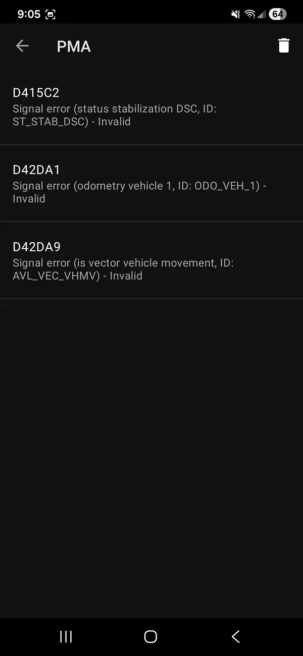

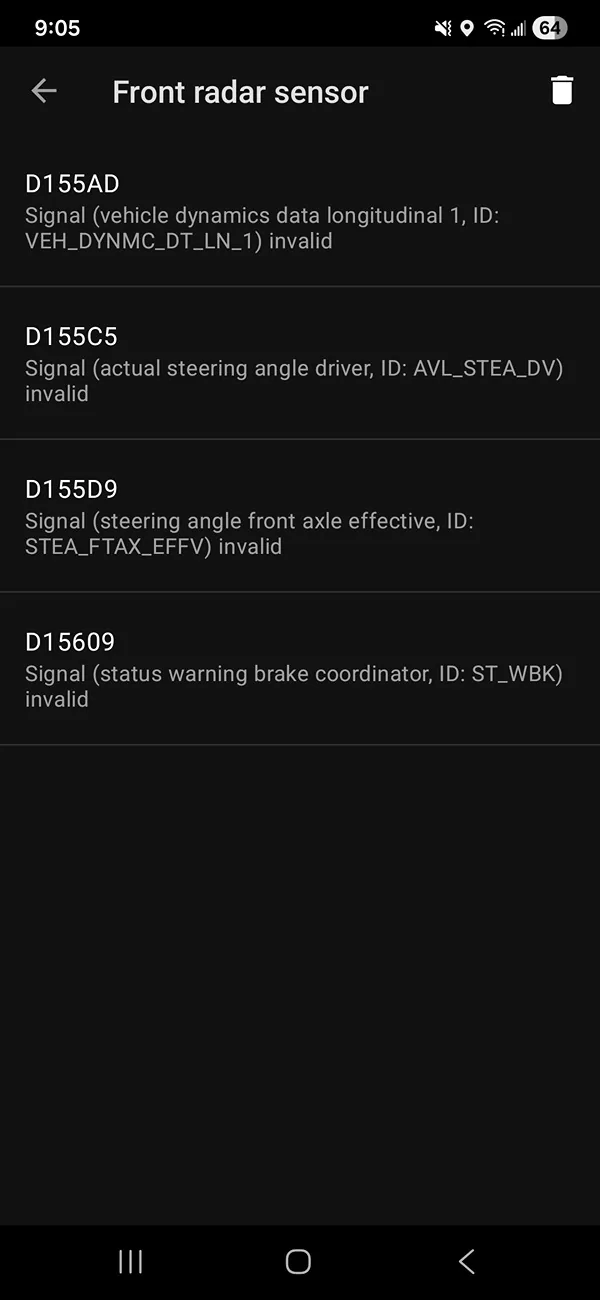

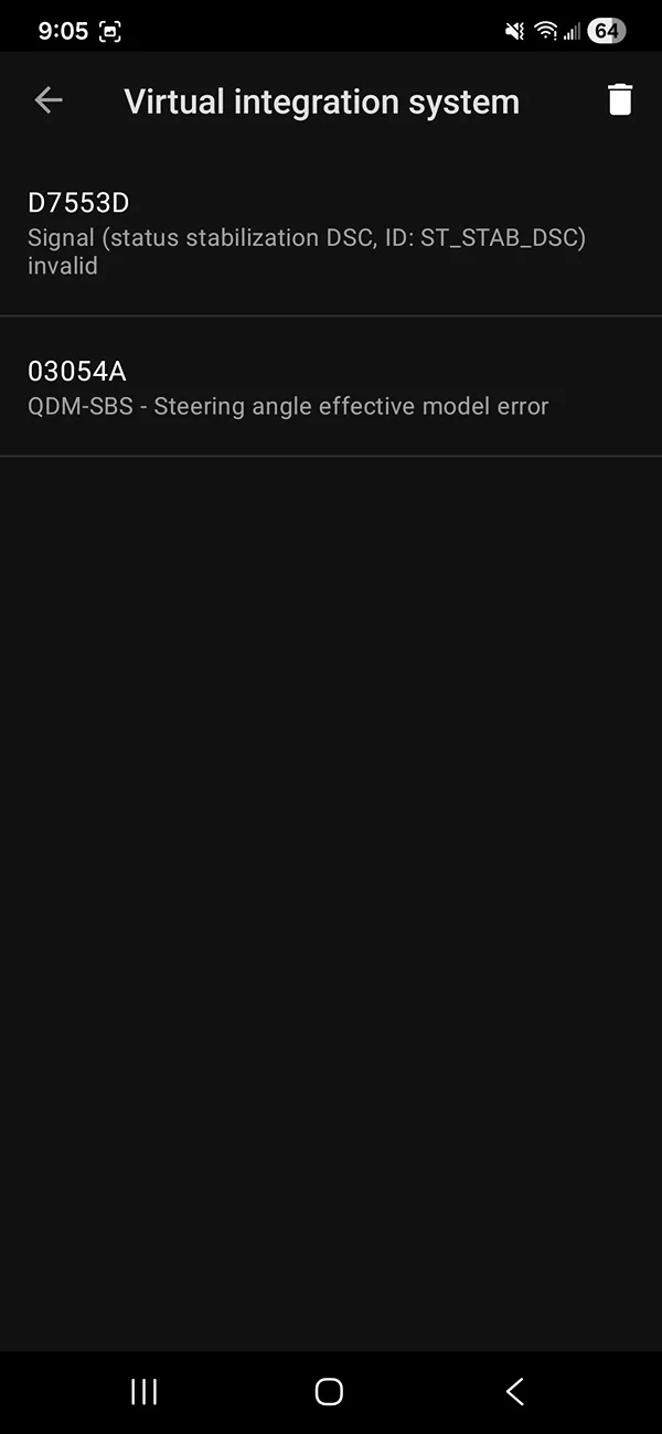

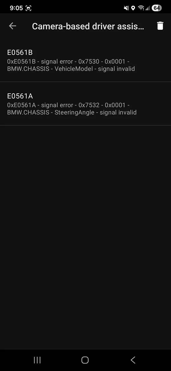

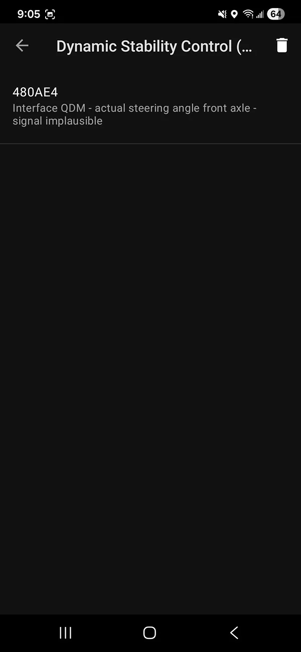

So I just went through the procedure and it made me start at 30 degrees right. Then all the way left then hold, then all the way right then hold then straight ahead and then press continue. But I am still getting a bunch of codes.

Ok. So quick update. I drove around for a few miles and the codes went away! Thank you for everyones help!
