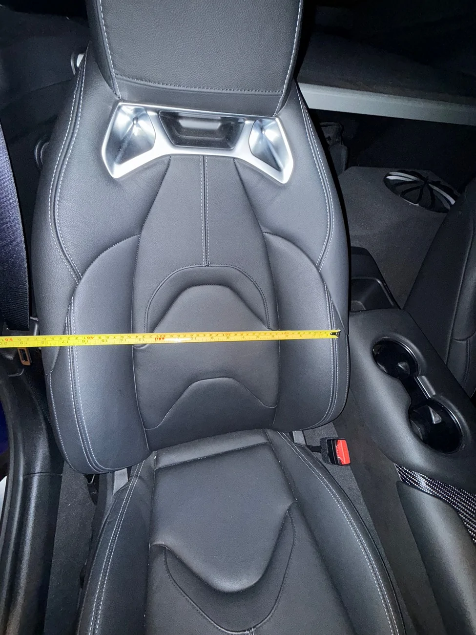

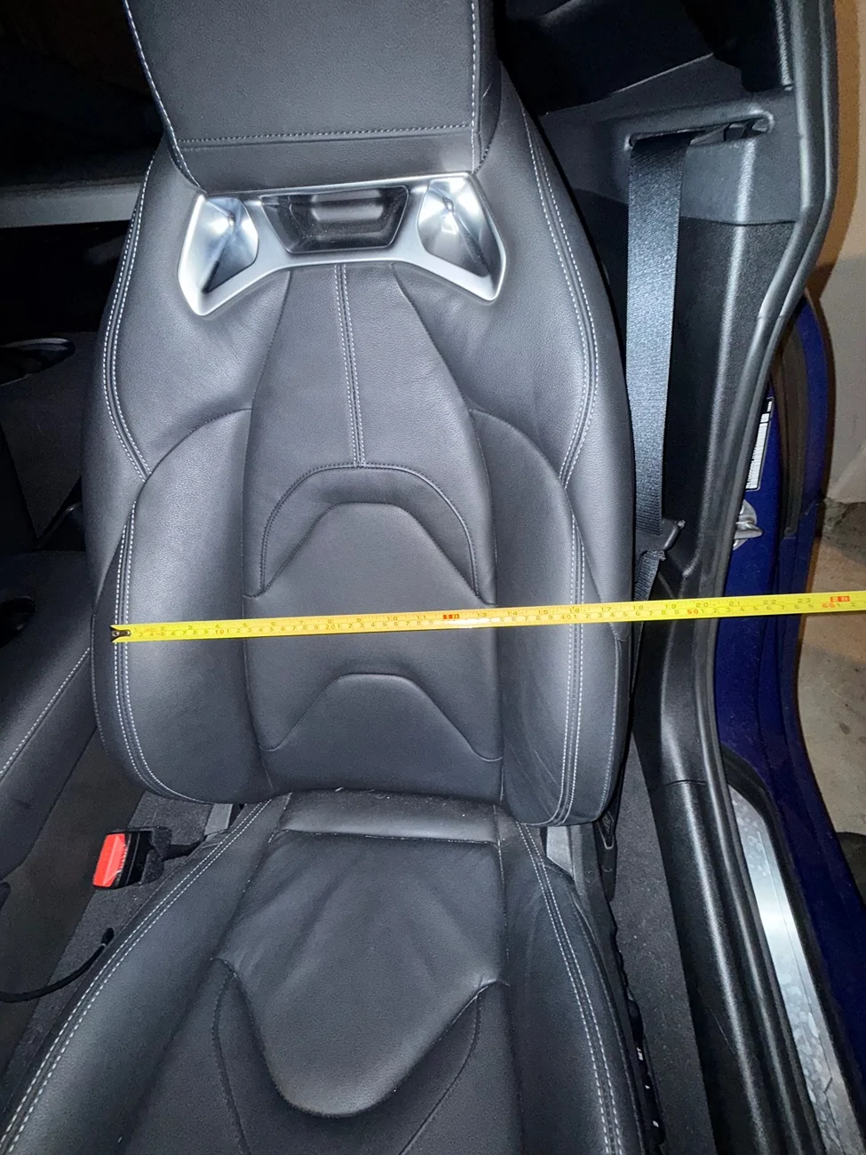

Just because the bolster adjustment is still working doesn't mean it's still going the correct/full travel in one direction (widest).

maybe should of measured maximum bolster setting measurement. maybe bolster is stuck on medium to max.

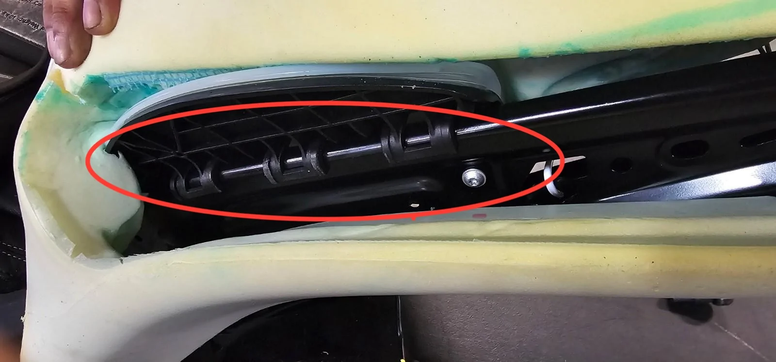

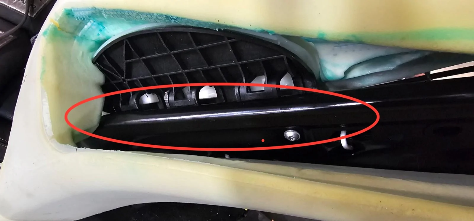

Just got the car back with the fixed bolsters.
This is the condition they found the bolsters in. This is missing a clip to hold the bolsters. I believe the clips were there but just broken and had come off
This is what it looks like after they fixed it using new clips.
It feels better and I also confirmed the fix using the measuring tape and now the driver’s side and passenger’s side measure the same.
