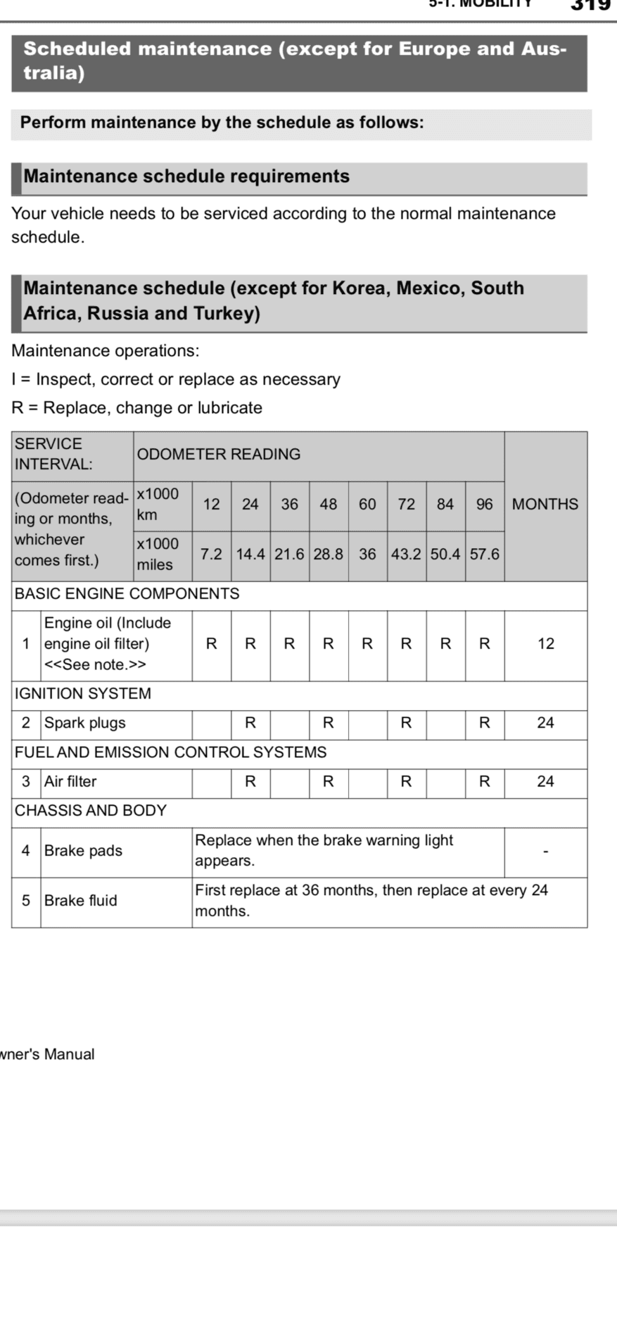

Don’t get it, not worth it at all. You have 2 years of free oil changes if you chose to have them do it. All the service plans cover is routine items you can do yourself.
Here are the service intervals. As can see most of it is inspection to 48 months or 40k miles.
-RJM

Thanks ... ya, service looks pretty minimal.
