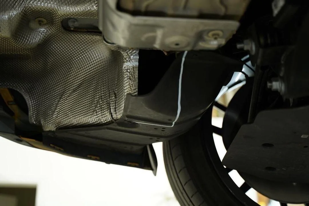

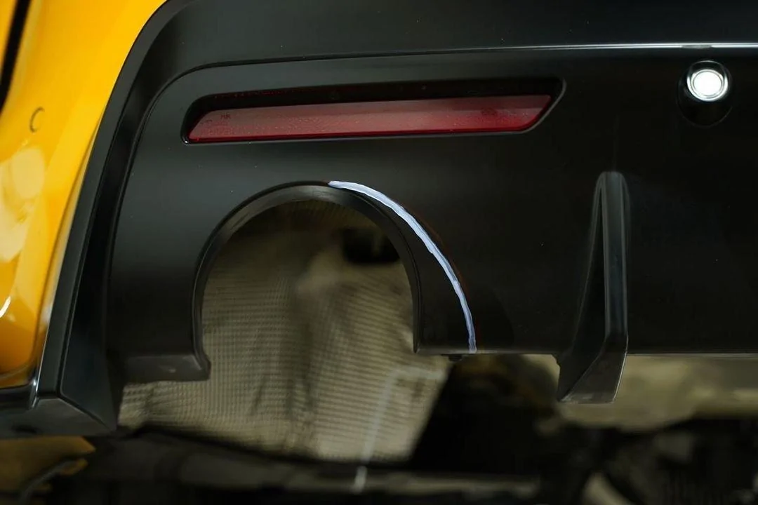

@SnowCr4sh SP1 R is a beauty, placed my order last month, just waiting for it to arrive.
@Yabai yes trimming is required. Someone that installed theirs already sent me some pics of what needs to be trimmed. Got more pics but below shows what areas need trimming
