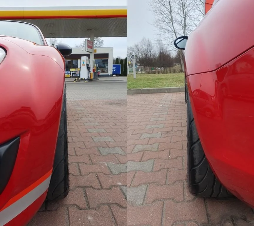

@tadda, @Torquem & @Prodrift thank you very much for posting your pictures and info on spacers, it's been very helpful. I'm also considering 10/13mm setup on a new set of OEM size rims + OEM suspension but with a set of Goodyear Asymmetric 6 tires (F:255/35/19 and R:275/35/19) which after measurement seem to be approx. 10mm narrower than OEM Michelin Pilot Super Sports (they are wider than spec). @tadda, @Torquem & @Prodrift, can you post pictures of your setup from angles shown on below picture (Miata for example)?

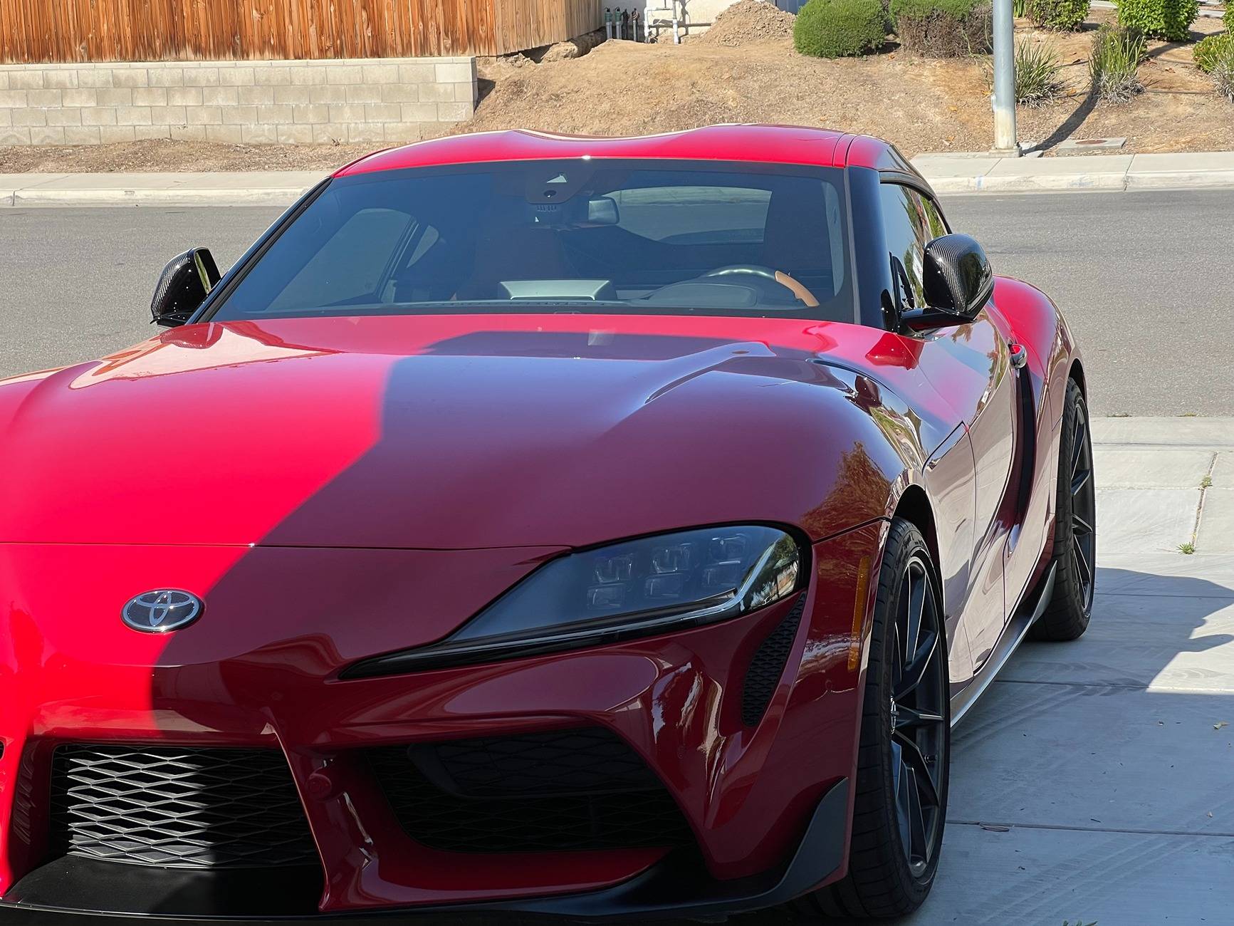

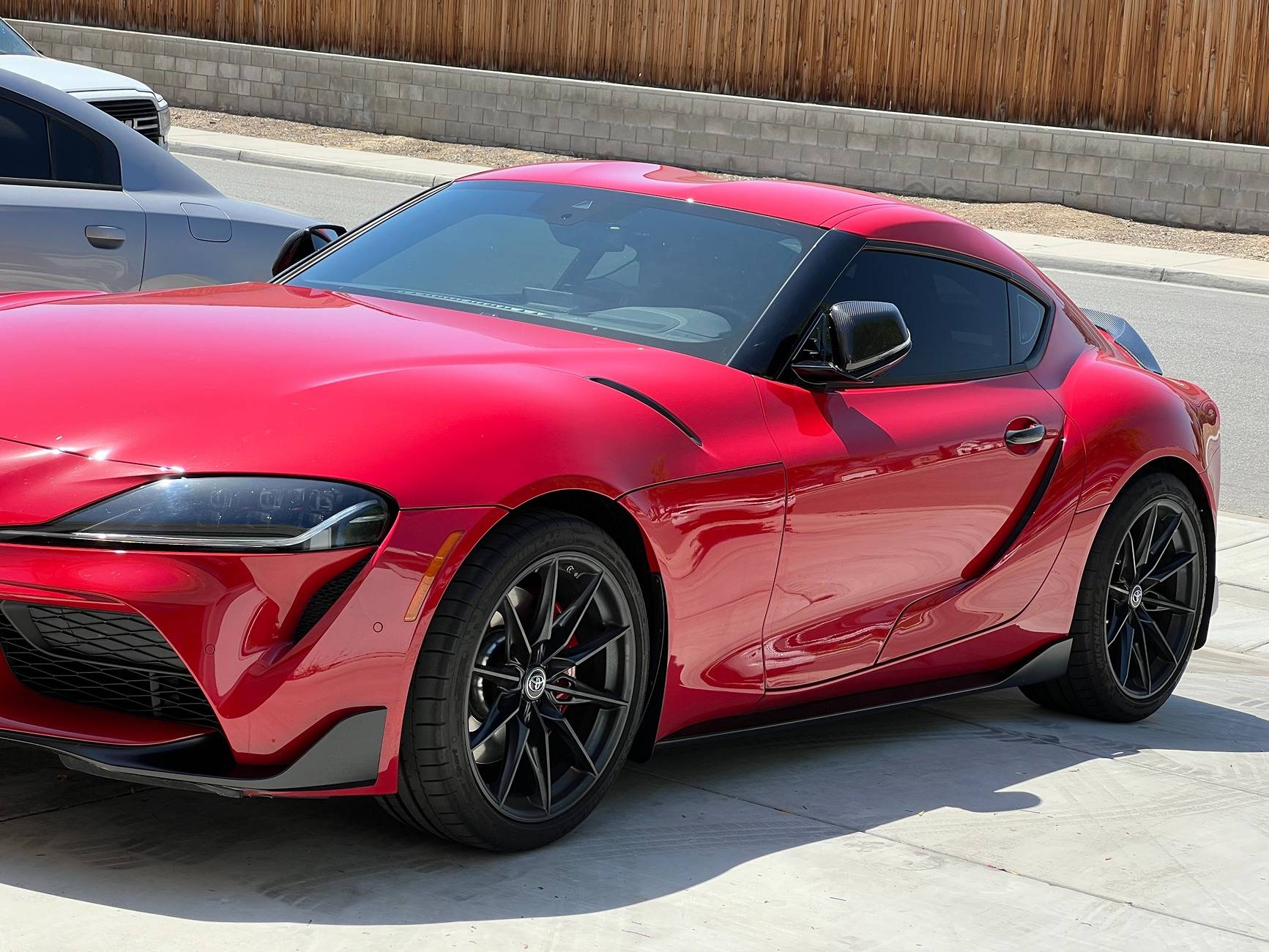

Just installed 18mm (F)// 20mm (R) on stock suspension over the weekend. Wanted to contribute to this thread as I haven't seen a lot of pics with this offset. Spacers by Bonoss from OEM+ and I am happy with quality and service.
I love the way it looks, but I noticed the steering feels a lot more numb than before installation. This seems to be a known tradeoff that I don't feel like is talked about on here enough... I don't know how I feel about giving up the tight steering feel for the aggressive looks that the spacers provide. Contemplating on if I should move the 18 to the back and dropping the front to 13. I want to reiterate that I LOVE the look but the steering feels more blunted than it did before.

Losing 18mm of offset is a huge leverage hit to your steering, so thats not surprising
