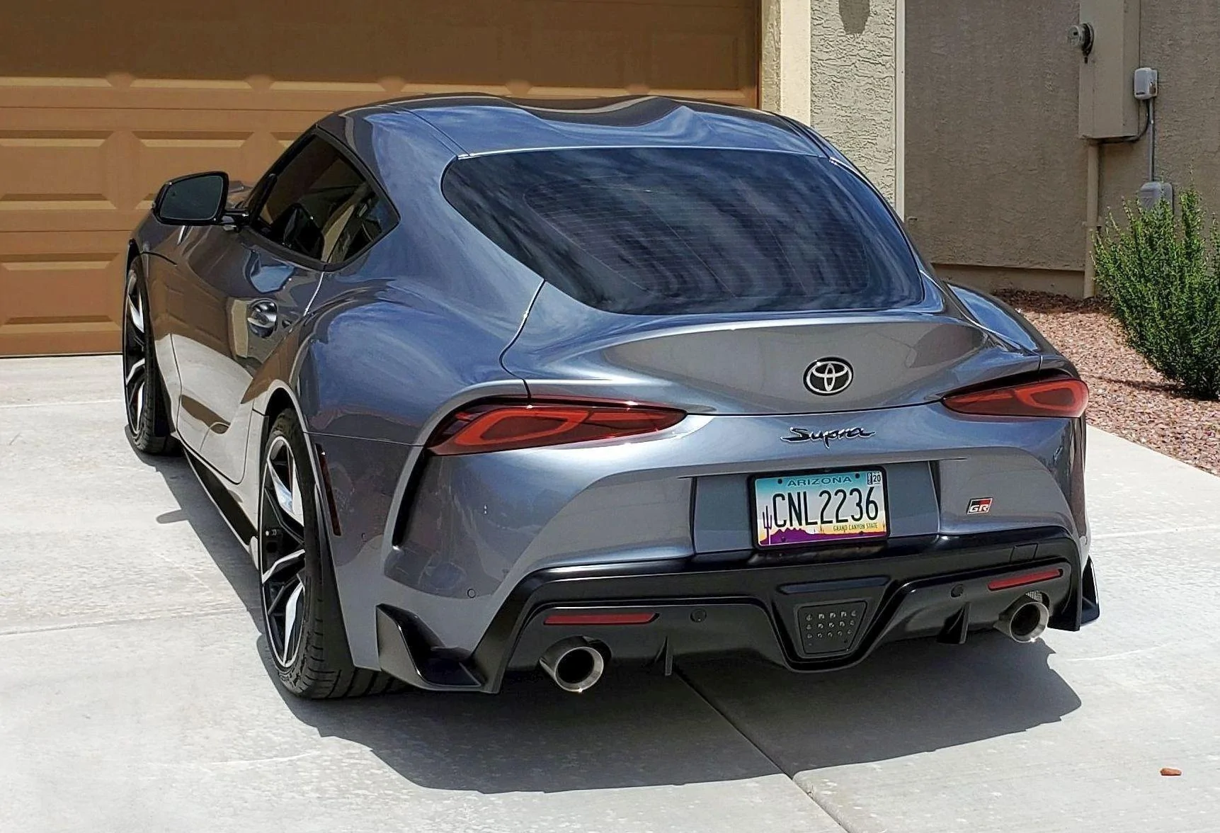

IMO 15/18 would have far too much poke on a stock suspension and look a bit off appearance-wise...Also if you decide to go with this much poke make sure your rockers and lower rear fenders are protected as the paint will wear fairly quickly due to road rash....
I went with 13 / 15 (stock suspension) and they are fairly flush with the fenders...I personally wouldn't go any more than this on a stock suspension...I also added splash guards for paint protection...

Tadda, what splash guards did you use? would you recommend them?
Splash Guards
These splash guards are one of the first things I added beside PPF applied to the front bumper area...After 2000 miles I still have absolutely no road rash or pitting of paint behind the wheels as a result...Also nice to not have mud splash ups....They are also a must have if your going to add wheel spacers to widen your stance...And I don't find them at all distracting from the appearance and hardly notice them at all!
Here is the Splash Guard Thread posted here on the forum where these are discussed in detail...
