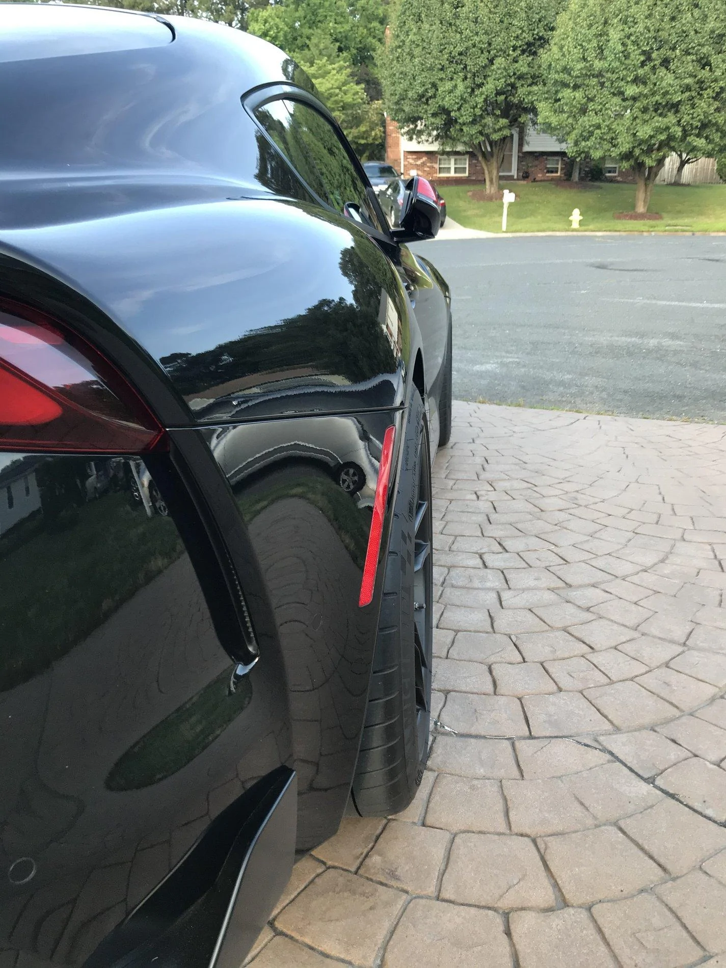

So, in the end, which is better/safer/stronger? Burger, Fantasy, or BONOSS?
Is it OK to run 20mm rear and 15mm front on stock wheels/tires?
8,816
17,302
Anything that is both hub AND wheel centric is your safest bet.

Did you go with the 15 & 20mm? I intend to try it as I'm not lowering the car (yet). I'm scraping coming out of my driveway now.
speaser
Rick
Sep 2, 2022
100
161
GA
2023 A91 MT SE, 2019 TRD 4runner
I haven't done anything yet. Let me know how that works out for you.
Just put the 15 and 20mm spacers on. I'm glad I didn't go smaller. I'm tempted to go a little bigger still on the front - maybe 17 or 18. But ... I will leave it alone for now.
