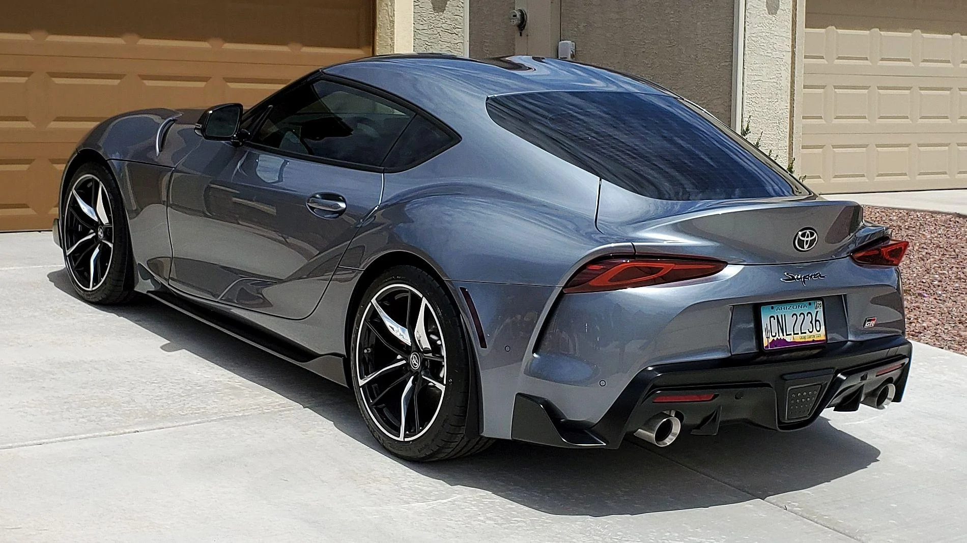

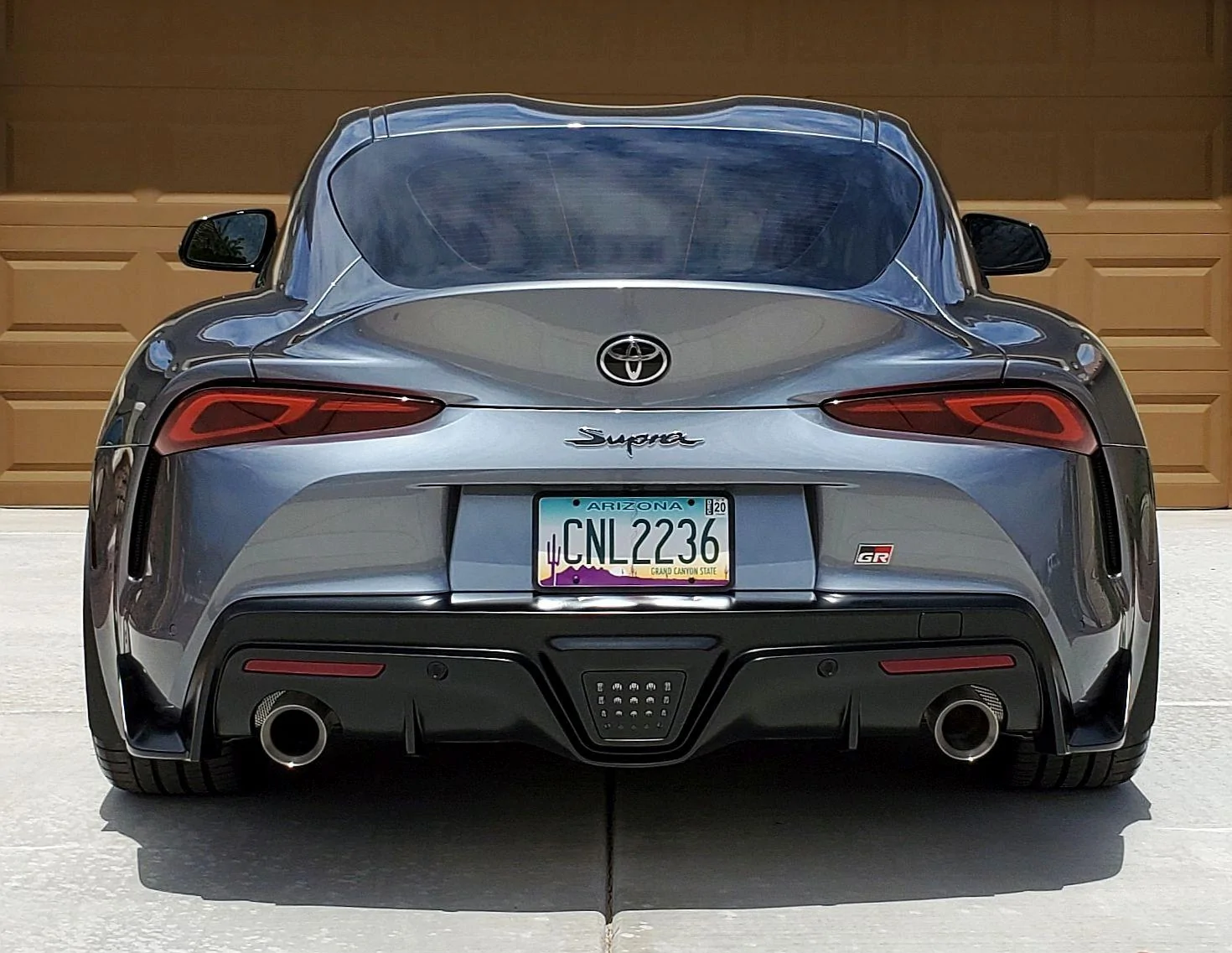

Well I received my spacers 12.5mm ECS and 15mm Turner spacers today from ECS...
And the fitment of both spacers were perfect! Turns out ECS posted wrong info regarding Turner spacers and they are indeed 66.6 CB with 5x112 bolts!
Pics to follow....
