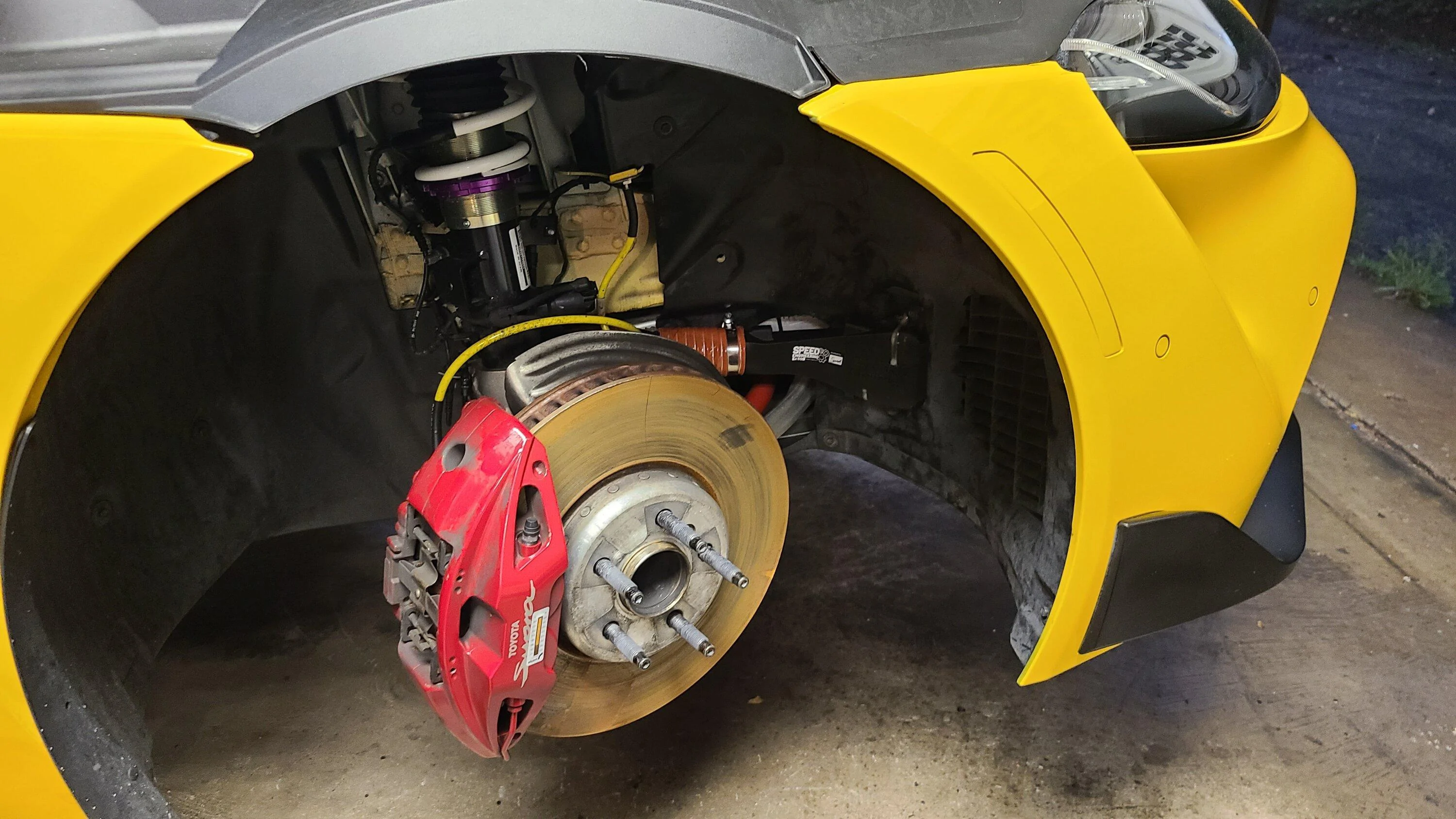

Thank you for the comprehensive review.
How exactly does the air inlet/opening of the duct mount to the wheel liner?
There is an opening in the fender liner that directs air into the wheel well/brakes and is held into the wheel well with 2 screws. This duct reuses that opening and covers it using the 2 screws. You can see it partially in the 11th picture down.

i have the same kit
works great
but with oem wheels without spacers the wheel will rub at full lock.
Great write up/ review! I have the Verus duct kit but even the replacement parts are pretty expensive. Hope it holds up well. More options for us the better ?
