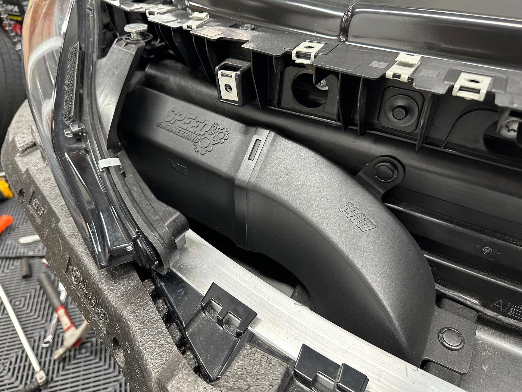

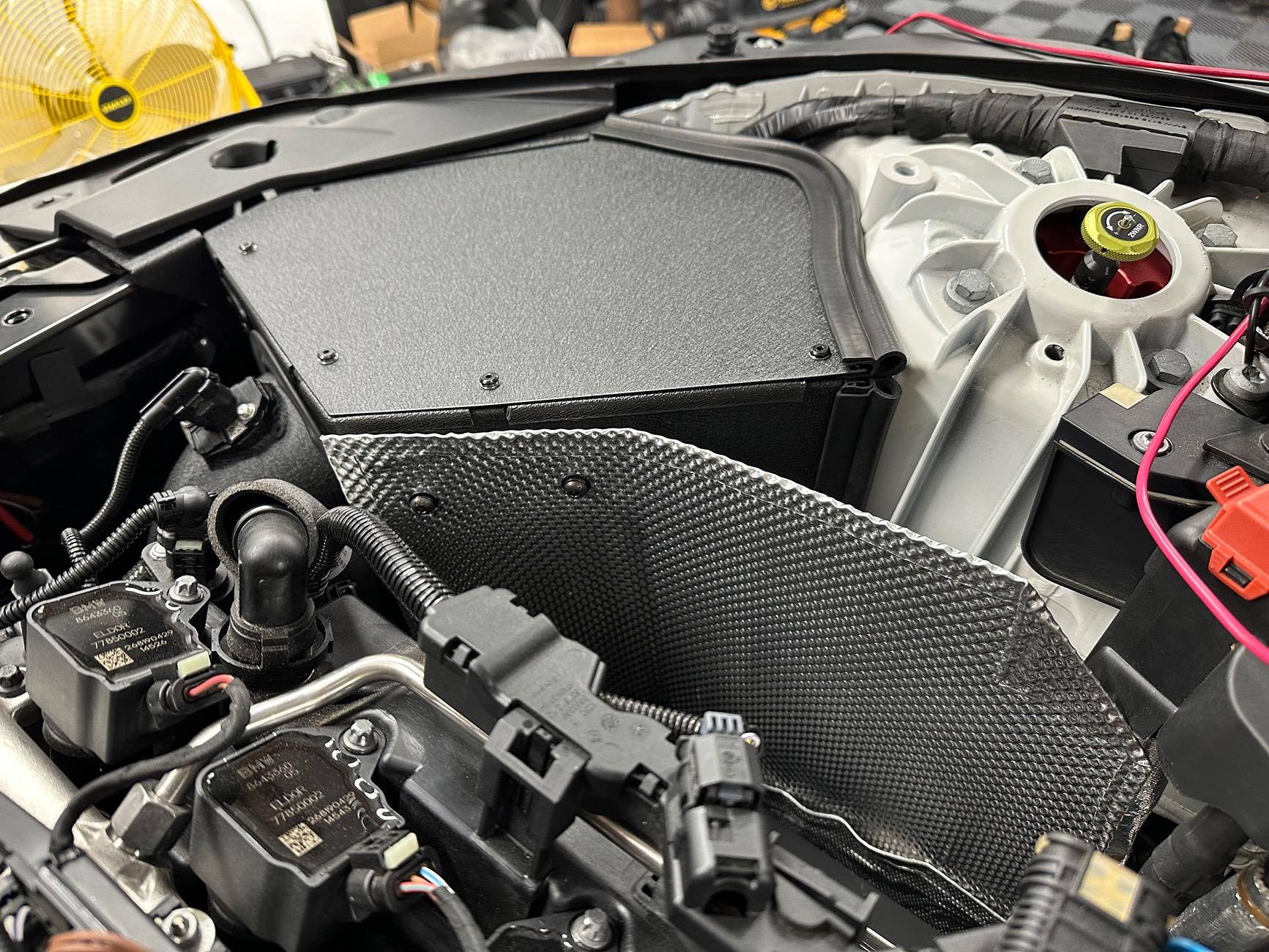

Won’t get many people providing pre turbo intake temps as most people can’t log that sensor.
I have the same intake (mst copy) and also have the speed engineering snorkel. I also added a heat shield for the intake.
I measured temp at the air filter and they are on average 5-8F over ambient at cruise.
