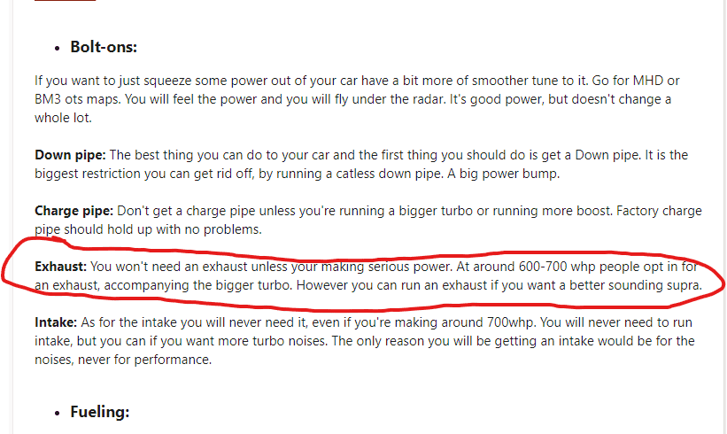

Just the catback in general when it becomes restrictive. I'm aiming for 600whp on a DAW turbo, catless downpipe, intake on 93 with 100% meth injection.

You will be fine with OEM catback at those levels.
