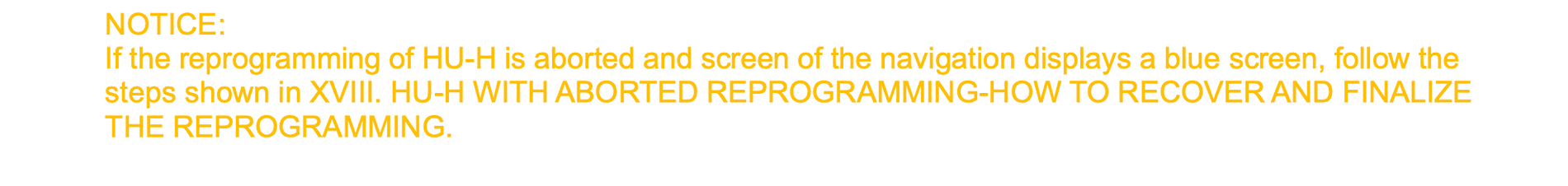

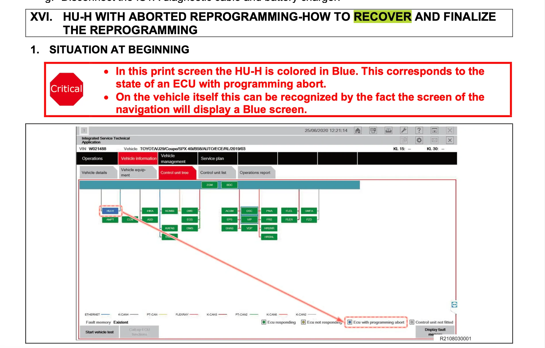

Not that we need yet another thread on the DCM update, but some of the others have become rather..messy, and I wanted to have this information accessible for everyone. If it's redundant, a mod is welcome to delete the post.
First, this is not a (safety) recall, it is a Service Campaign (24TD04). Second, there's manufacturer documentation available on NHSTA's website. I tend to keep an eye on this as sometimes there's interesting information made available.
Here's the breakdown:
  • Memorandum - Not terribly interesting, a small recap of the issue.
  • Remedy Overview - Couldn't find an 'official' document name. This is a 'mid-level' walkthrough of the update process.
  • Technical Instructions - In-depth instructions for the update process via ISTA.
The last document is rather extensive and includes a procedure for if the head unit is 'bricked' during the I-level update (excerpts attached). Although dealers should be aware of this procedure, hopefully this might help owners guide them towards the resolution if needed.
