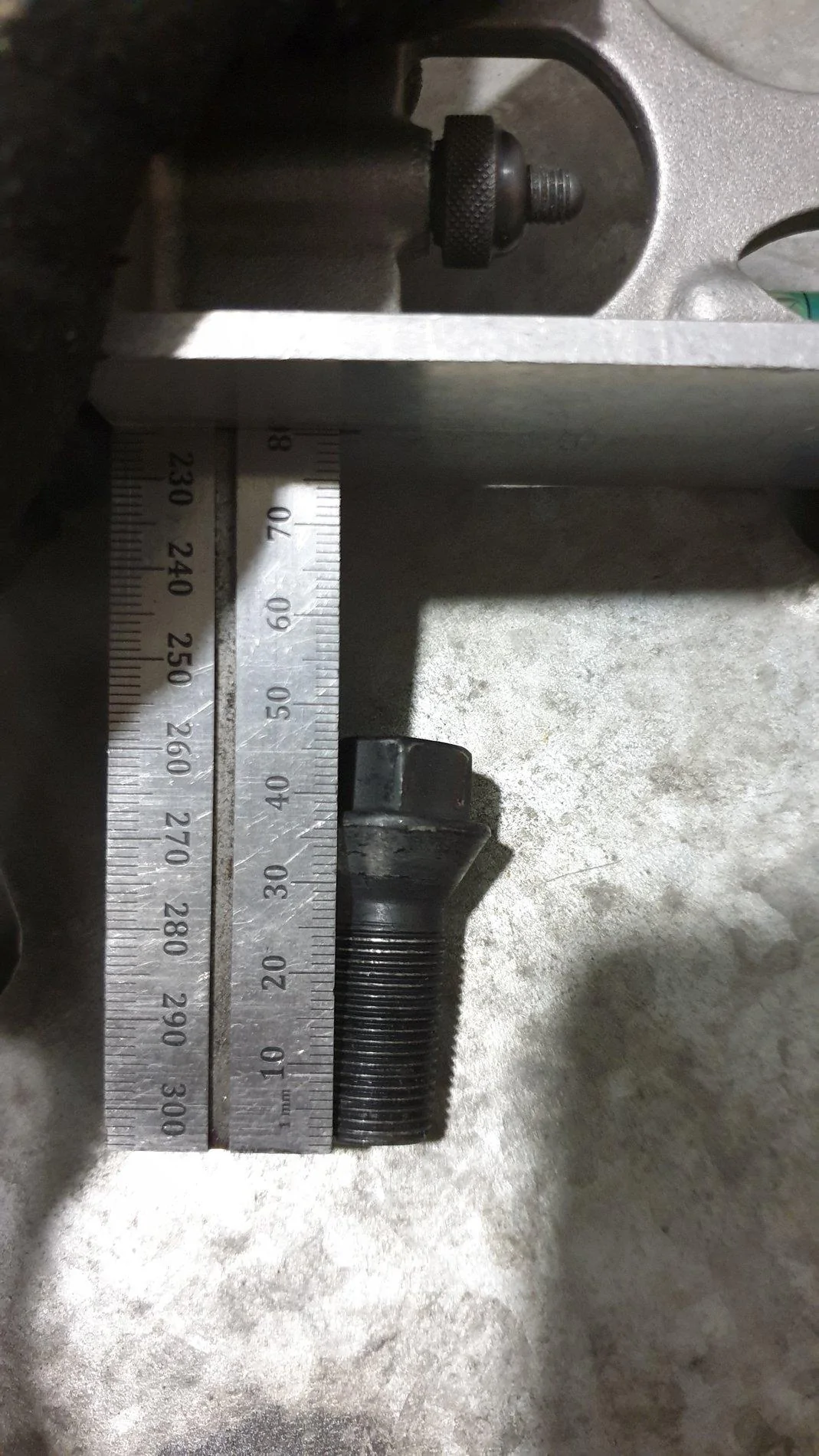

30MilesOffshore
Jan 27, 2020
379
317
Charlotte, NC
So it looks like the bolt measures 28mm. Anyone know how much clearance room there is behind the bolt when mounted. For example, if using a 50mm bolt would it hit behind the wheel?
s219
Doc
Jun 22, 2019
528
635
Virginia USA
BMW X3 M40i, BMW M2 Comp, Ferrari 328
Bolts are always resized (when you add/remove spacers, etc) to result in no-net-change of thread engagement, which suggests the depth is important.
legacy_etu
Brian
Mar 2, 2020
242
154
RI, USA
20 Supra, 16 Wrangler UNLTD
Stick the stock lug bolt back in the tire (not on the car , obviously) and then measure how much of the bolt protrudes past the back of the wheel. This is the length of engagement in the hub/rotor.
