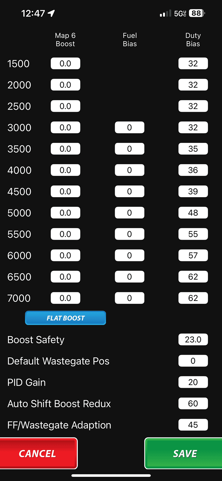

datazap.me | cmant97 | supra ff 45 pulls from this morning. middle one had traction control on so it wonky looking. throttle still seems all over the place after changing the ff/wastegate adaptation option from 50 to 45. I'm also running wastegate bias at the default 50 for everything should i try the settings listed for high flow dp's in your guide?
ColonelAdama
ColonelAdama
Adam
Jan 30, 2023
1,472
1,679
Greenville, SC
Yes, that was going to be my next suggestion. You can probably drop FF to 40 as well when you change the duty biases.
Most catless cars I've reviewed have FF between 35-40 and similar duty bias to what my guide shows

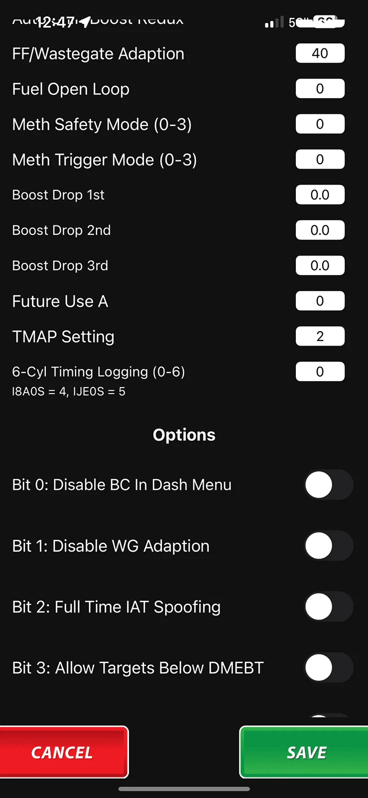

I’ve made those changes this is what my settings look like now will try and get a few pulls after work
ColonelAdama
ColonelAdama
Adam
Jan 30, 2023
1,472
1,679
Greenville, SC
Looks good to me! You can send me the logs in PM so I can keep better track of your revisions.
