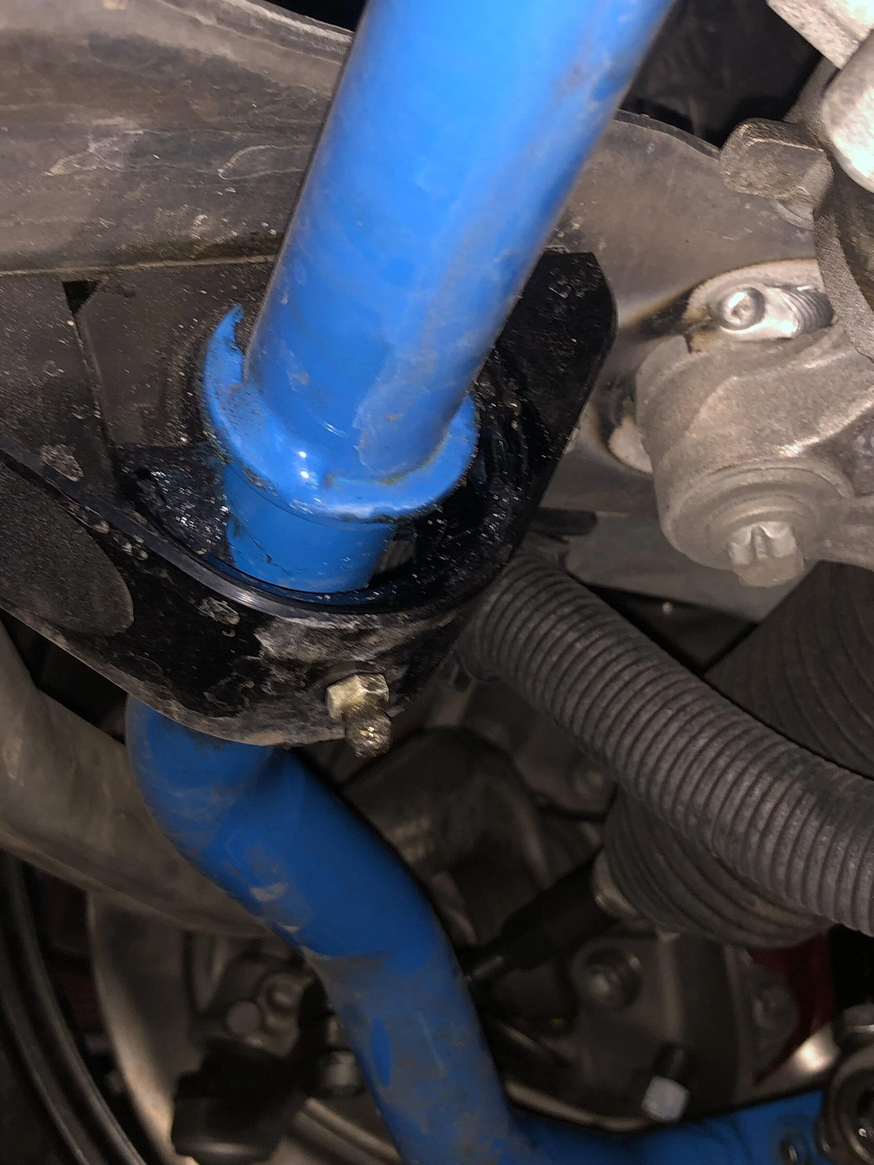

The passenger side poly bushing for my aFe front sway bar broke, causing the sway bar to wiggle and clank around. Crazy, but it happened.
I’ve been trying to find a replacement bushing with no luck. Reached out to aFe but haven’t gotten a reply yet. I don’t want to buy a whole new bar, would rather just replace the bushing but can’t source one. Photo attached.
If anyone knows what could work, that would be great. I’m sure someone has better research abilities than me.

I'd go to Lowes or something and research rubber bushings until you can get the correct one. Just a quick Bing search found a few that might be able to work

A company called Energy Suspension makes a variety of bushings for aftermarket applications in a wide range of sizes. Measure the outer diameter of the bar and see if ES sells one that will fit.
