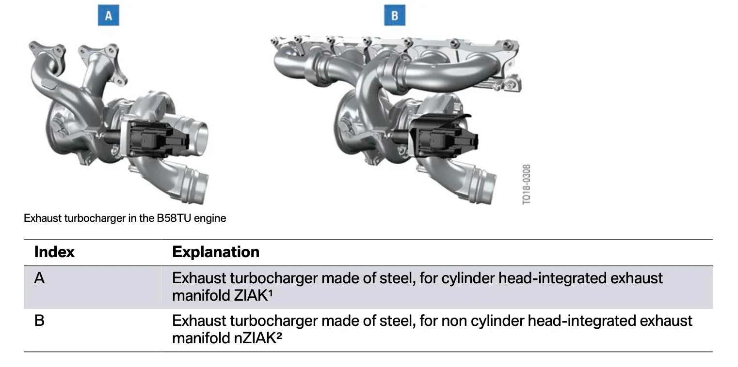

I think most of the power increase comes from lower heat at the turbo and better flow through the individual runners as opposed to the single turbo mount on the B58C. Obviously the pistons play a part, etc. but ultimately it's just that it can handle a bit more boost while remaining as reliable as it's predecessor. At least that's my take from the tech details posted earlier. So technically no, mod for mod the newer engine will likely be slightly better all the way up.
It is a bit of both I think. The B58d has a new cooling system, steel exhaust manifold, higher pressure fuel injection system and lower compression ratio, this should allow the boost to be dialed up for stock without increasing the risk of knocking. So hardware changes allowing a higher tuned stock car?

So Im guessing they went short runners vs long for the extra Hp —as the tq is negligible. I think they will run about the same mod for mod. Either way I never keep a car over 2 years

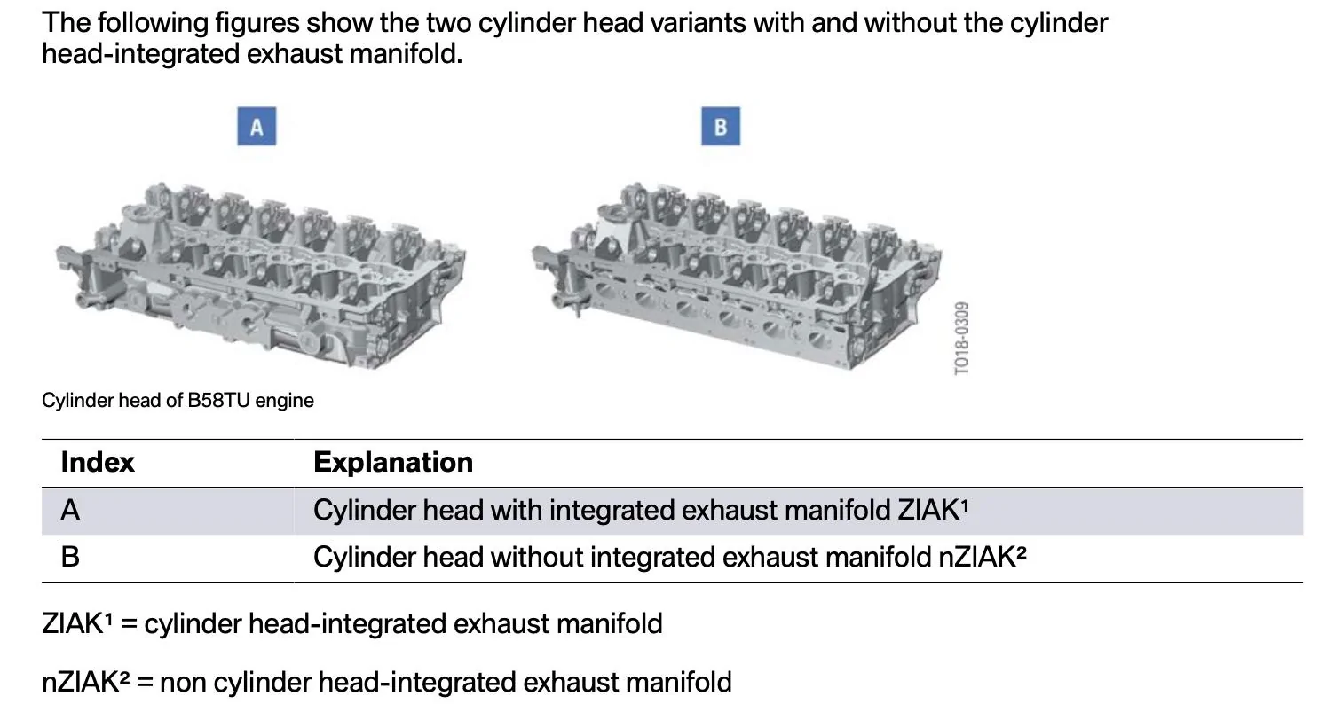

Don't get an RC-F then... the Supra's suspension is far better whether considering comfort or cornering. Apples to oranges of course, but still. The difference is going from 2 combined runners (integrated into head and turbo mount) to 6 individual with a "proper" exhaust manifold to separate turbo mount. As well as the other aspects already discussed obviously. Basically ours has the collector as an internal part of the head... the other does not.
Yeah that's my understanding as well.
ugh, thats for sure going to make more power mod for mod/tune. Its going to have better tuning potential, allow for nice flat tq curve... its going to walk a 2020 everytime all things being equal on top end, everytime...... I feel a bit like the s197 guys when the coyote hit. There is no way I would have bought a 2020 knowing these changes were coming

Everyone is making a big deal out of nothing. A downpipe and a tune is going to make the same power as the current used B58 in the supra. they are basically reverting to the same setup as prior B58s. its not a new engine. Its a different head and lower compression pistons.
Neither is better or worse than the other. The power increase is a tune change, and just more boost up top than the current stock tune. Torque is virtually the same. And to my knowledge, they are only making 1000 of them. there arent any benefits to reap from the "A91". Same ECU, same turbo, same bottom end. Just a head change with the 6 port manifold thats on the rest of the B58s.
ALL 2021 6 cylinder Supras will use the BMW M340i engine, including the 6 port head and manifold. But that's not the extent of the changes. That engine also includes a "split path" cooling system, thermal management module, new fuel pump with large capacity fuel system and a host of other upgrades.

The 2021 Supra will use the BMW M340i engine, complete with the 6 (vs. 2) external port heads, matching exhaust manifold and 10.2:1 pistons (permits more boost). But that's hardly the extend of the changes. That engines cooling system is a "split" system that includes extensive upgrades in order to cope with that engine's added output (at least 50 SAE Net HP). The fuel system is also of larger capacity (including pump) for improved flow.
You're kidding yourself if you think the 2020 Supra engine is any match for the 2021 (M340i engine).
See images below (Direct From BMW Tech Training Manuals).

You've missed a lot. The 2021 Supra uses the BMW M340i, which contains a host of design upgrades. Chief among them are the six (vs. 2) exhaust port heads and matching manifold. The engine also uses a higher capacity fuel system, a much more effective "split" cooling system, a lower compression ratio that permits higher boost levels...
So extensive are the changes that referring to the engines as "two different engines" isn't much of a stretch.
Source: BMW Tech Training Manual
