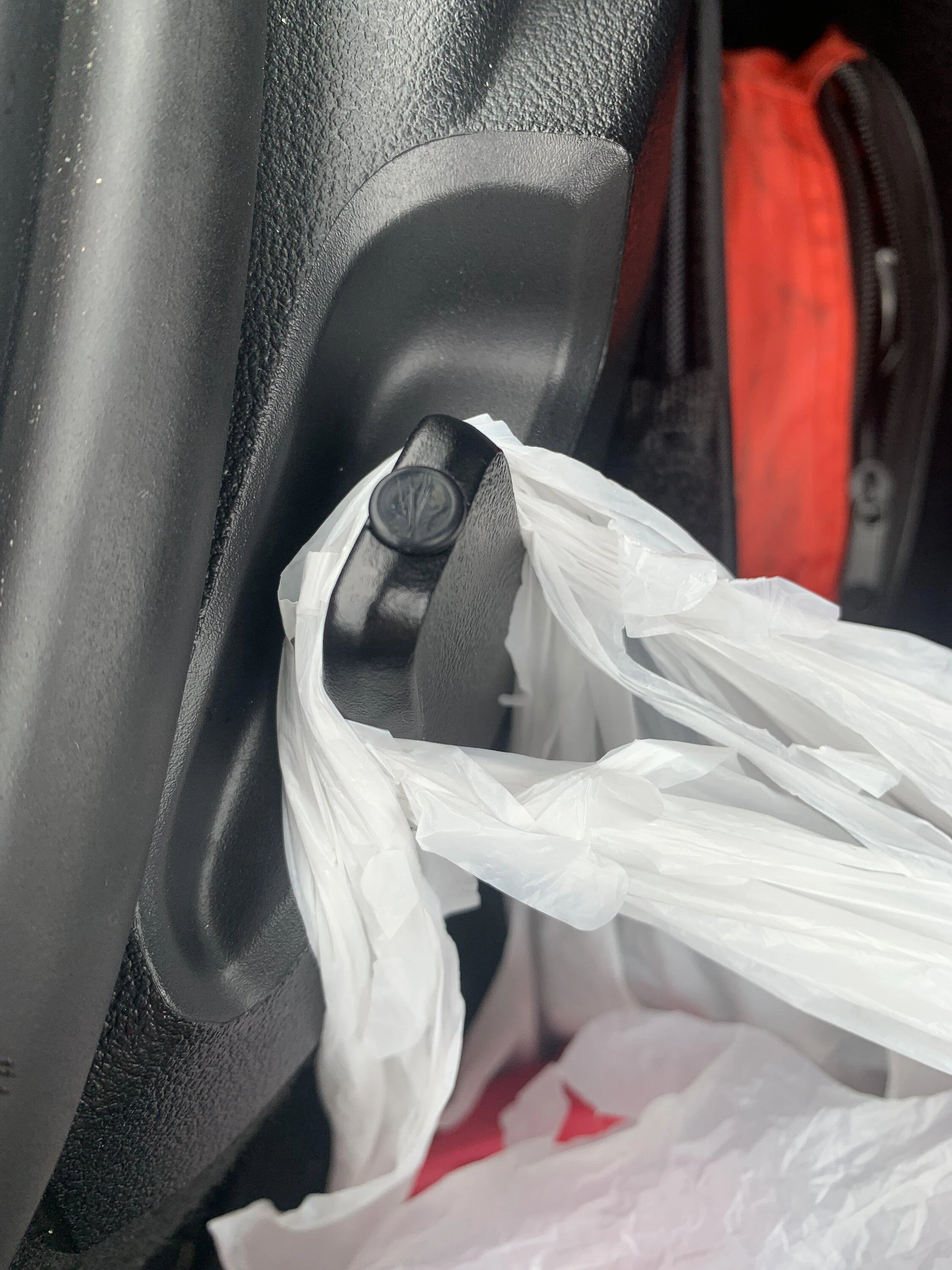

Does anyone know the part number for the luggage cover bumper? One of mine disappeared.

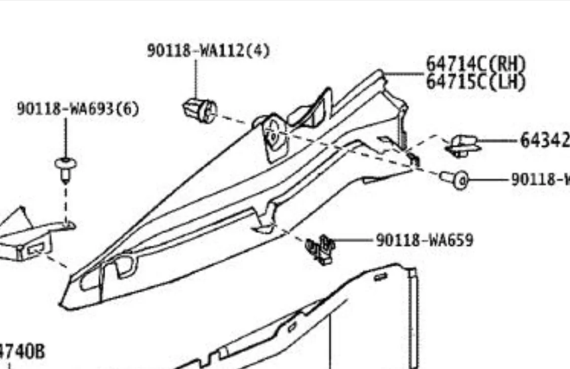

Unfortunately looks as though it is part of the entire upper trim piece and not a part on its own.

That pic shows the opposite of what you stated. Each of those numbers are individual part numbers.

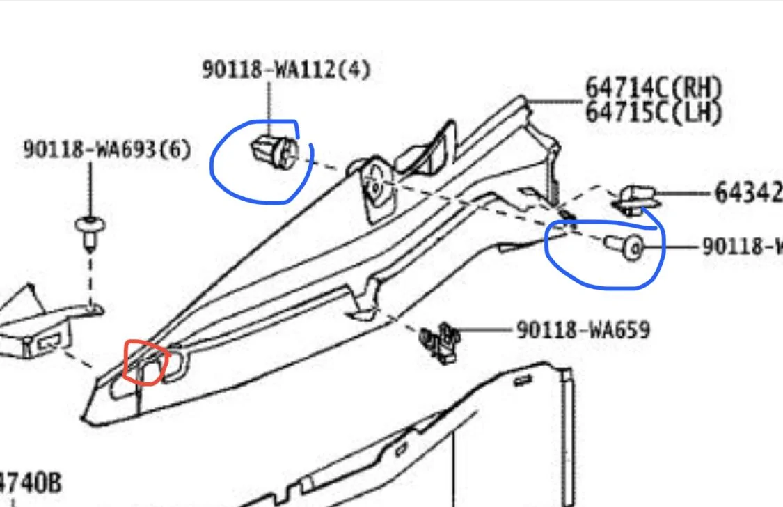

He’s looking for the small rubber piece that goes where I have circled in red.
There is no part listed for that individually. I believe the #9 and #10 you referenced (circled in blue) are one of the torx screws for that piece.

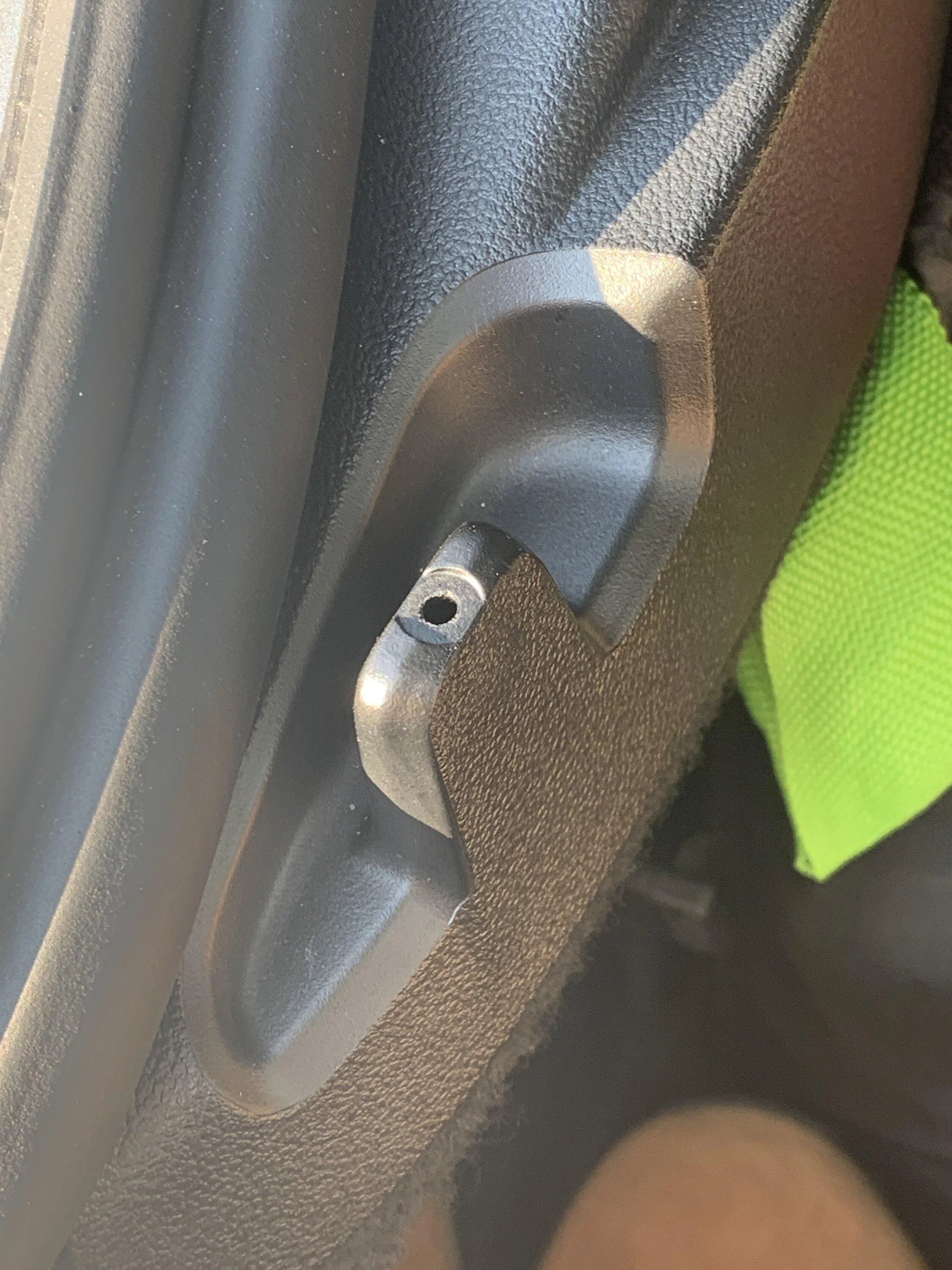

Mine is missing on the right side, and it's probably been missing for the 15 months I've owned the car, but I noticed only today. :(

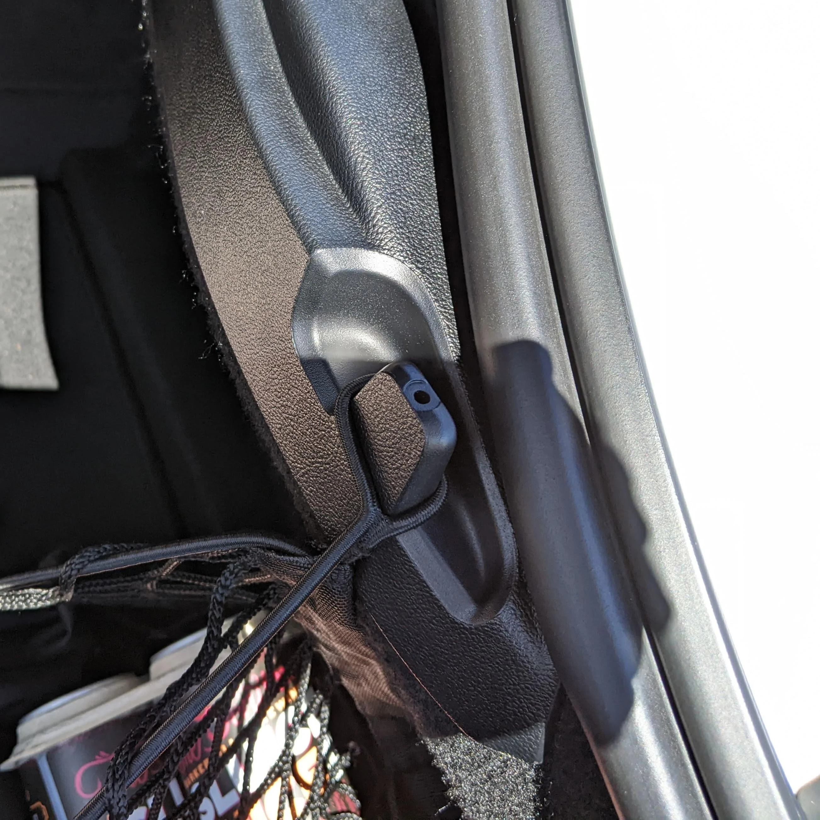

Since Toyota doesn't sell the part, has anybody found an alternative?

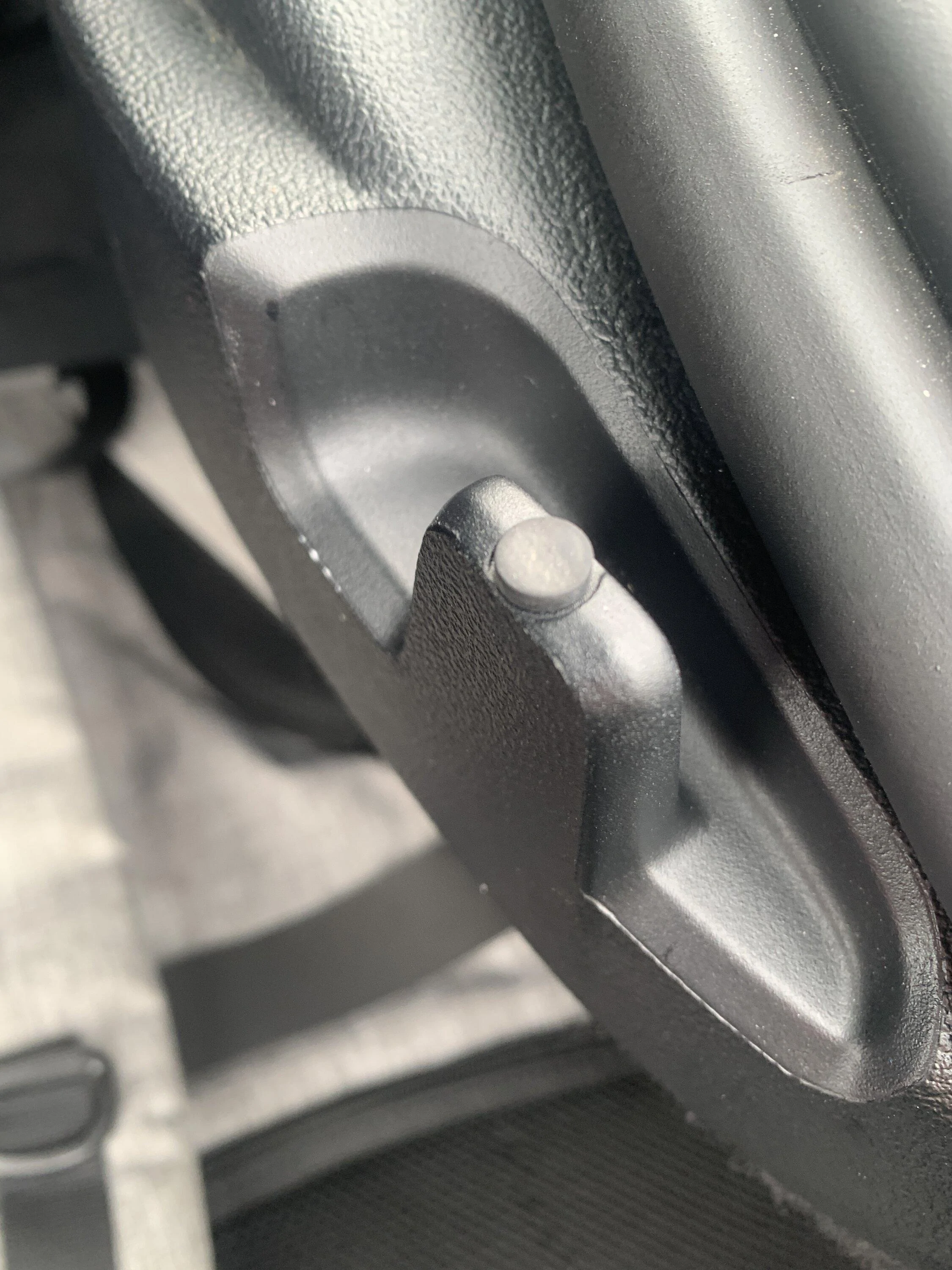

I found a replacement. It's Heyco G2003.
They're difficult to buy in quantities less than 1000. I called the company and asked if I could have a sample.
