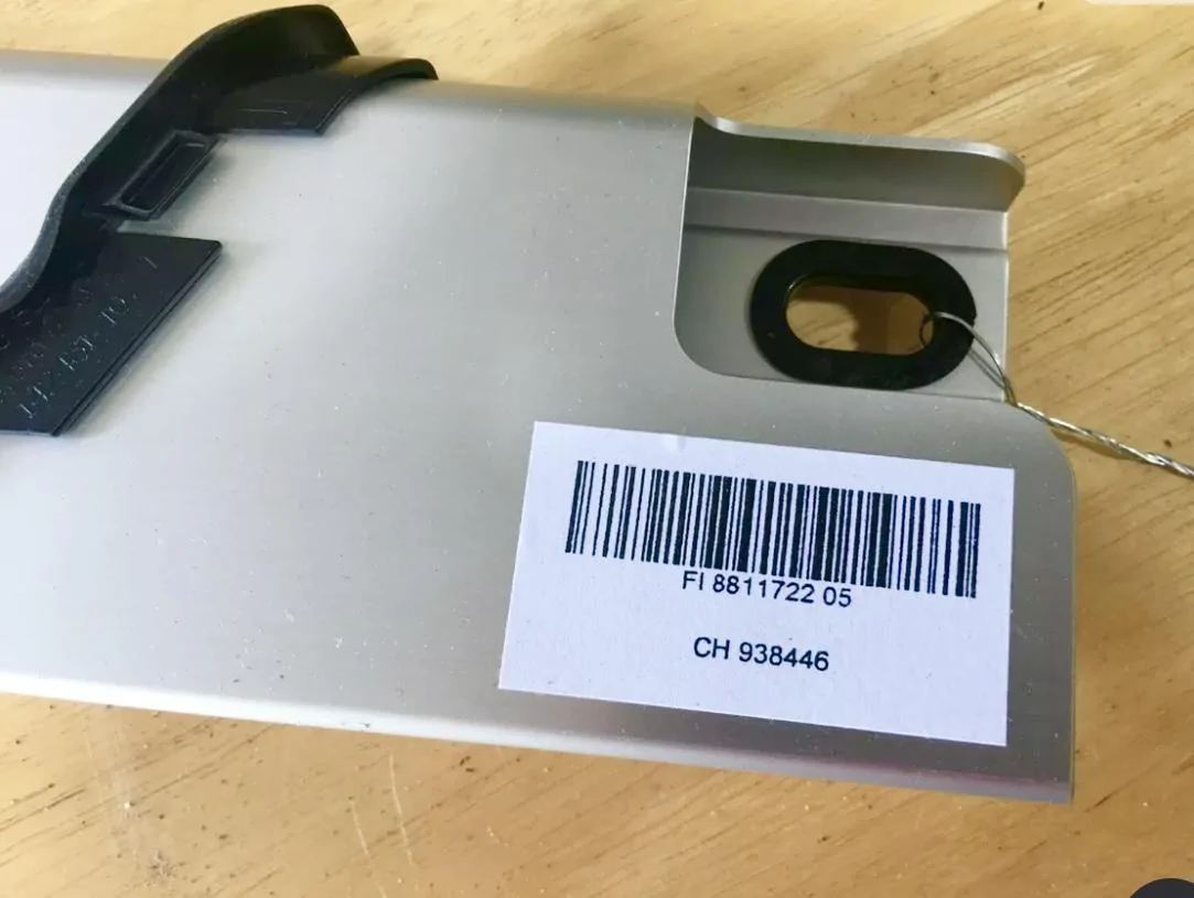

So the silver trunk brace right behind the rear seats us making a rattling/clicking noise. When I hold the brace it goes away. It also goes away if I position my seat just right but that does not seem to be a reliable solution. If you have solved this annoying issue, can you share what you did? I cannot find any good videos/instructions for how to access the brace to tighten/adjust it. Here is a photo. Thanks!

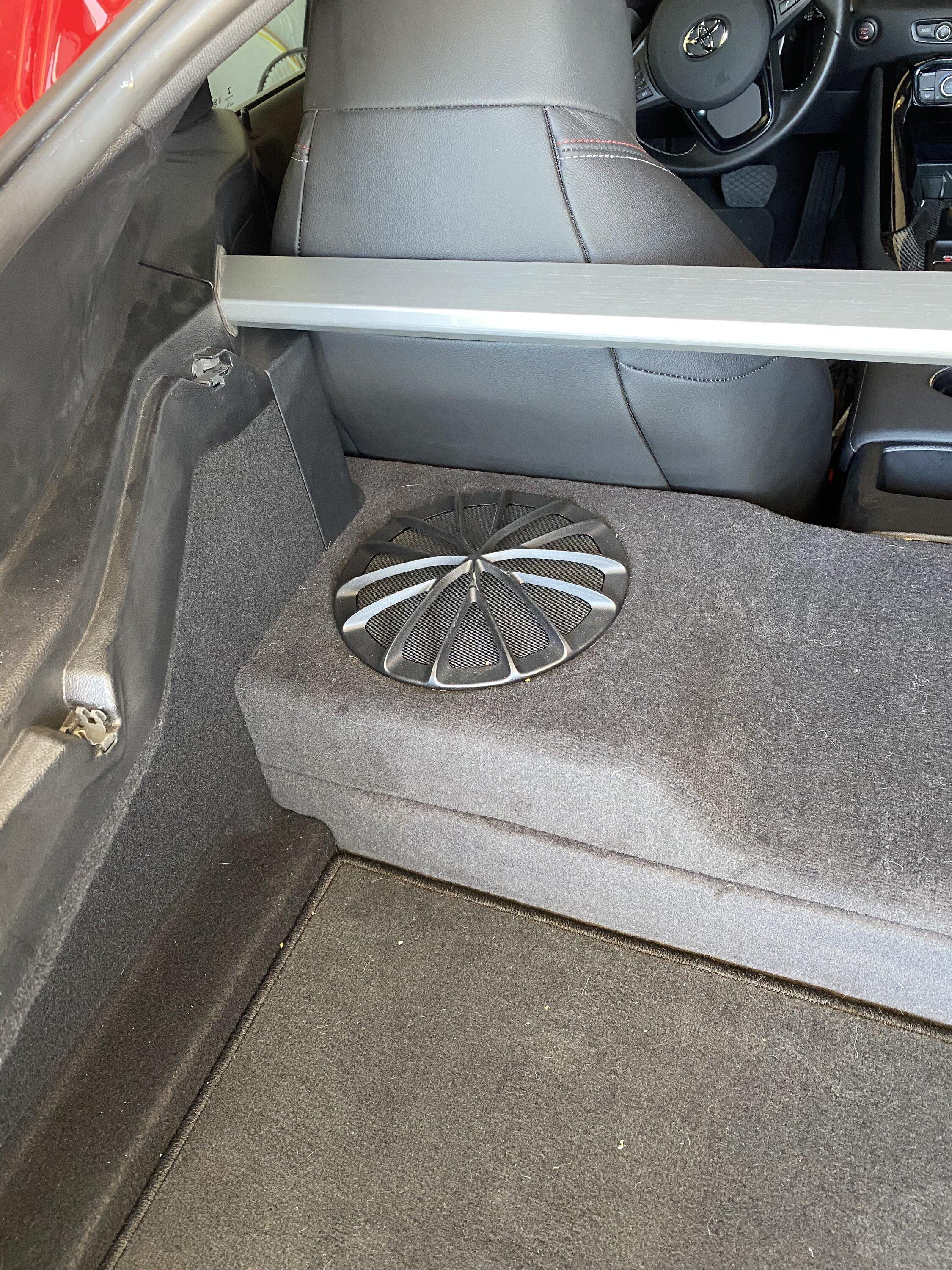

The brace will move around by design. This causes creaking and clicking sounds when you go over uneven surfaces.
Some people have removed the trim pieces around the brace to help reduce unwanted sound.

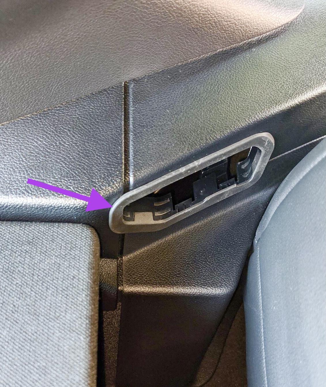

I was able to eliminate a buzzy vibration by using some Gorilla tape on the black plastic around the inside of the hole that you can see in @Loco38SUP picture. It’s very loose and rattly, for lack of a better term. You can tighten the bolt by just removing the trim around the back pillar, but if you going as far as to remove the bar itself for any reason I would secure that little piece.
