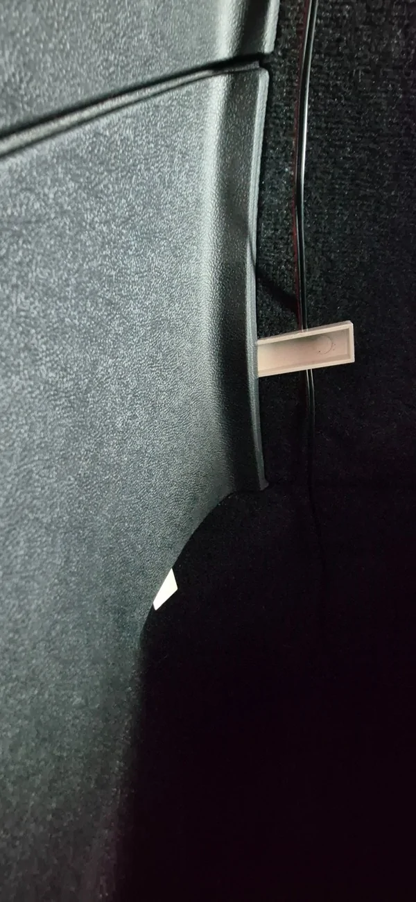

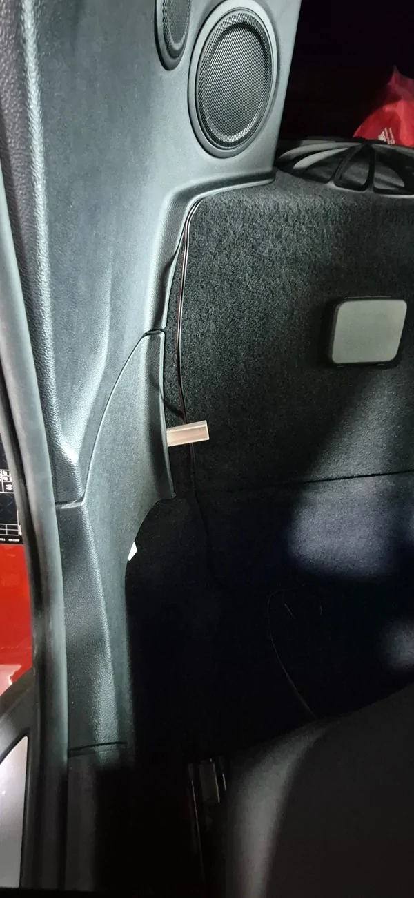

I have had successfully fingers crossed sorted the annoying 😑 rattle it was the plastic trim behind drivers seat RHD model

Thanks for the follow up, how exactly did you fix it? Is that just something you wedged in there so it didn't vibrate? Can't tell in the photo....

They are plastic wedges i just pushed them in.
I still have a small resinance rattle but I recon I'm on the right track.
I can live with it now 👍

Look like tiling wedges to me. Available at any hardware store.
