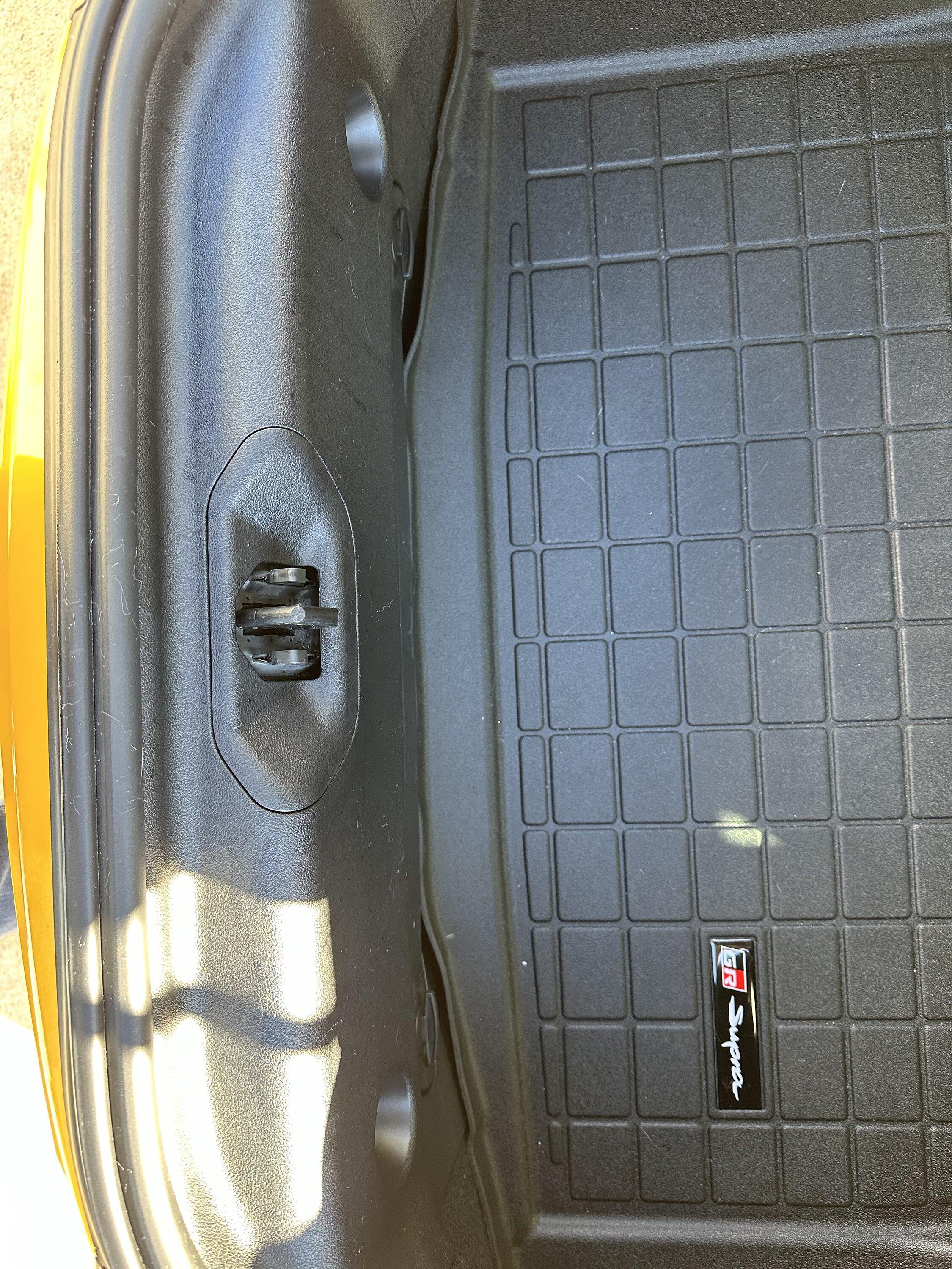

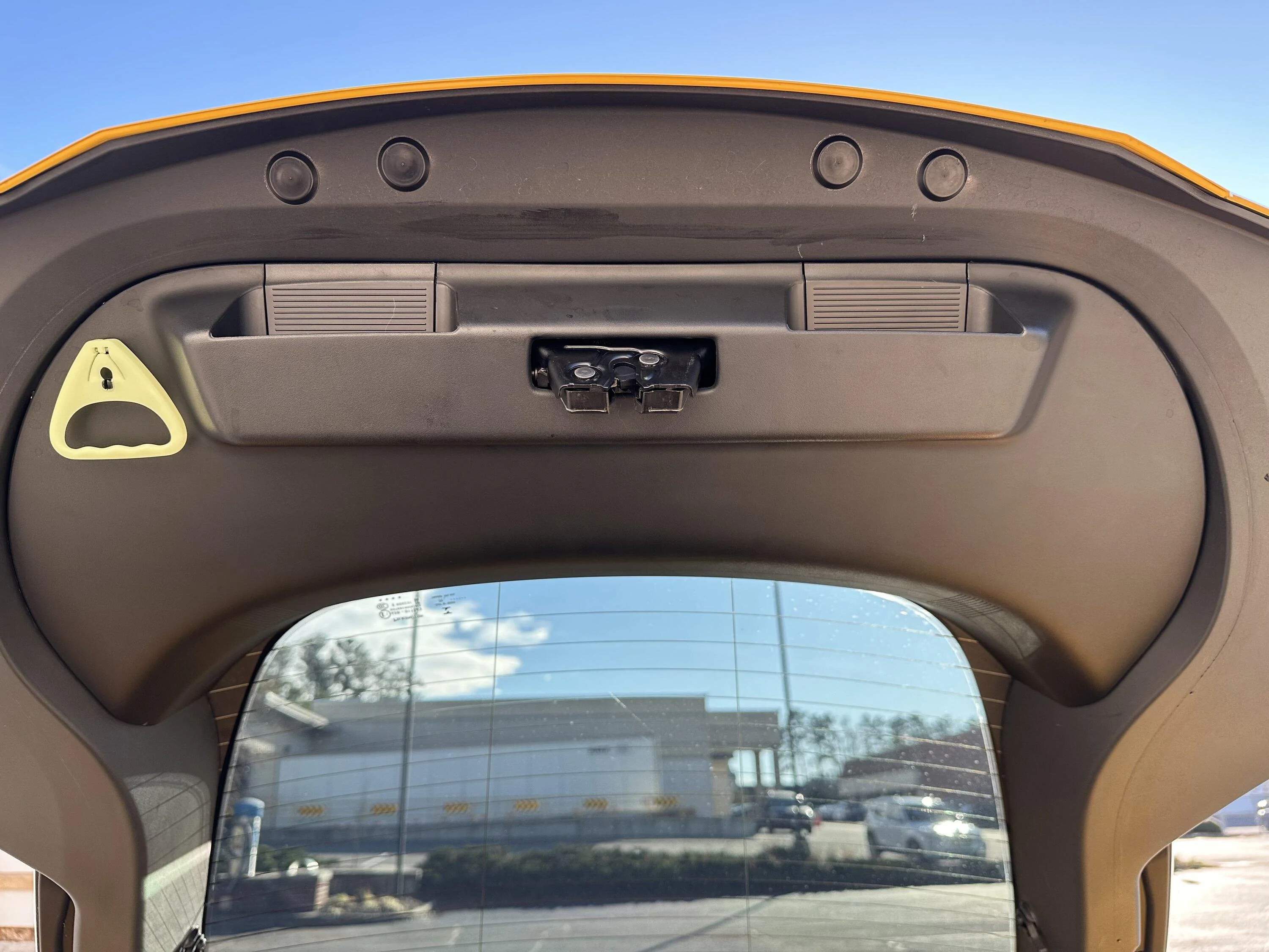

I had the exact same issue, I did a lot of work to get it to stop. I’ll take pics tomorrow to help explain what I did to stop it.

So these are the two panels you need to remove. You need to add Dyna mat to the metal on the bottom part and around where the metal clips snap in. On the top part you need to take all the little pink plastic clips and add electrical tape around where they slide into the plastic to prevent them from moving around loosely.

I posted some pictures of the areas that need addressed but I am too scared to pull it back apart to show exactly what I did because im scared it will come back ?
