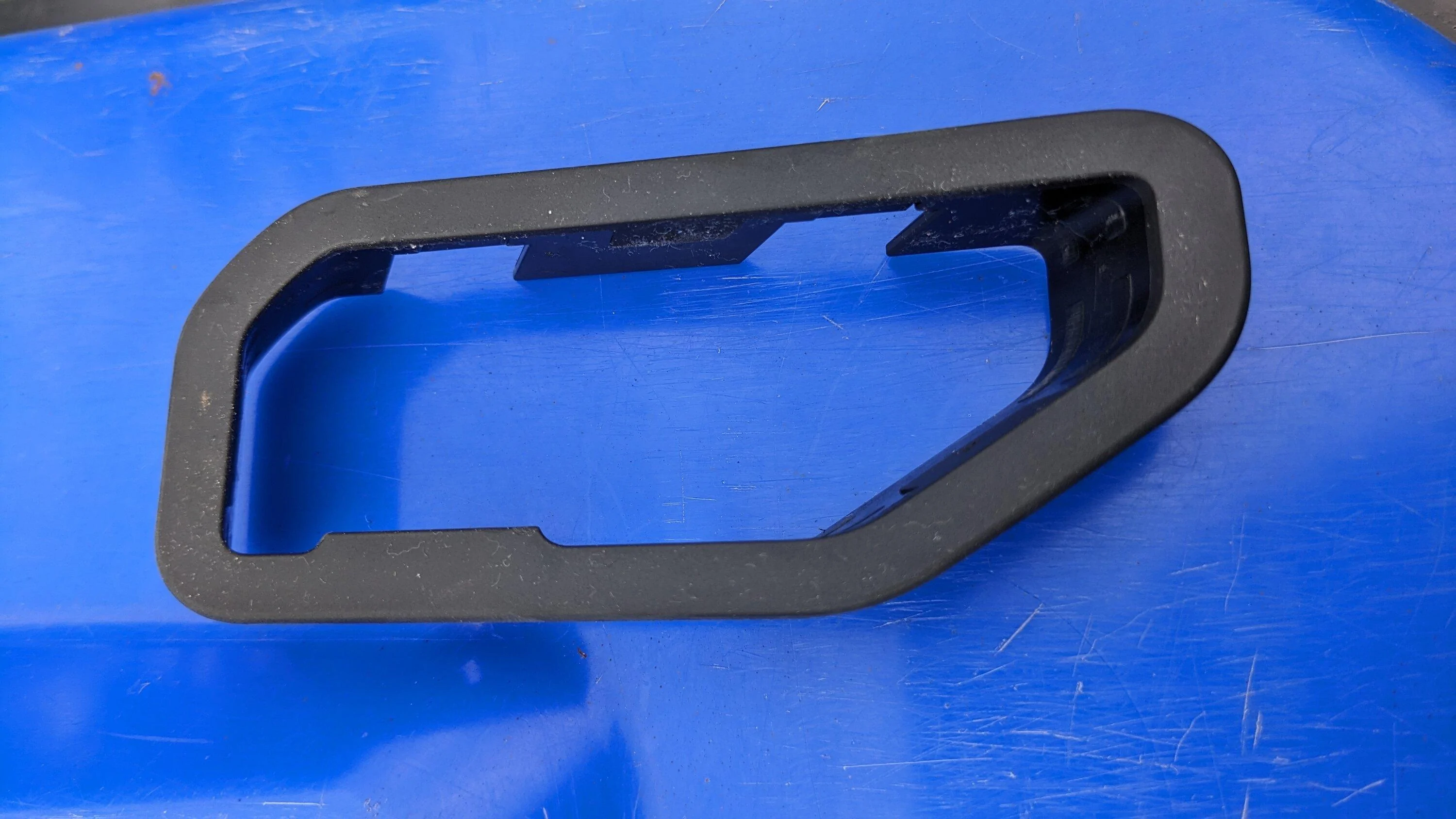

Out of interest, did you refit these? Read a thread somewhere that someone removed them and helped with noise. Also did you put any felt tape on the bracket the brace attaches to?
Will report back if the foam helps.

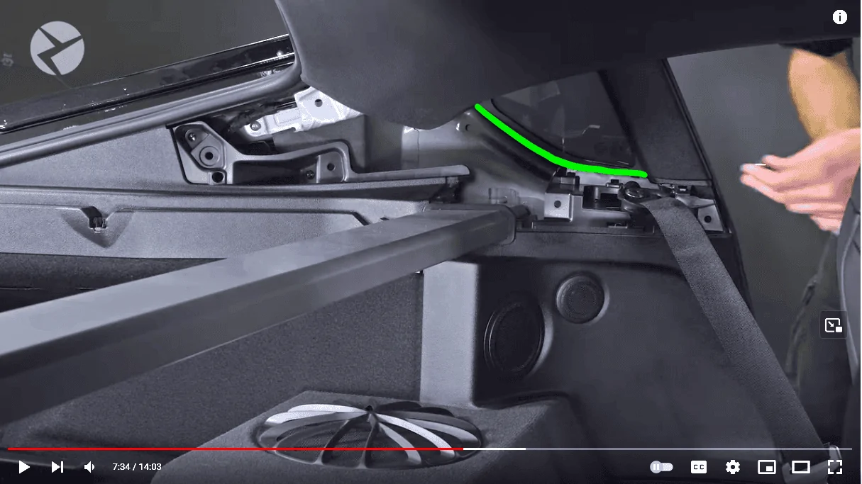

Also put some tape in this location as advised in another thread.
Yup. Between this and the Cusco trunk brace, I got rid of most of the rattles and creaks back there.
Yep, I put those back on. Once the foam is in there, not a single sound from them. I didn't put any felt on, either. I think the wrap and foam were good. I could be wrong though. I definitely don't hear the rattle anymore.
