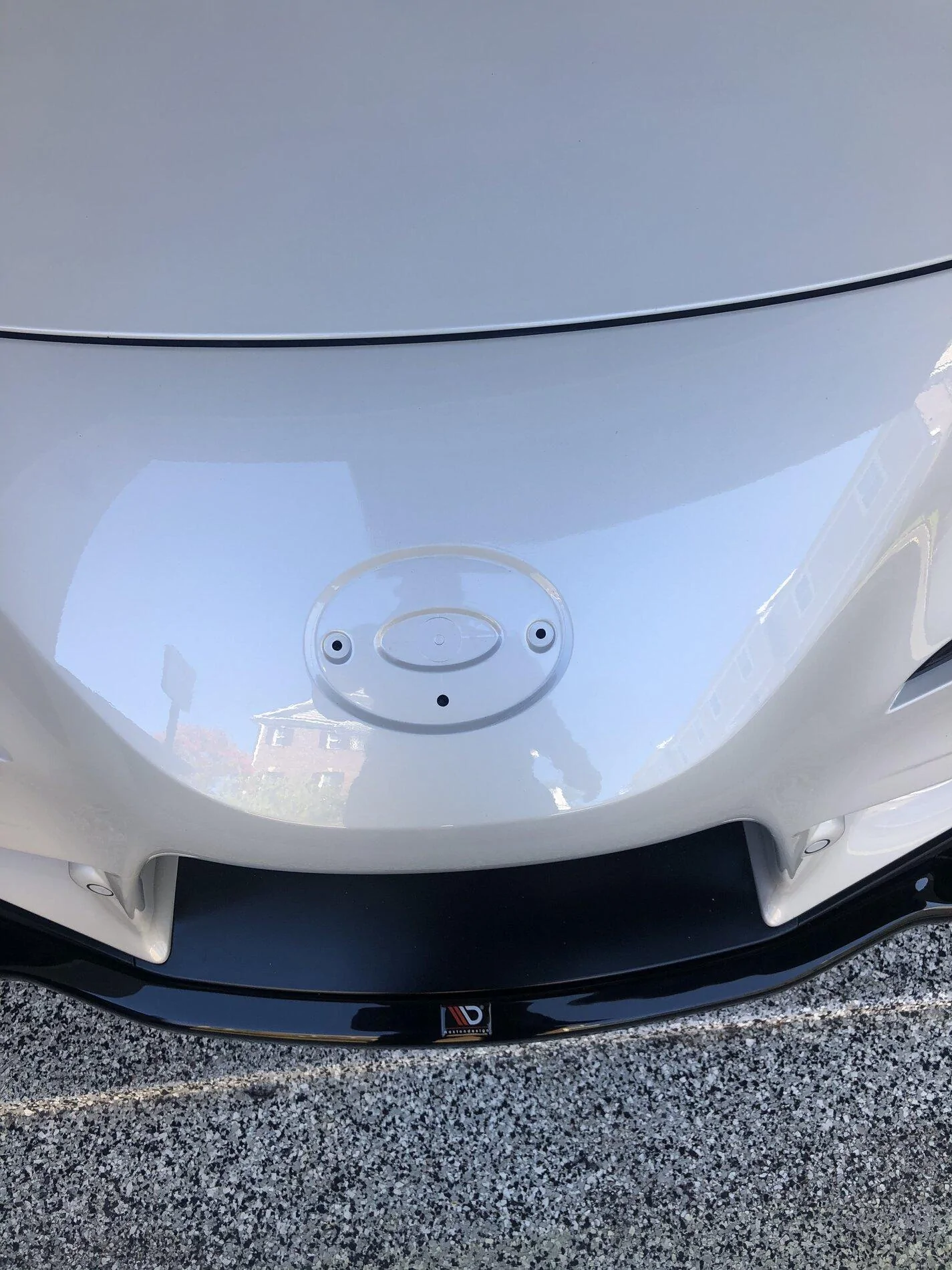

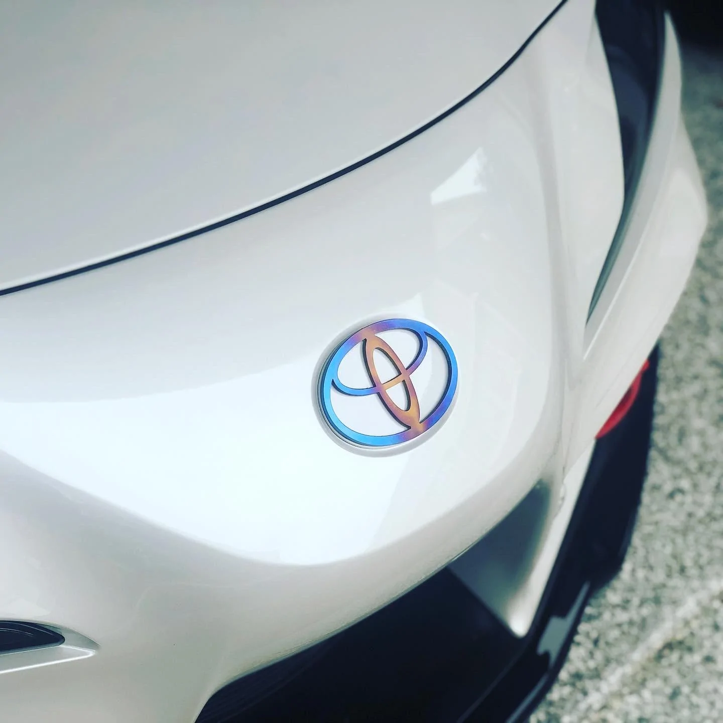

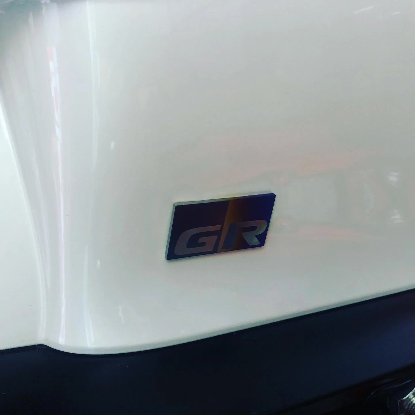

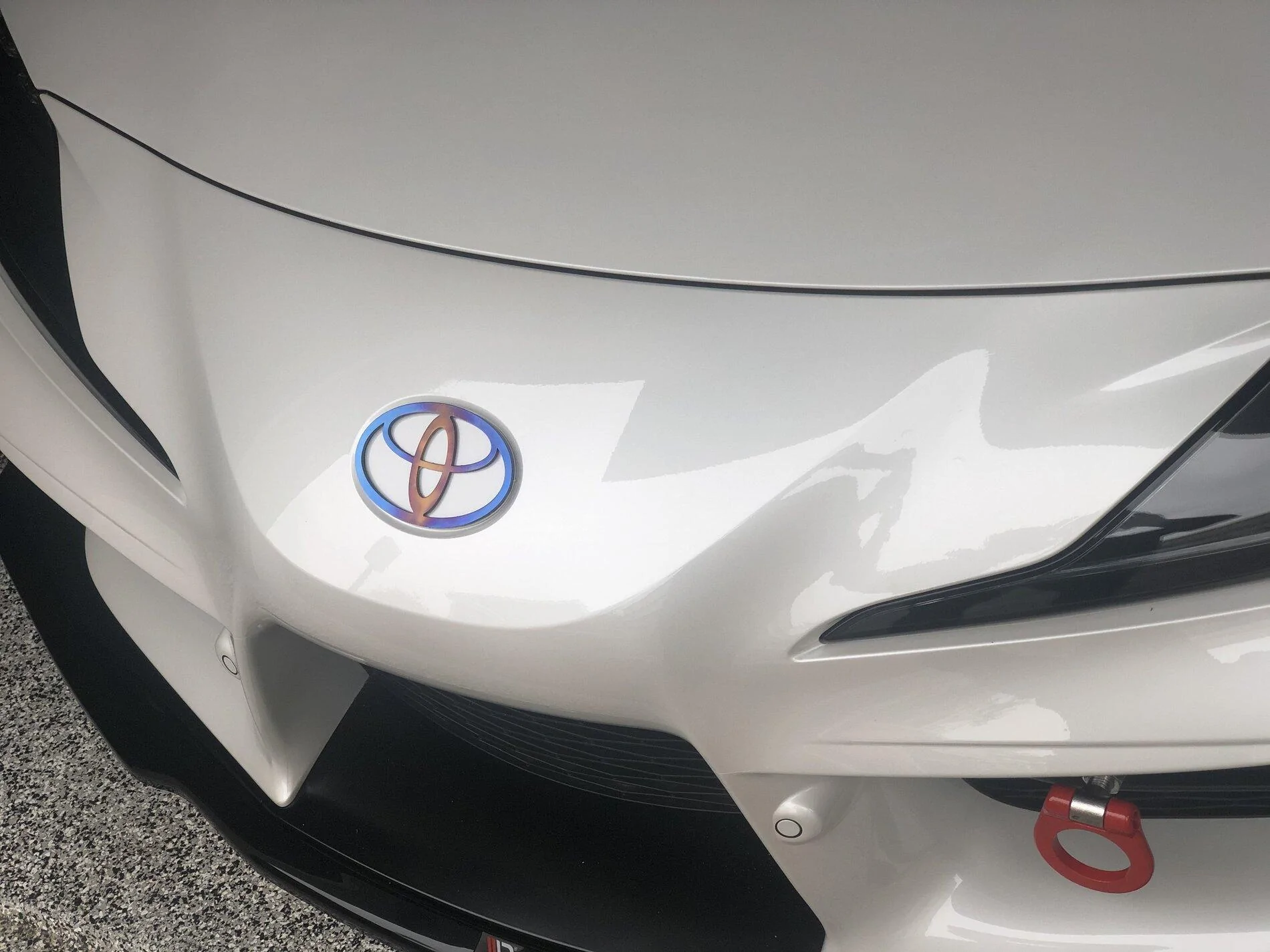

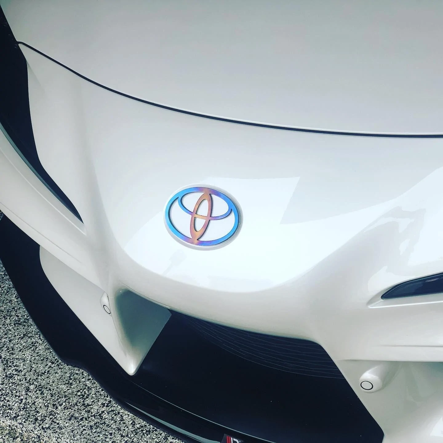

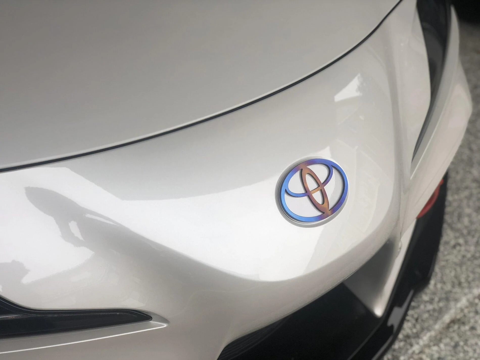

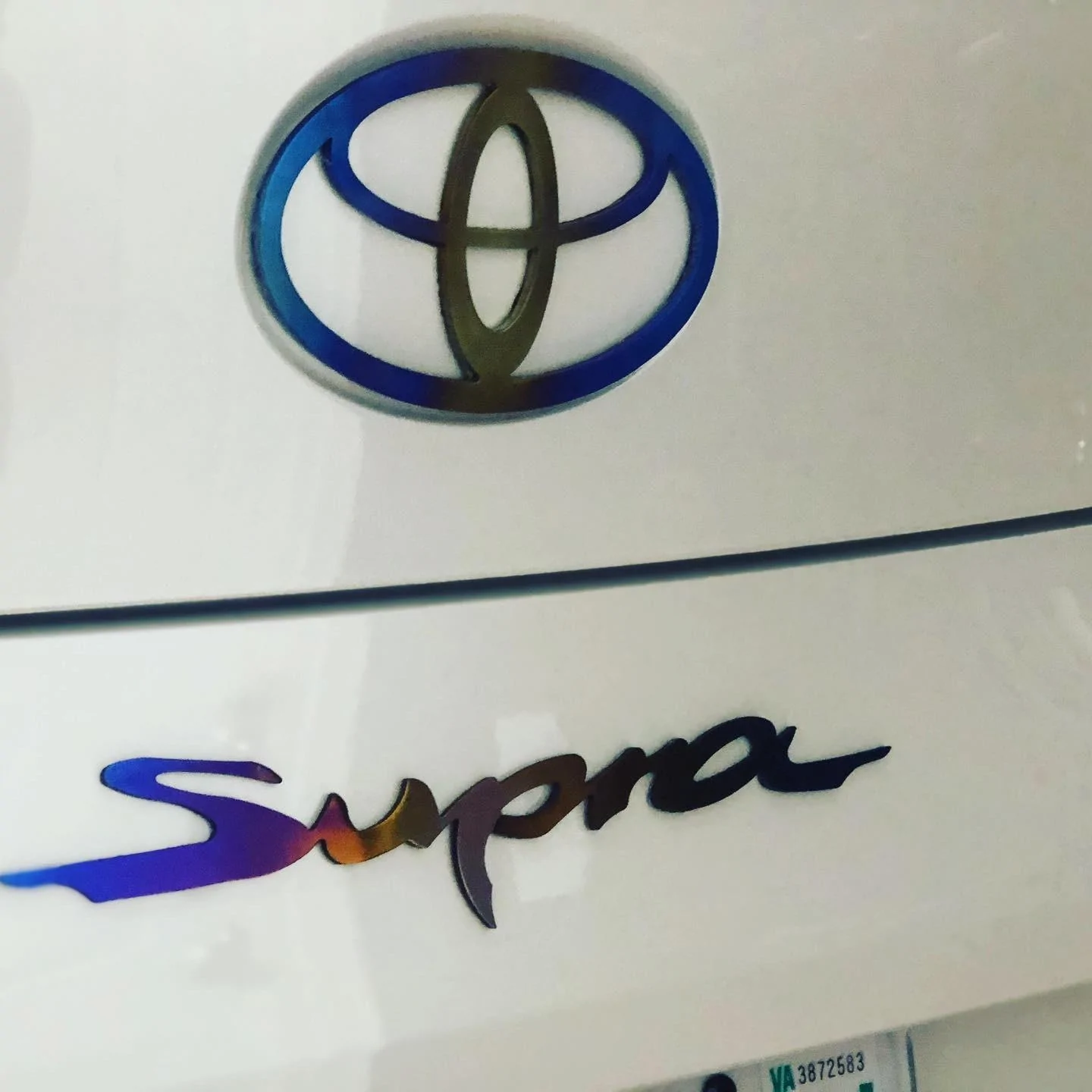

Added some burnt titanium emblems for the Supra. They are from www.titanium-works.com. Definitely not cheap but I really like the looks on black or white cars. Rear Toyota, “Supra”, and GR on the rear are really easy just heat and remove the old ones. For the Toyota rear emblem there 2 small alignment pins that will be covered when the ti emblem goes on. The rear emblem is on a bit of a curvature but using 3m tape makes up for it and fits well. For the front emblem you will need some body work to get it to fit. The front emblem placement surface is flatter so the ti emblem sits more flush but there are 3 alignment pins that are kinda stuck in the bumper so be careful removing it. In addition once it’s off there are indentations that can’t and won’t be covered with the ti emblem so you need body filler and paint OR what I did was separate the plastic backing from the original emblem and get it painted and put the ti emblem on top of it. So the bumper itself is unmolested.

Silly question, did front emblems come off without taking bumper off?
yes it did come off without removing the front bumper, it does take some coaxing but you can get it off without removing the front bumper, in hindsight the front bumper comes off easily so for the sake of maintaining the integrity of the backing plate that i needed to save without bending the tabs as it creates a less uniform surface that will need more filler to make smooth i would take off the front bumper.
