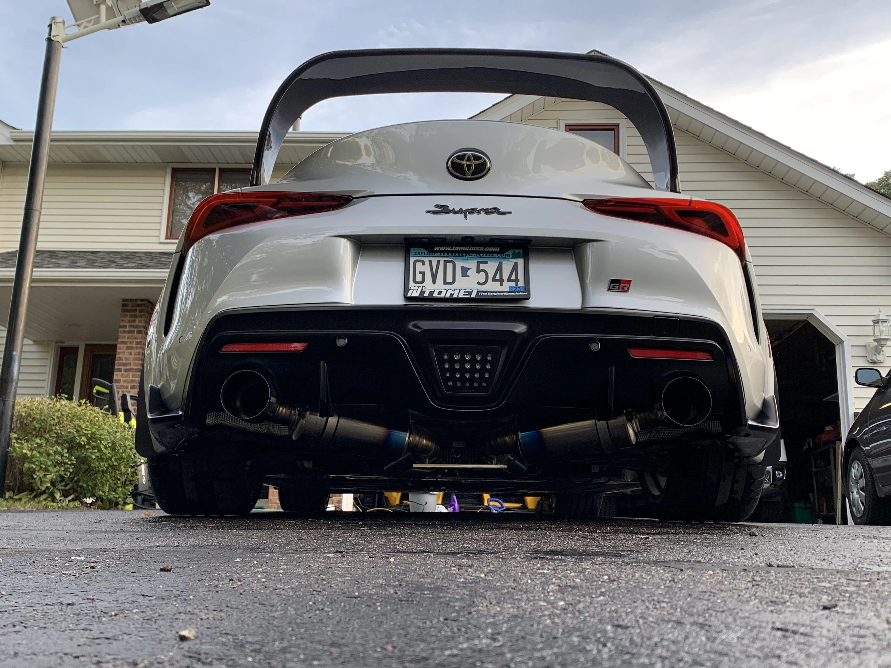

Two of my guys are running the Duel Tomei Exhaust, however both are having the same issue. The issue we are having are the passenger “tail pipe”. The Yellow one the passenger pipe is rubbing against the diffuser and I’m afraid it might burn the plastic. The Sliver one did had the same issue, however we were able to force out the pipe outward to line up the middle part of the tail pipe. It worked, but the muffler tips aren’t lined up. The driver side is sticking out more than the passenger side. I apologize if I couldn’t explain it well, but if anyone out there that has a duel Tomei how did you guys fixed the problem.? Thanks,

I had similar issues as well. Which is why I put the stock one back on for now until a different system i am interested in becomes available. I had to have someone fabricate and extend the little narrow plate that connects to the two mufflers on the bottom to help correct the issue a little.There are definitely some quality issues with these in my opinion. I would not recommend these things. Although they do sound great. Good luck.
we tried a longer bracket on the bottom that holds both the pipe and it did made a little different. Also a-little better to. This may be the best way to solve it, but I wanted to know if anyone out there did something different ?
