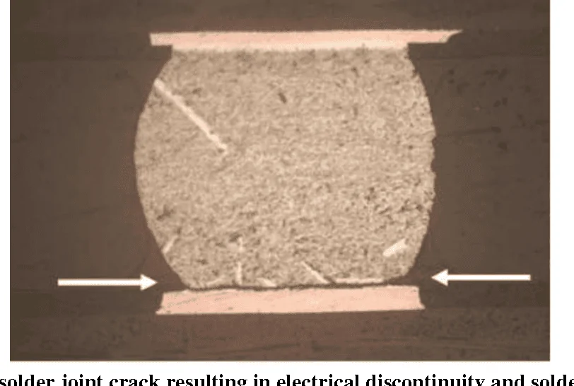

To me this kinda sounds like a bad solder joint somewhere either in the radio or in the screen. What's probably happening is when it's cold out the solder is shrinking and not completing the connection and when it warms up it expands and things start working again. Something like this:
