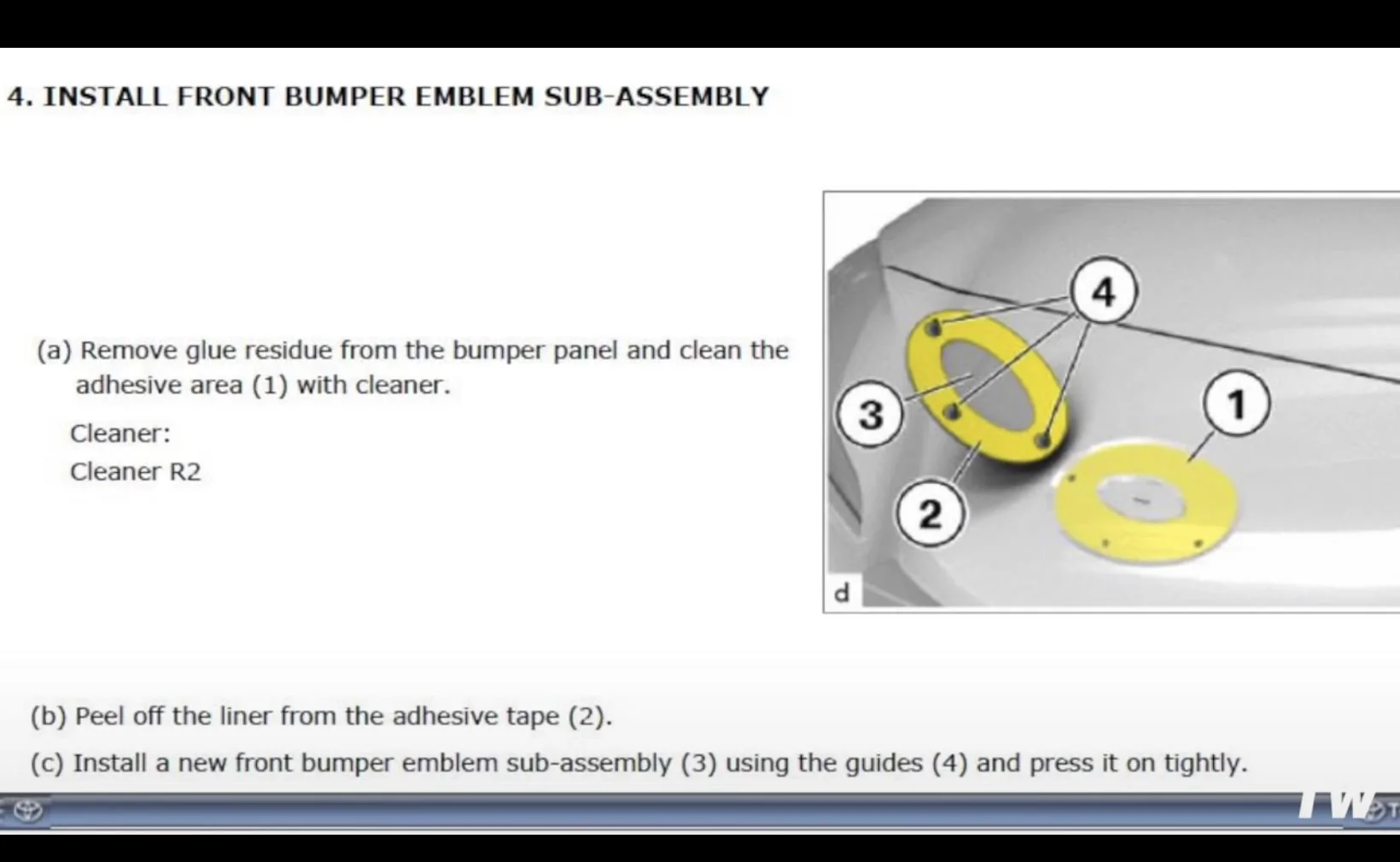

I have quick one for those of you who have removed their OEM front bumper badge. Can you please let me know if it's flat on the underside of the domed logo?
I'm trying to make my own solution to the chrome badge but don't want to rip it off only to find out that my assumption was wrong...
A picture of the underside of the badge would be highly appreciated :)

hi, that does't really answer my question, I tried looking at all three videos of the replacement badge but I can't make it out if the OEM is flat or curved on the underside.
I know the panda badges are flat but I would like to know what the OEM looks like

Don't mean to thread jack, but what method did you guys use to remove the stock badging..? Preferably a method that DOESN'T fuck up the front bumper or trunk lol
8,472
14,122
Fishing line, heat gun, WD40, trim tool. microfiber towel.
Eventually I got it all off.
starman
May 3, 2021
219
320
North Carolina
Supra 3.0P
^^ This and take your time (it took me a 45 minutes to get the front off, my fingers were hurting a bit). It's still quite a pain to remove because of the pins holding it in place into the bumper and the extremely sticky tape used; but the method above won't mess up the bumpers.
