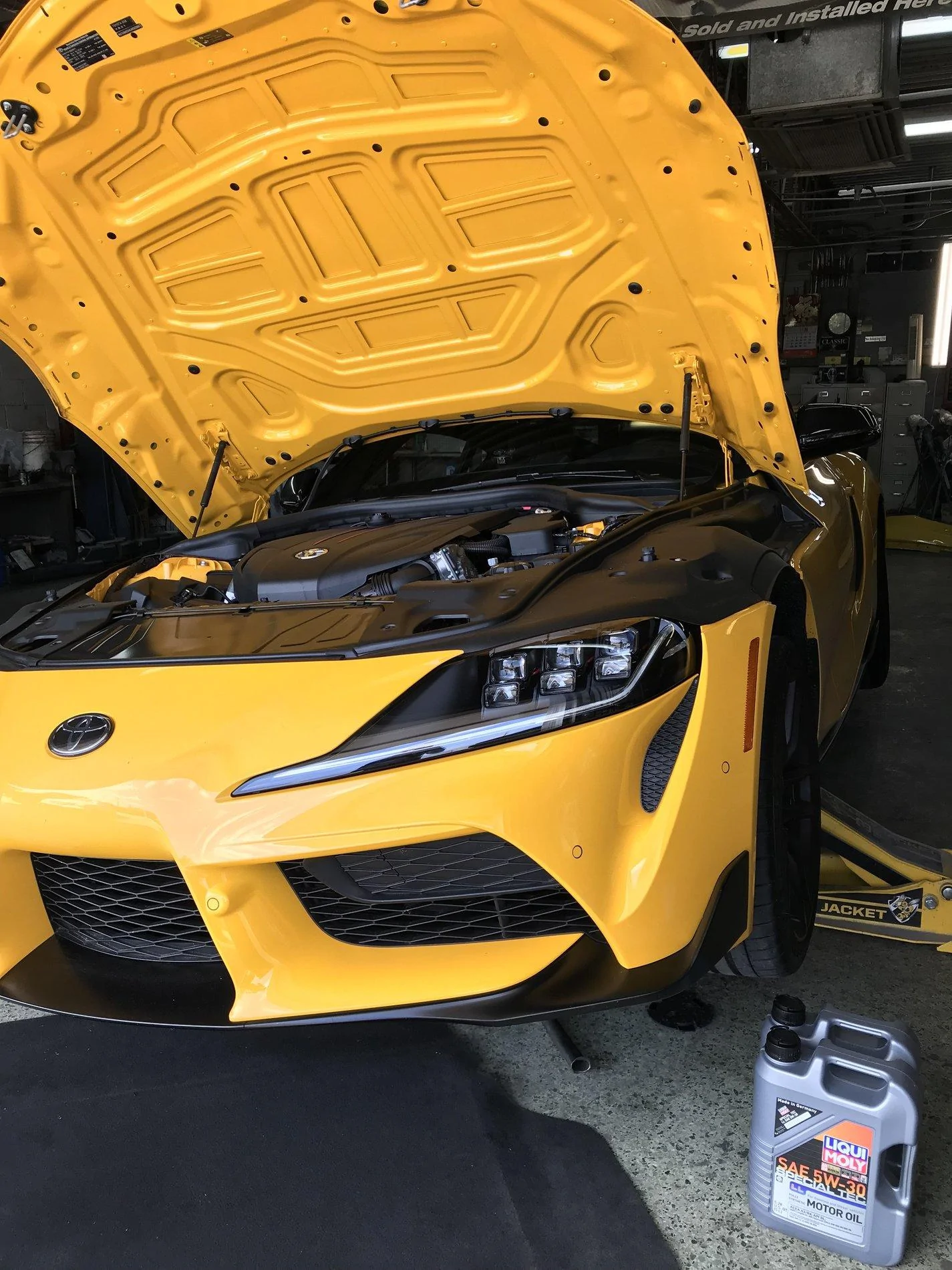

500 miles is a bit earlier.. Just did the first oil change @1500 miles. Oil still looked very clean, clear and contamination-free. Manual calls for 0w20 but I switched it over to 5w30Liquid moly special tech.. oil capacity 6.5 liters
I also used Liqui Molly 5w30 @1200 miles. Any difference between special tech vs top tech?
