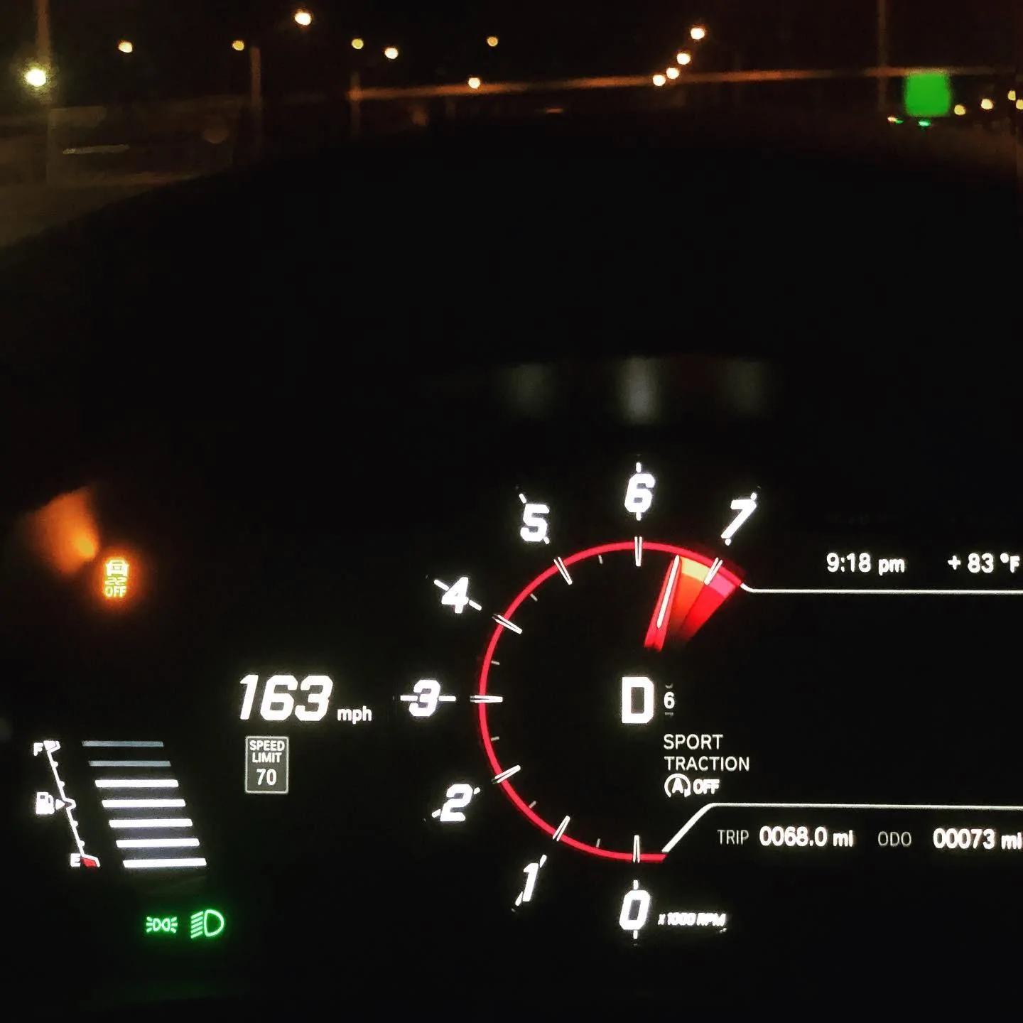

Can't really expect Toyota to know the specs on an engine that they didn't build.
:thumbsup:
Looks like it still has 2 gears to go through if it had no governor. I was about to say my Ford Focus ST can do 165mph, no way this car can’t beat that.
Yeah. I wonder where the tach needle is going to go once they get rid of all of that crap, start making some power and rev higher. :rofl:

So wait, 163 mph top speed max RPM?
There are 2 gears left ;)
But the 7th should be the top speed gear after tuning and removing the limiter.

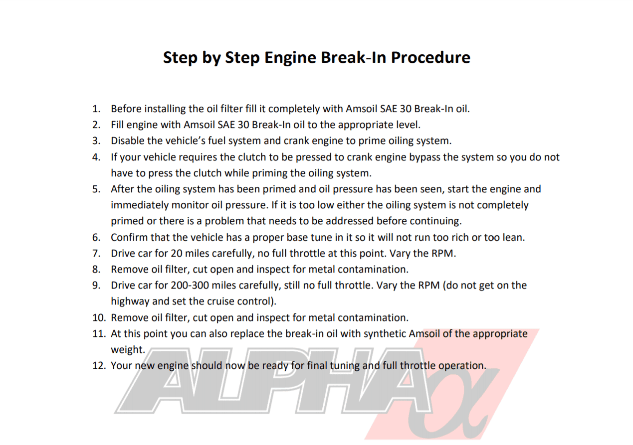

This is AMS's break-in procedure for the VR38 and 4G63T. The VR38 uses a plasma coating as the cylinder liner like the B58. This procedure likely applies to both stock plasma liners and sleeved AMS blocks.
