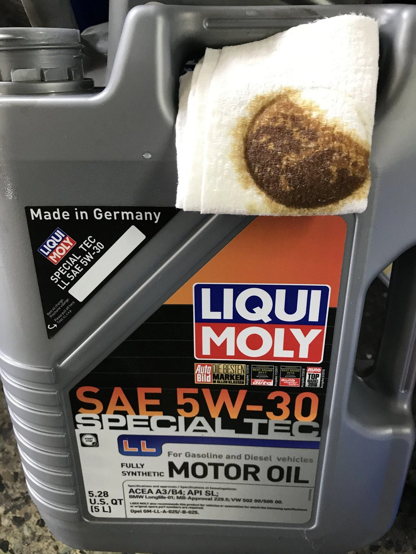

500 miles is a bit earlier.. Just did the first oil change @1500 miles. Oil still looked very clean, clear and contamination-free. Manual calls for 0w20 but I switched it over to 5w30Liquid moly special tech.. oil capacity 6.5 liters

Curious ZuprA90 why you have changed from the oil specification?

BMW calls for 5w30 on their engines. Since this is a BMW B58 engine, I decided to go with what bmw recommends. Toyota loves 0w20, don’t get me wrong 0w-20 is good oil, especially for cold start, turbo engines, fuel economy and maybe better for the environment but most importantly doesn’t protect from engine wear as efficiently as 5w-30. Photo of factory oil quality after 1500 miles.. doesn’t look too bad
