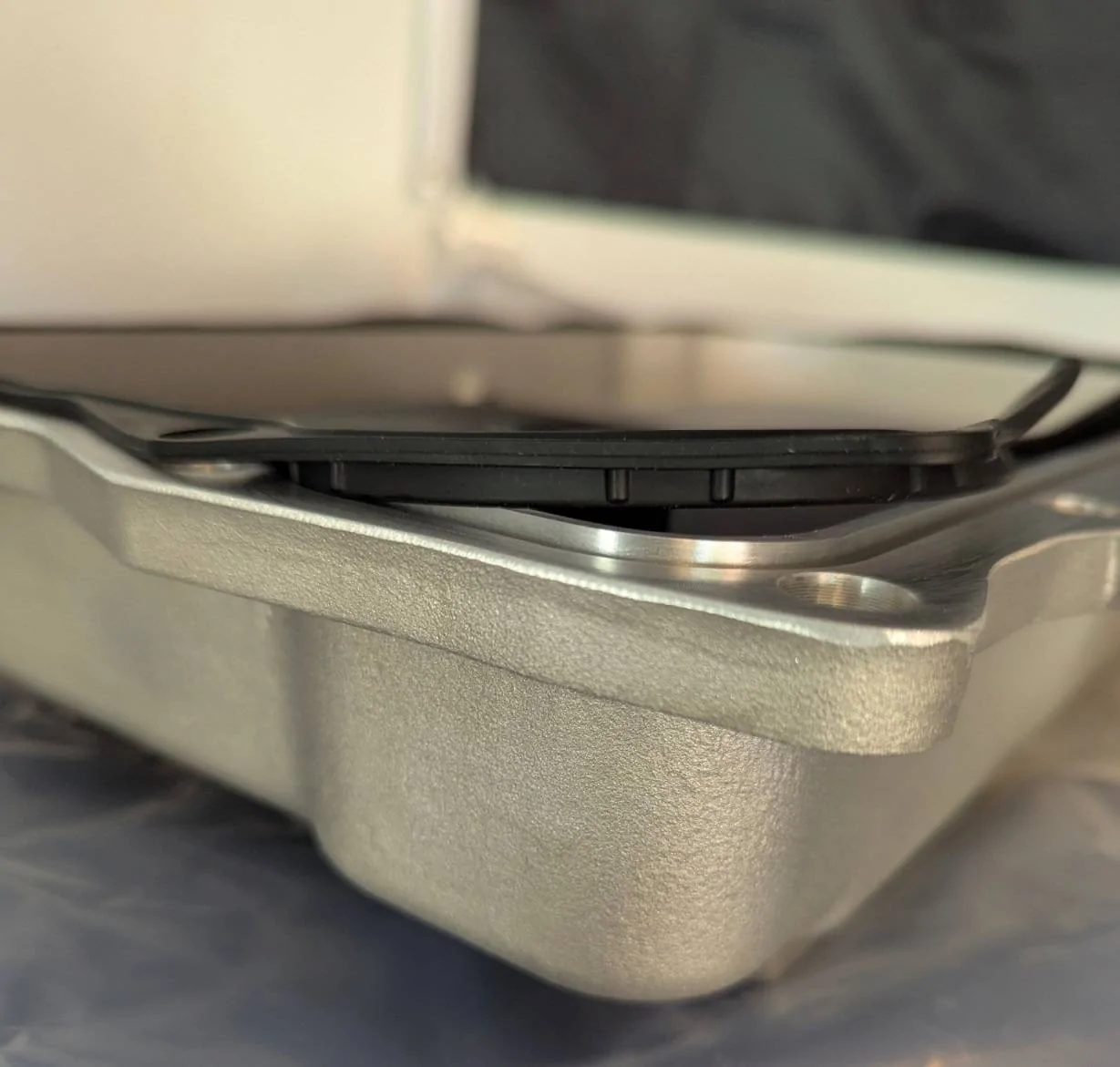

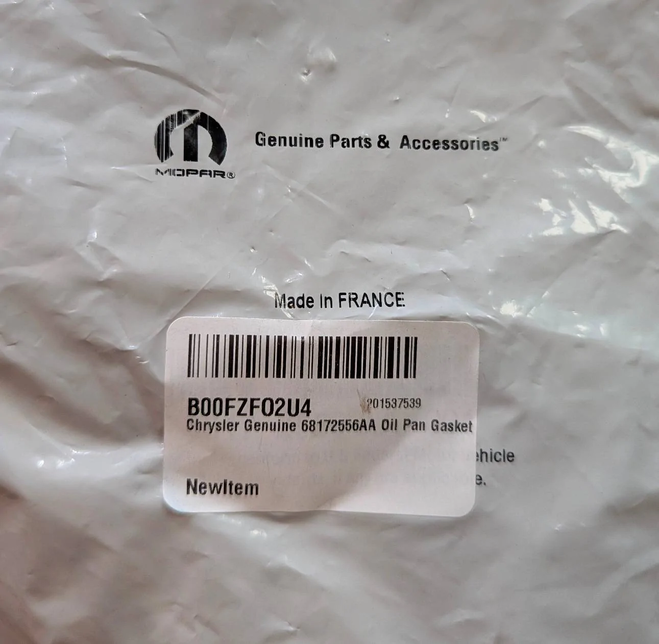

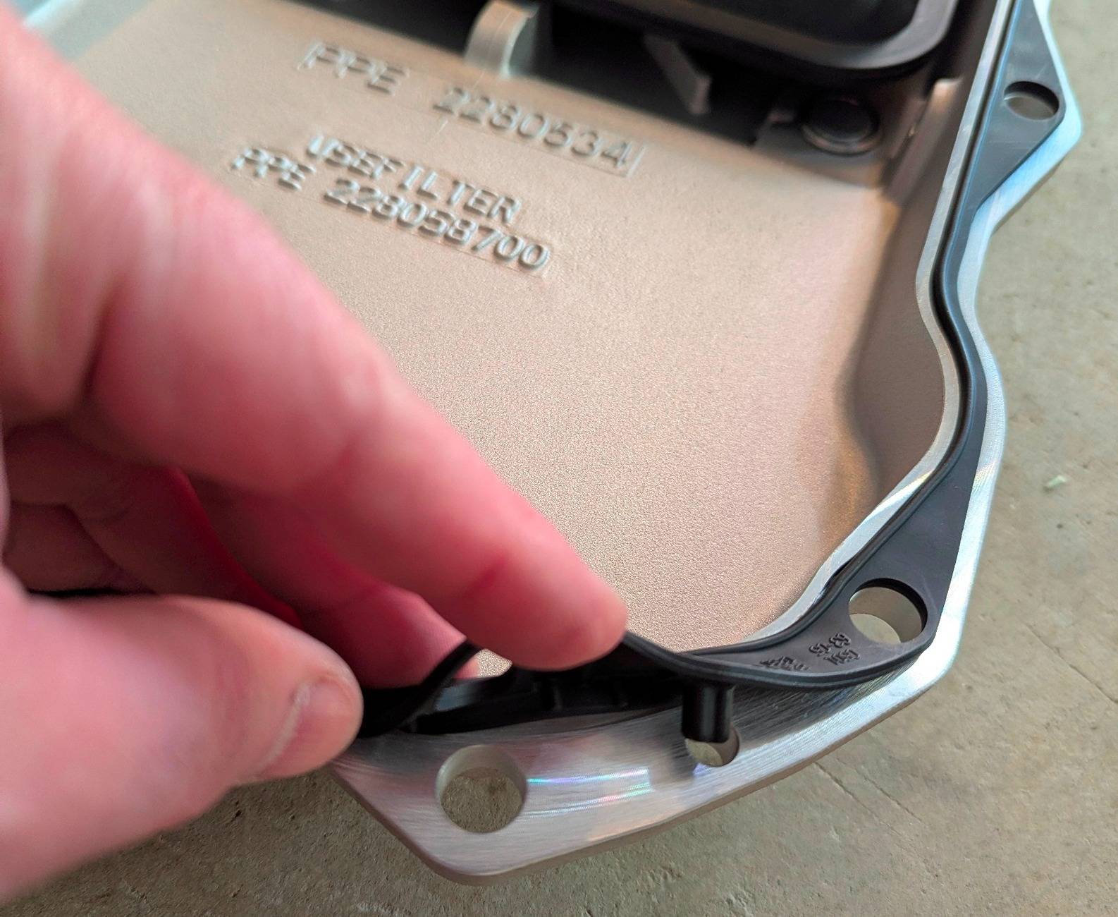

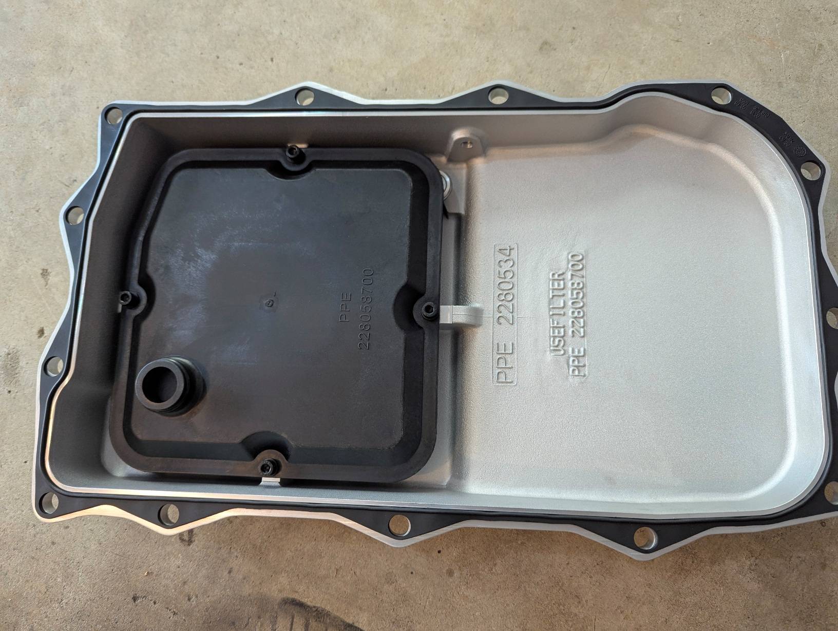

I could never find the part # for the OE Transmission pan gasket. But after reading on PPE website it says that OE gasket works with their pan. So after a little searching and cross reference. I ordered Genuine Chrysler 68172556AA Oil Pan Gasket. Found it on amazon for only $23. Anyway it came in today and is an exact fit. Even has the reinforced edges and locks down into the channel on the PPE pan. Plus there is a directional rubber tab to help with orientation and to secure it in place.
https://www.amazon.com/dp/B00FZFO2U4
If anyone knows the part # for the OE transmission pan, please post it below for future reference in case someone is looking for it. Anyway, here are some pics of the Mopar gasket. Fit like a glove!

FYI to others, the OEM metal pans don't use that gasket, they use a metal gasket.

the raised edge on the ppe pan probably precludes using that oe gasket. might not.
I don't think you can order the metal gaskets alone either. I know they come in the filter kit 24007855263 about $100

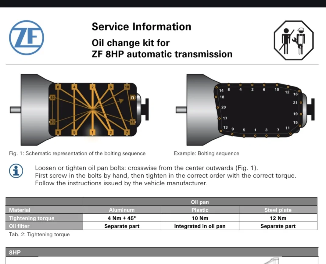

For the metal pans, are you all torqueing the bolts to 4 Nm + 45 degrees or just doing 10 Nm like the plastic pans?

I used the m3 pan and followed m3 torque specs. It was some nm + angle and they felt pretty good. It’s been about a year and no problems

I just followed the tightening pattern and torqued to gudintight. Been fine.
