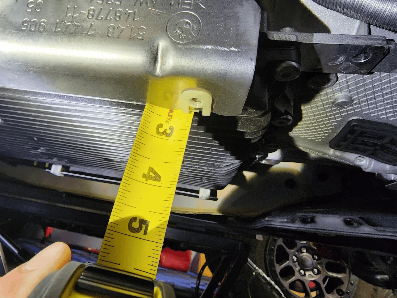

I ended up just measuring it while it was on the car to estimate rough fit. I took a pic.
Now, thats from the joint between the pan and the trans to the attachment rail for the undercladding. I measured the PPE pan at 3 inches in depth. So it'll hang a little over 1/2 inch below the undercladding. We can use the depth measurements for the X pan and M3/4 pan to get a comparison.

Thanks man, this is helpful. Its actually deeper than the PPE pan! If you don't mind, would love to see some pics if you decide to do a cutout to accommodate the pan.
