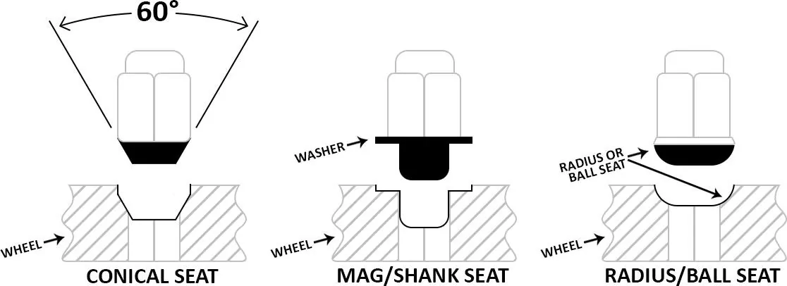

Use the correct wheel bolts for your application
BMW uses conical seat wheels and bolts
If you change to studs, also make sure the lug nuts are conical as well
It is perfectly fine to use tuner style lugs nuts that are conical with studs on the factory wheel
Ok thanks! I did convert to studs and lug nuts, time to do some shopping!

why is it not safe to convert to studs with lug nuts??
User probably thought A90 was mag-seat like most Toyota/Lexus products were. In that case using tuner/conical lugs on a factory mag seat wheel is bad.
A90 Supra stock wheels are conical seat like most/all BMWs so it's not a problem.
Yep. Conical FTW.
