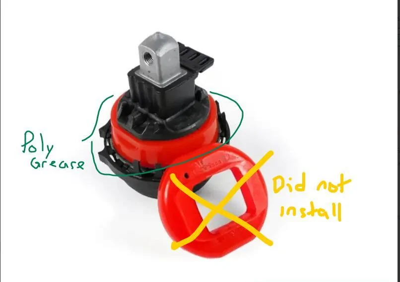

I have Powerflex engine mount insert installed. Performance wise it's good. However it introduced vibrations when the car is idle, around 700rpm. I wonder if Twisted Tuning engine mount would introduce any vibrations when the car is idling? What about other RPM range?
I only installed the lower half of those inserts - I have little to no extra NVH and the engine flex reduced a lot (this essentially replicates what the S58 mounts are). If you installed both the top and bottom halves of those inserts, my suggestion is to remove the top halves and see if that gives you the desired results.
Thanks for the advice! I’ll give it a try. My car is MT so it maybe behaves a little differently from AT in D. I’ll try to remove the top insert and see if there’s any improvements:)
Not a problem! My car is also a manual and while I haven't personally driven an Auto, it seems the AT folks have less drivetrain slop from factory than we do, at least anecdotally.
Here is a picture illustrating how I installed mine.
