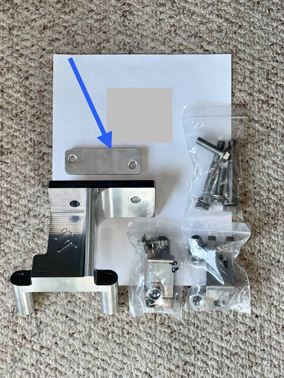

We haven't published an actual installation manual yet, as the install is very straight forward in itself. But below are the torques specs.
TORQUE SPECS:
Rear Diff Brace Bolts (Upper/Lower) - 70ft/lbs, 95nm
Front Diff Mount Braces Bolt (Upper) - 20ft/lbs, 27nm
Front Diff Mount Braces Nut (Lower) - 74ft/lbs, 100nm
also now posted in the first post at the bottom. i'll eventually get around to published the install

FYI - the Rear Diff Brace (Upper Bolts) at 70 ft/lbs seemed way too excessive. I torqued them to 40 ft/lbs and felt the aluminum threads on the sub frame bracket starting to stretch.
-RJM
Thanks you for the info, ill do another test. That's what mine have been at since dev and didn't have any issues. appreciate it

Those look m8 hardware. If so, the prescribed torque range for M8 hardware is about 36-55 ft-lbs. Low end of the range for grade 8.8, high end of the range for zinc-coated 12.9 grade. 40 is just about right if it's m8.

The fasteners he is talking about are M10

Update on torque specs. Thanks for the input @Loco38SUP.
Also, found that there is often crud (dirt, oils and etc) stuck above inside the subframe that can mimic the feel of threads stretching when tightening that plate down due to the crud being compressed.
But 40-45ft/lbs is enough.
TORQUE SPECS:
(Upper) - 43ft/lbs, 58nm
(Lower) - 70ft/lbs, 95nm
