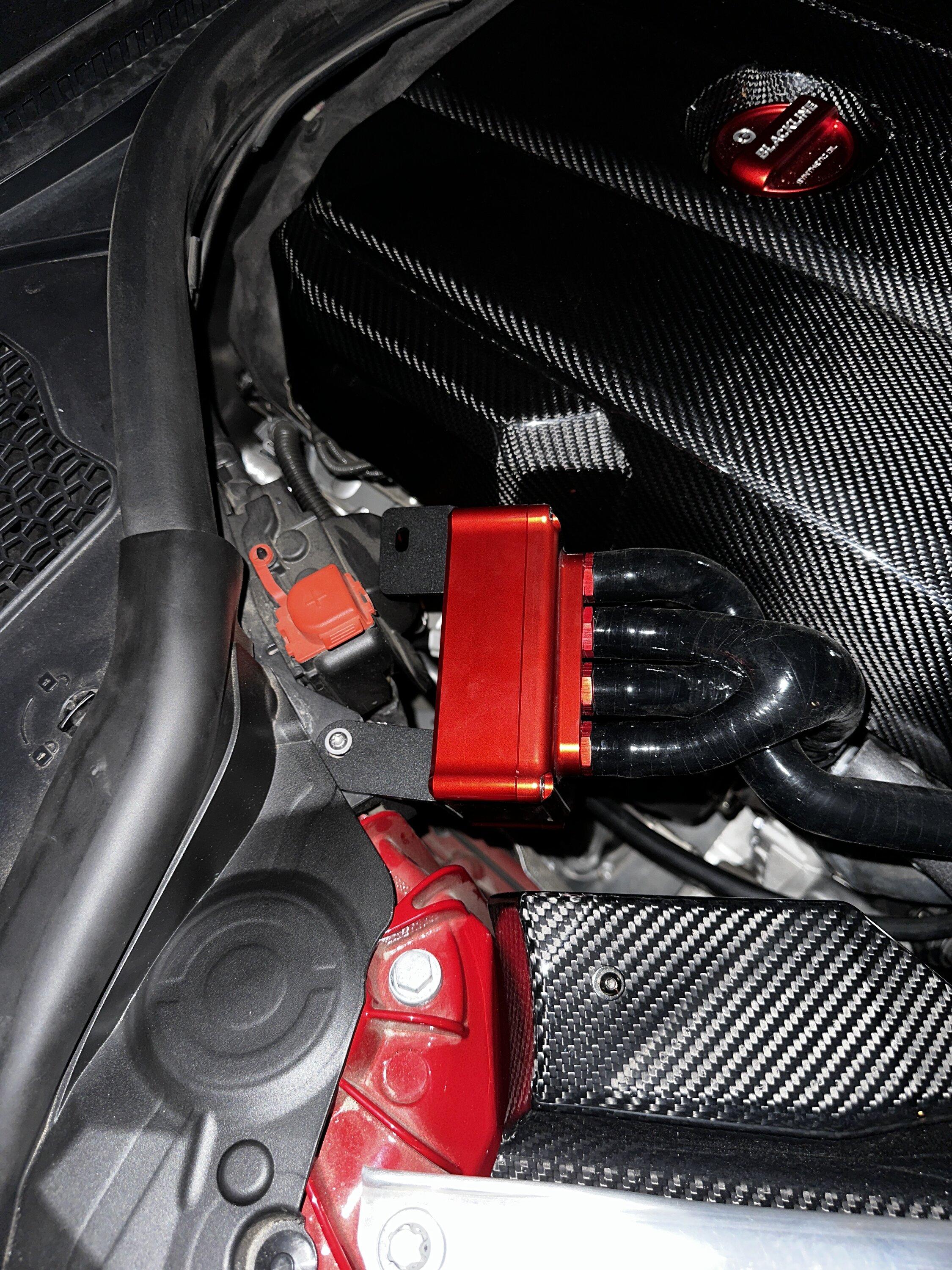

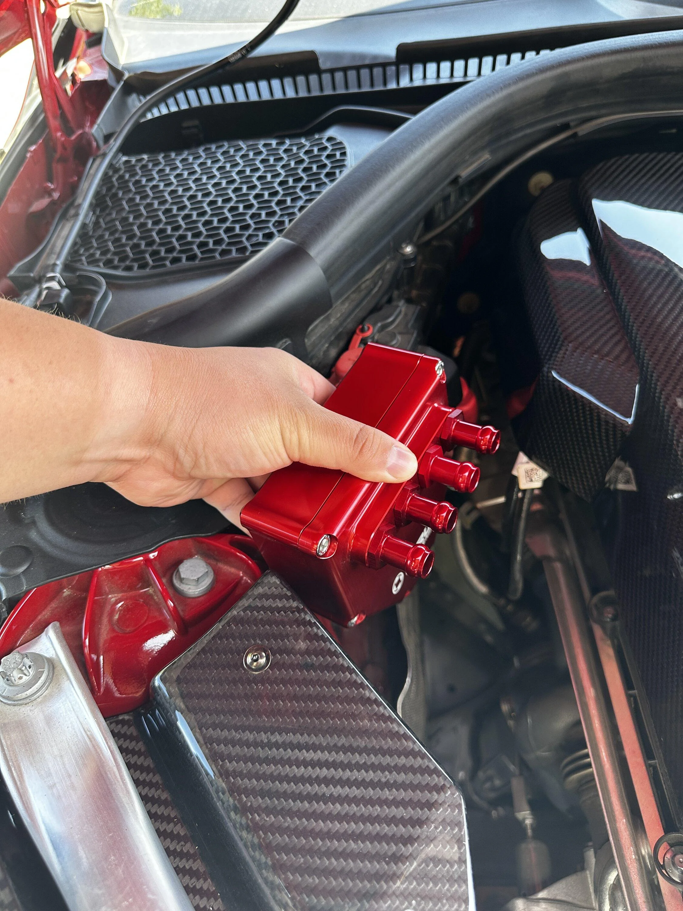

So I have the Armaspeed intake installed and can’t install the verus AOS due to the box not allowing the AOS to mount properly. Anyone find a decent way of maybe using a metal zip tie or something to mount the verus AOS?

Care to share what you ended up having to do? Were you just over-thinking it?
It wouldn’t fit because the cai box covers and blocks the first screw that is needed to mount the bracket for Verus. So from what someone told me they did was just attach the bracket onto the second hole and it worked. Sturdy and does not move but I would prob check on it once in a while.

Looks like he was trying to mount it in the wrong spot
No, the Verus brackets won’t work with Armaspeed cai. It’s just not possible without cutting the intake apart to make it fit which would be pointless.

your solution looks good
Thanks, yeah some others were trying to sell theirs but with no luck. So one of them came up with this solution which is better than it not working.

Mind if I steal your photos to send to clay and possibly add a disclaimer to the site about fitment?
Go for it! Also It’s on Verus website, which I should of checked ahead of time. But it is my fault as that should of been the first thing I should of done lol.

Did you have any issues with it being mounted at that spot?
