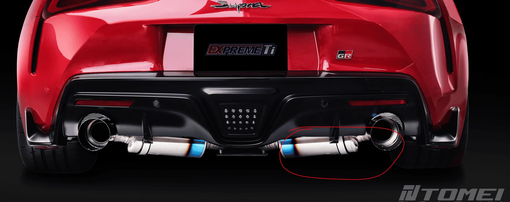

Just installed the Tomei single-exit & was wondering the same thing.
We decided you’d have to cut a significant amount of material to even make it kind of “fit”.
Even then, I feel like you’d have to hang/mount the diffuser at it’s lowest point…

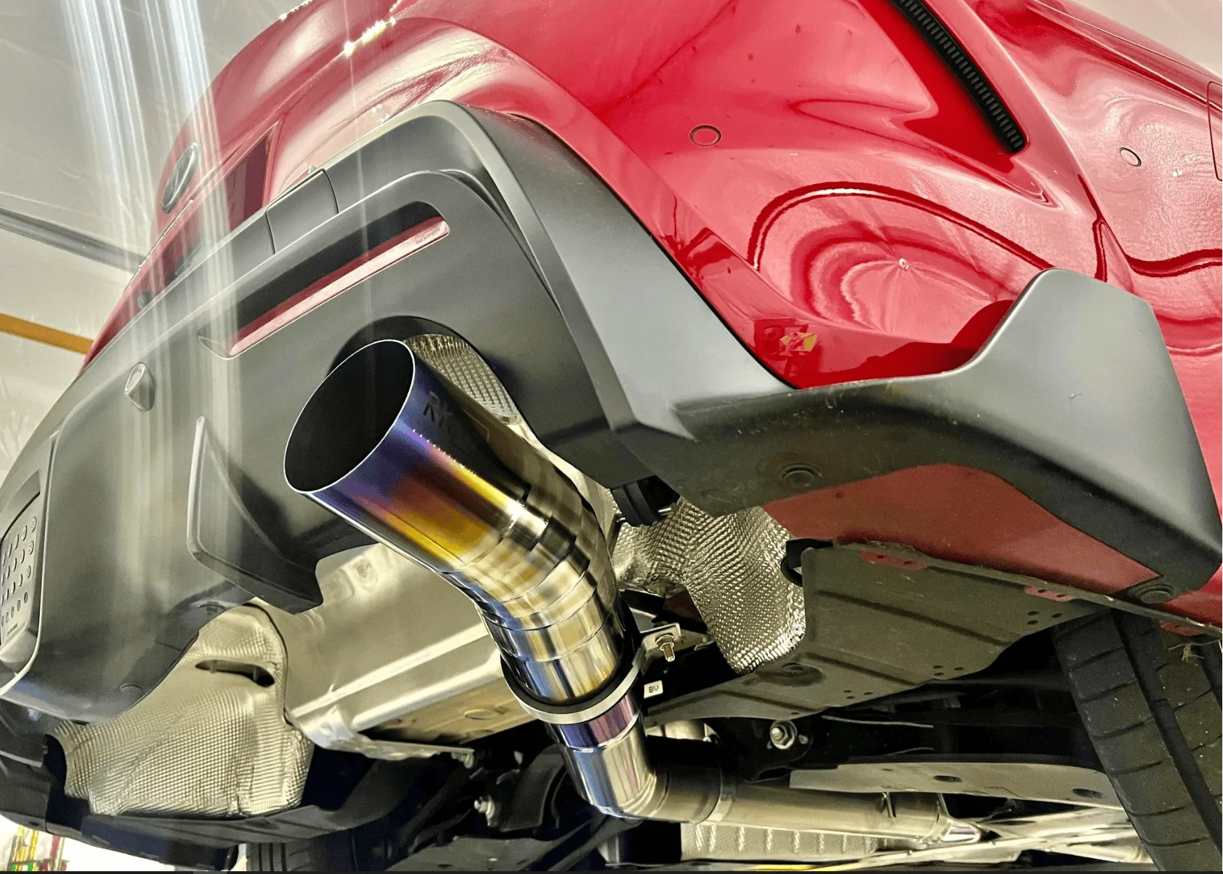

I'm really interested in getting the Verus Diffuser.
Anyone got a Tomei Exhaust and was able to use the Verus with no issues, or minimal adjustments?

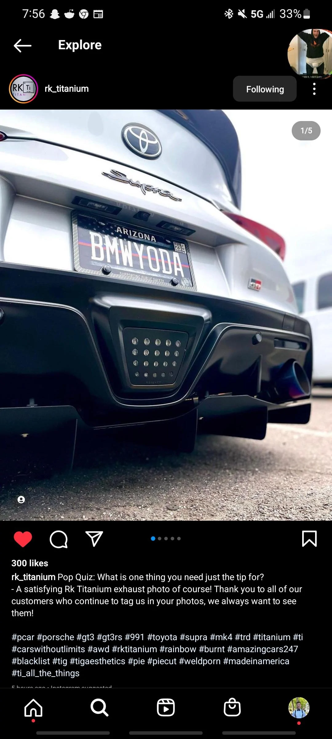

I don't know if this helps at all but I've seen someone running the rk-titanium single exit with the verus diffuser. Obviously not the same design but they did it without any cutting.
Nice!
I actually looked into this and the big problem is the crazy big mufler down the tomei exhaust.
Wit the RK there's really no muffler
But with the Tomei there's the big muffler that would get in the way
