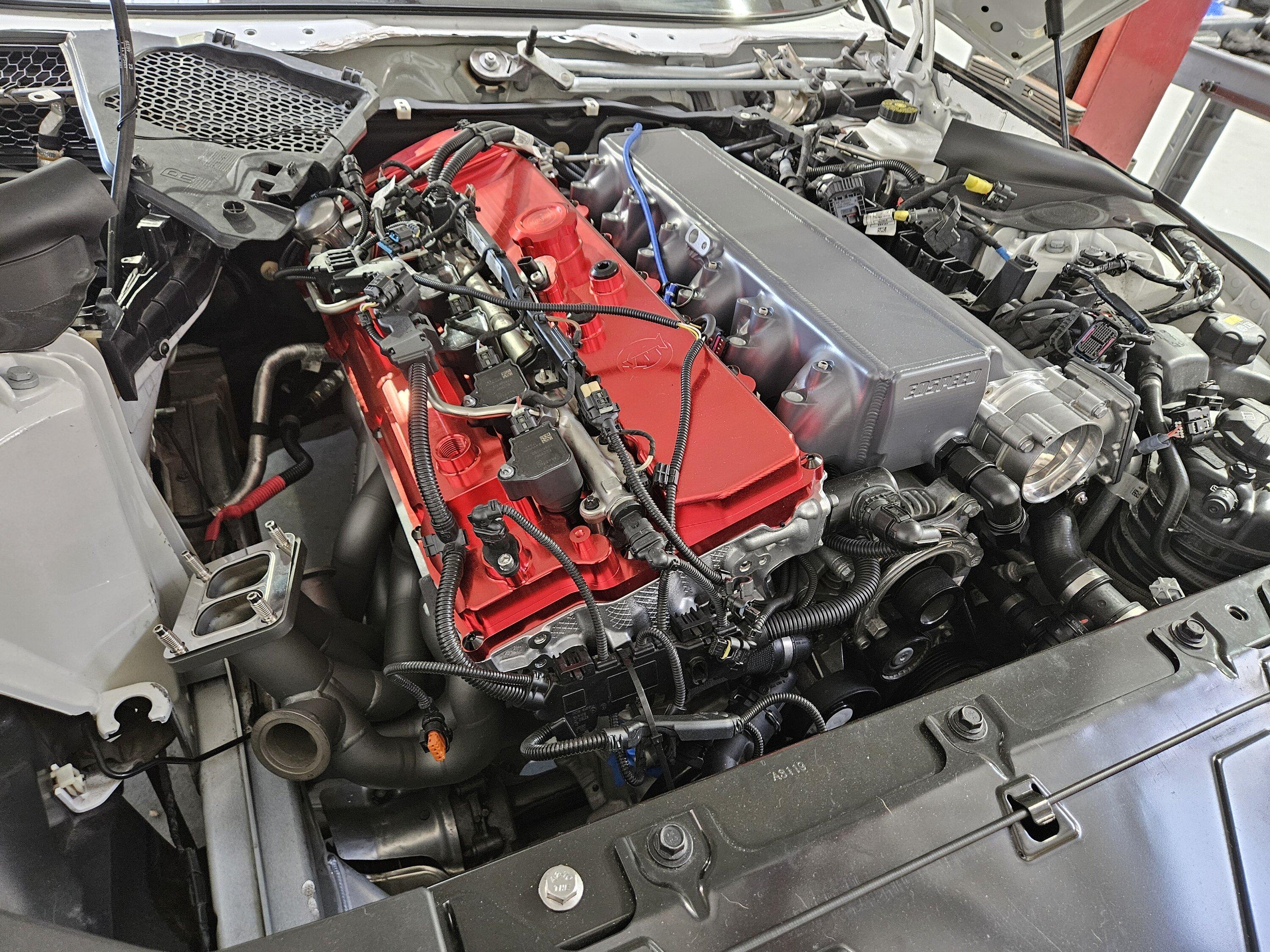

hi was curious if anyone runs the visconti tuning valve cover upgrade and what it dose and is it worth it as i could get wicked deal ?

One of the Supras local to me, using the VTT billet cover.
No feedback yet since still being built.
Built engine and transmission, top-mount, etc.

Yeah I'm talking about he plastic one not bullet

It blocks ports on the PCV system in the head, which becomes necessary with upgraded turbo and high boost. Boost starts to leak past internal diaphragms/baffles.
But the cover is kind of a waste. There are pins you can hammer in, or you can tap the little ports and install set screws. It's like 20x cheaper to get pins versus a valve cover, and it works just as well.
If you're not hundreds of horsepower above stock, ignore all of this and move on.
