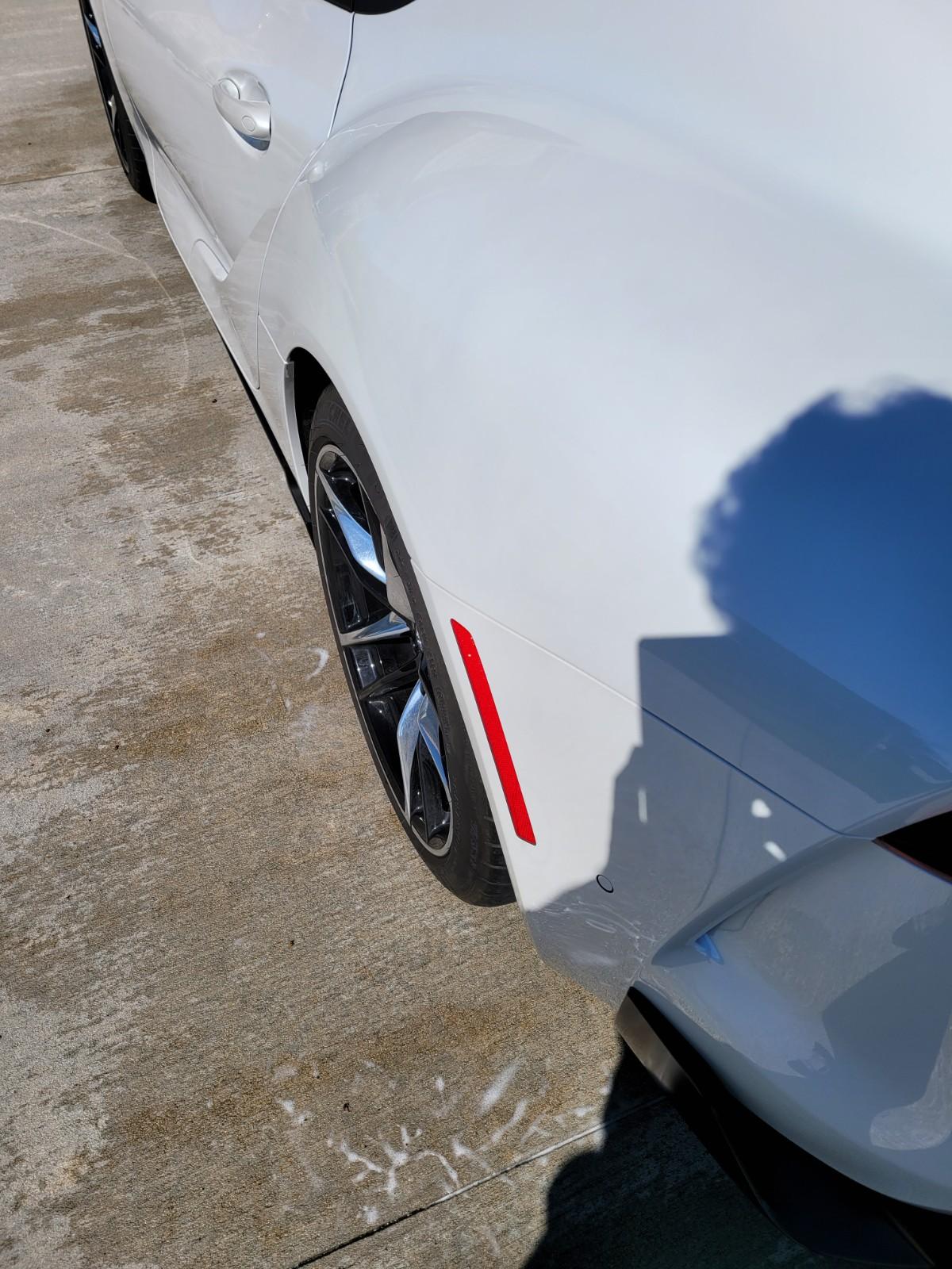

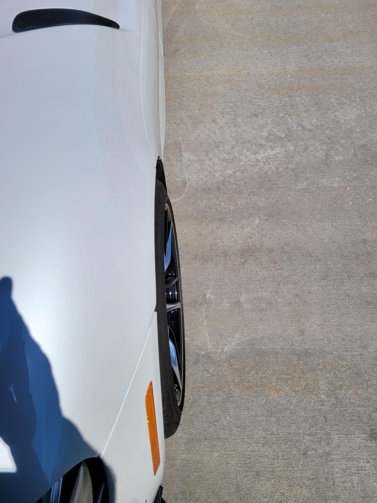

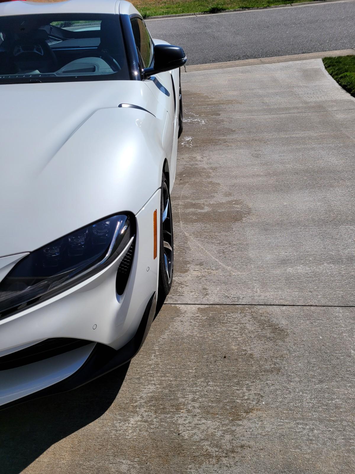

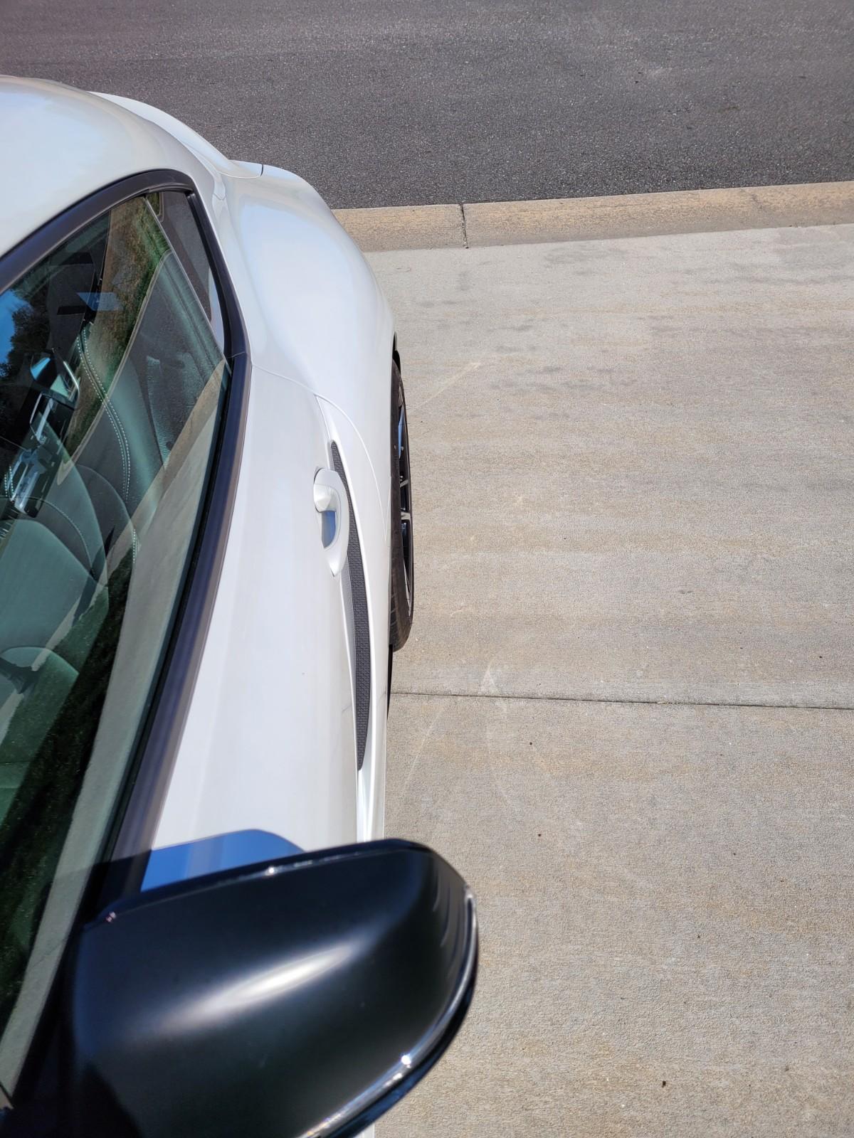

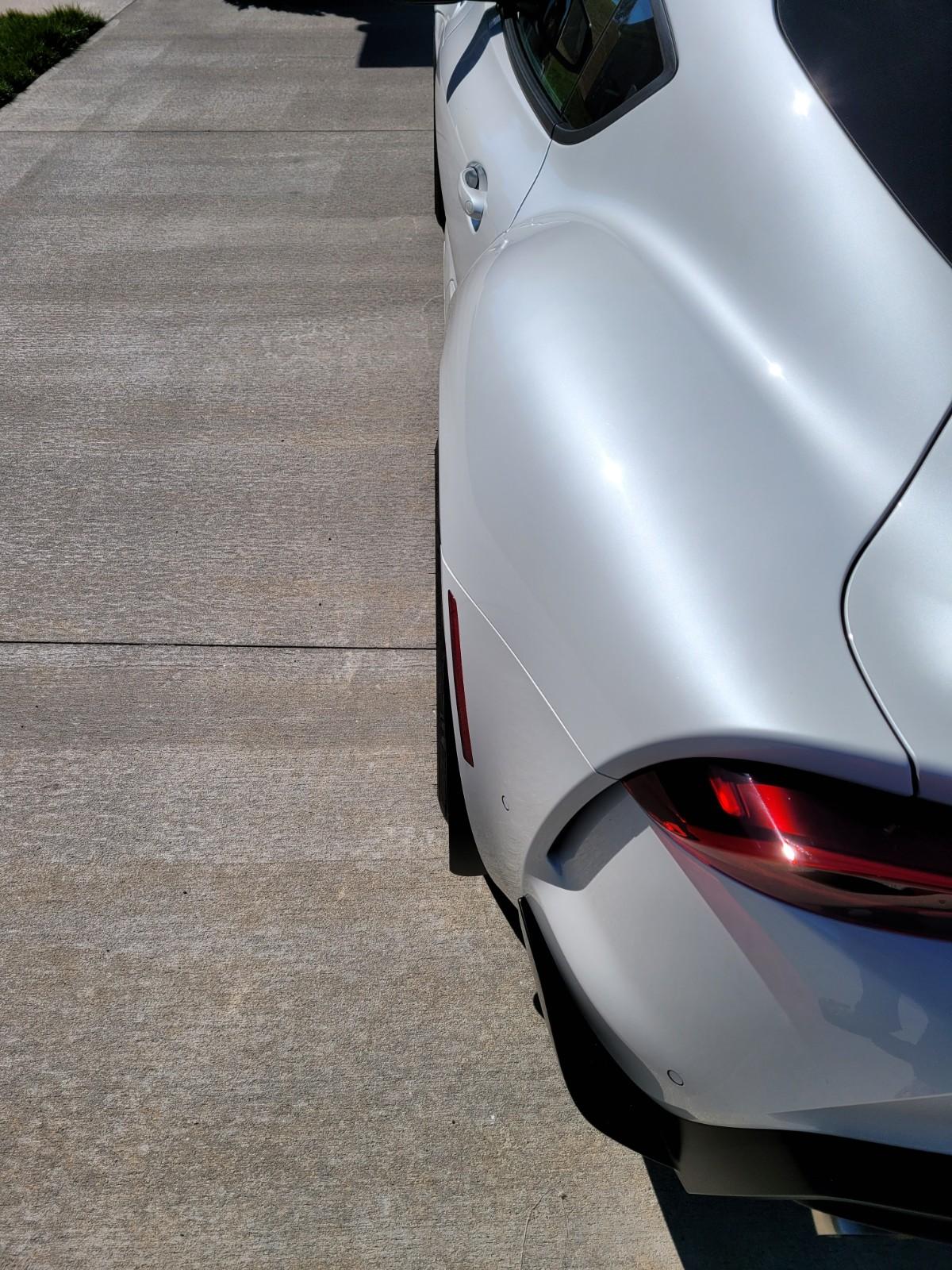

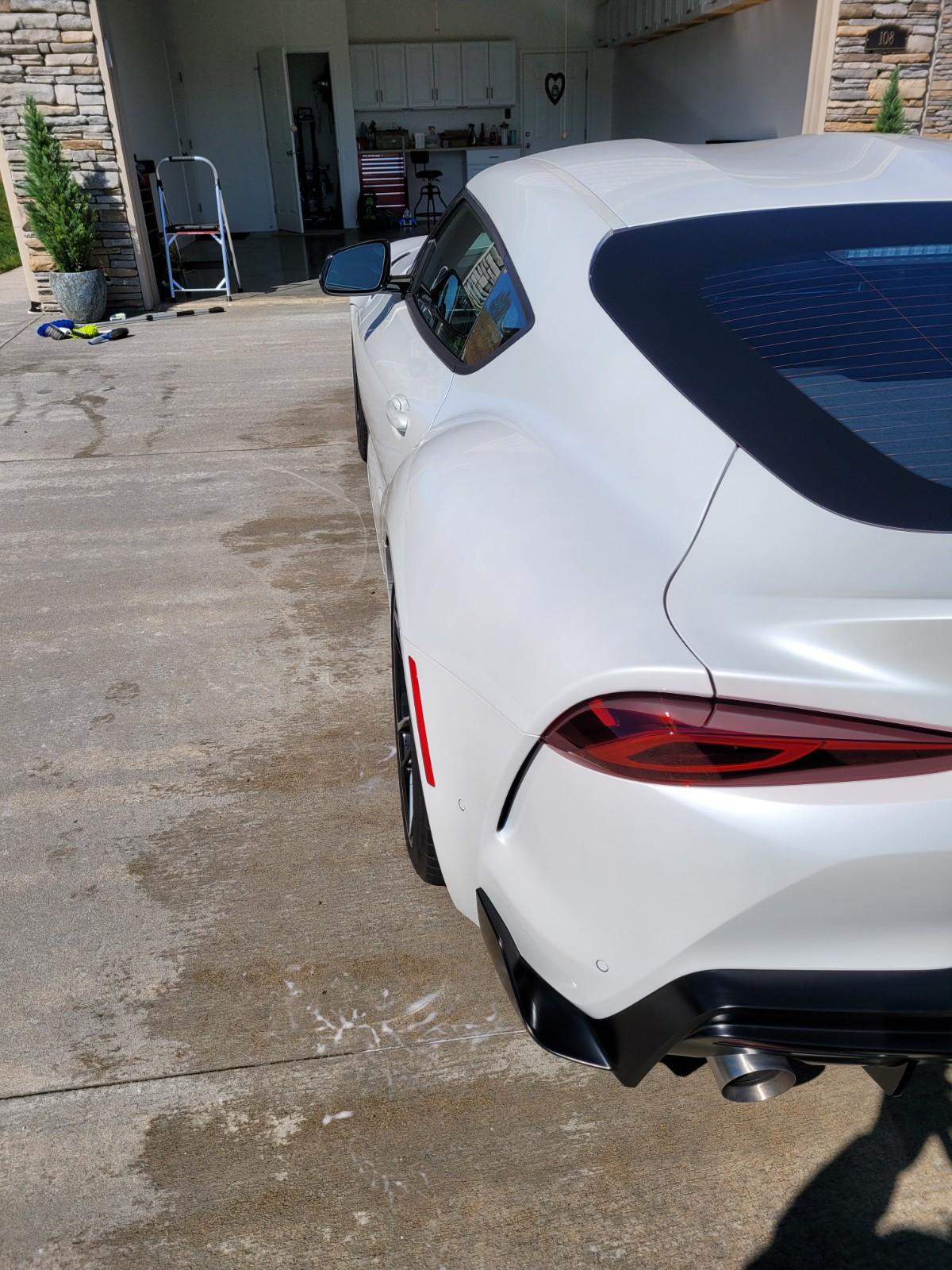

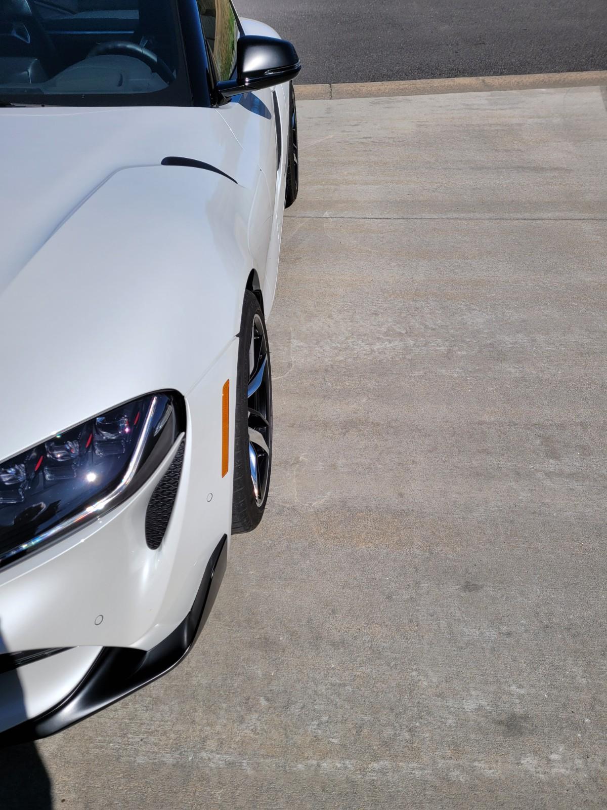

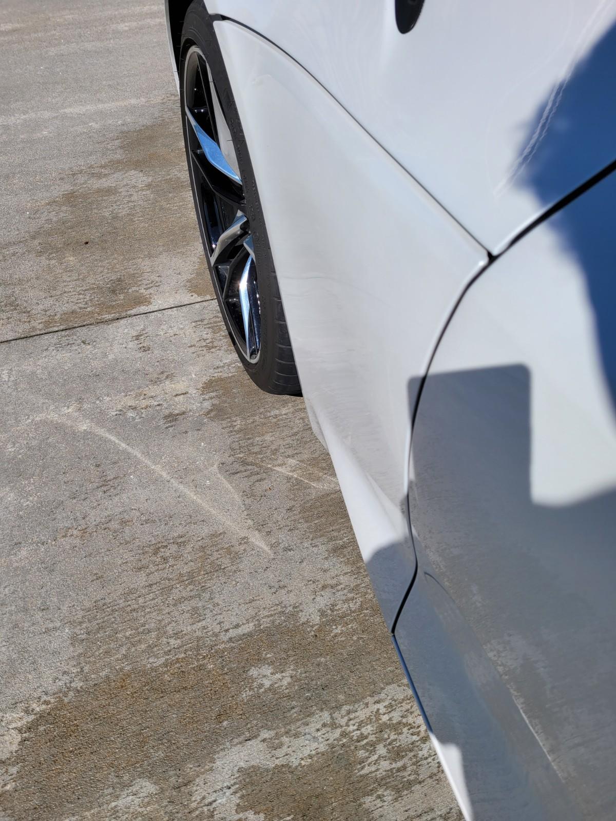

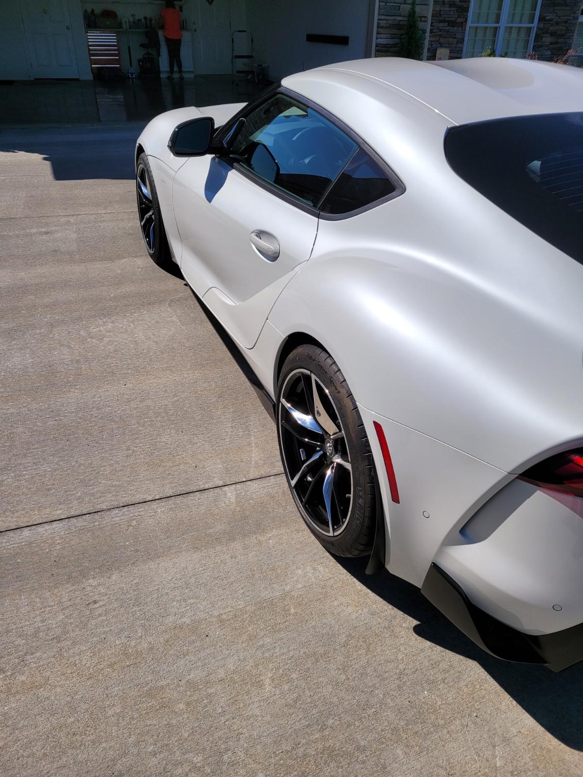

I installed Future Classic wheel spacers and rock guards from ZL1. I used 18mm rear spacers and 15mm front spacers. I like this width on stock springs. The spacers fit perfectly, if they fit any tighter on the hub you would have to press them on. The only problem I had with the rock guards is that the bottom screw on the rear was too short to work.
This was the first time I removed the wheels and have a little advice for those who haven't done it yet. Since you don't have studs once the wheel is off the center hub the wheel will want to fall and the dust cover behind the rotor can contact and scratch the inside of the wheel. The Future Classic spacers came with too alignment pins, that can be installed before removing the wheel from the hub, to aid removing the wheel without scratching it.
I have attached a few pictures before and after spacers and rock guards.
