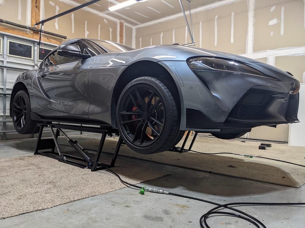

Got my QuickJack (BL-5000SLX) in today from Home Depot that I had ordered during Black Friday for $1,080 (i was hoping i would find Costco sale for $1,000 this year but it didn't happen). Just waiting on the pinch-weld-blocks to lift my other car and Wall Mounts.
Using the standard [supplied] blocks work perfectly fine on the Supra\BMW jack points without the need of special adapters.
Easy to set-up; however, mine came with Liquid Thread Sealant (despite the QuickJack Owners Manual and YouTube video showing sealant tape). Do NOT, I repeat DO NOT use the included Liquid Thread Sealant, it leaked on me and made a mess of Transmission oil everywhere (for those that don't know, you need to purchase 3qts of Hydraulic or Transmission fluid separately). I purchased good ole' Thread Sealant Tape, had to re-bleed the entire system, and BAM, no more leaks.
**FYI -- I think the new 5000TL will be replacing (or has already replaced) the 5000SLX. It raises the car 3" higher while being roughly the same length and width! However, that wasn't on sale for Black Friday so I opted for the older version that Home Depot had; plus I personally don't feel that I need the extra 3"s.
@PerformanceSound ... This thing is dope.

This is the one I was telling you about. It has rubber stoppers to prevent the pinch welds from bending.
Man I need this in my life. I just spent several days dealing with jackstands and jacks. The Supra is a little tricky to jack up too since it is low and the jackpoints are fairly hard to get to.

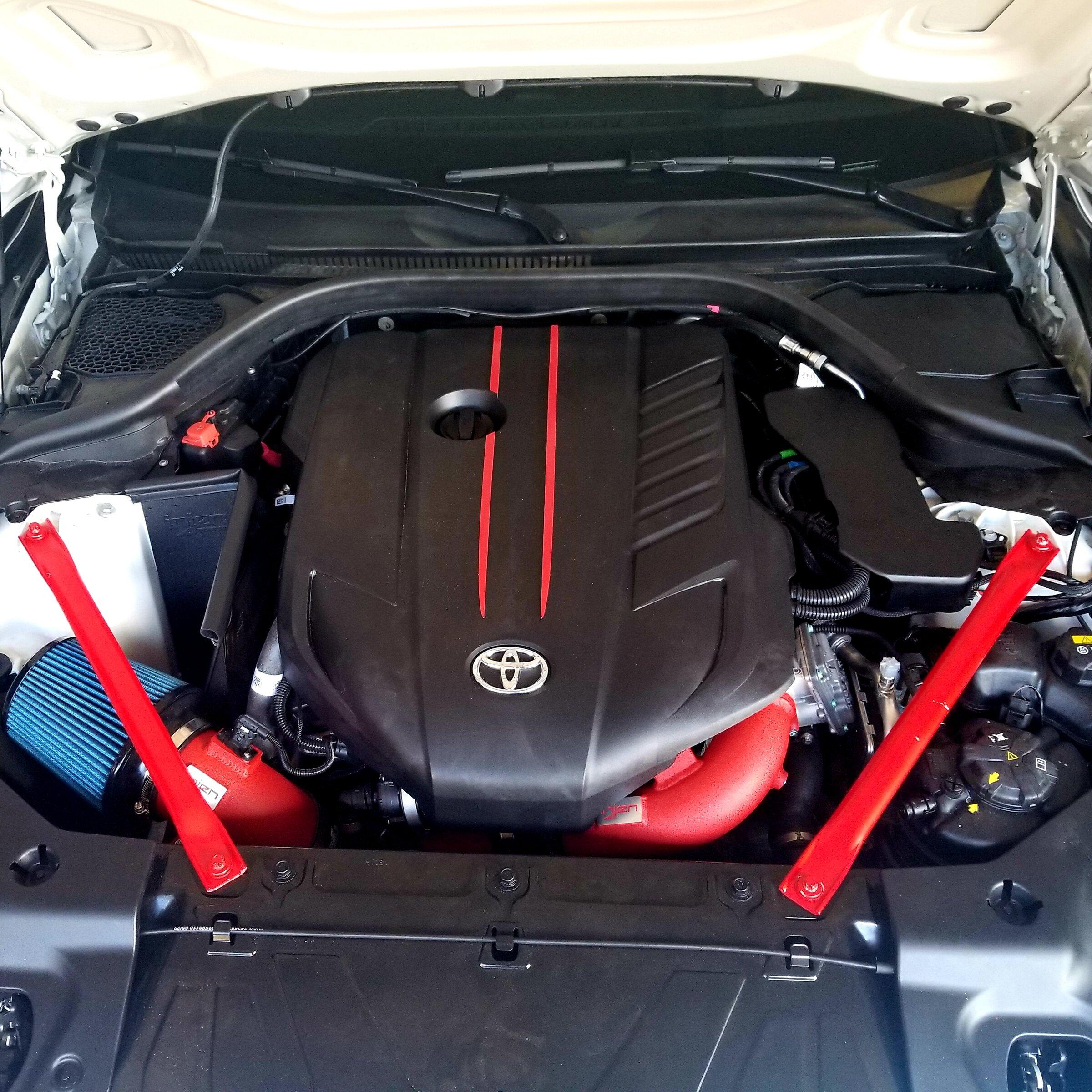

First Mods! I rattle canned the braces to see if I liked them red. I might redo them better soon!

Let us know if the paint falls off with the heat. Been thinking of doing that instead of paying a pro

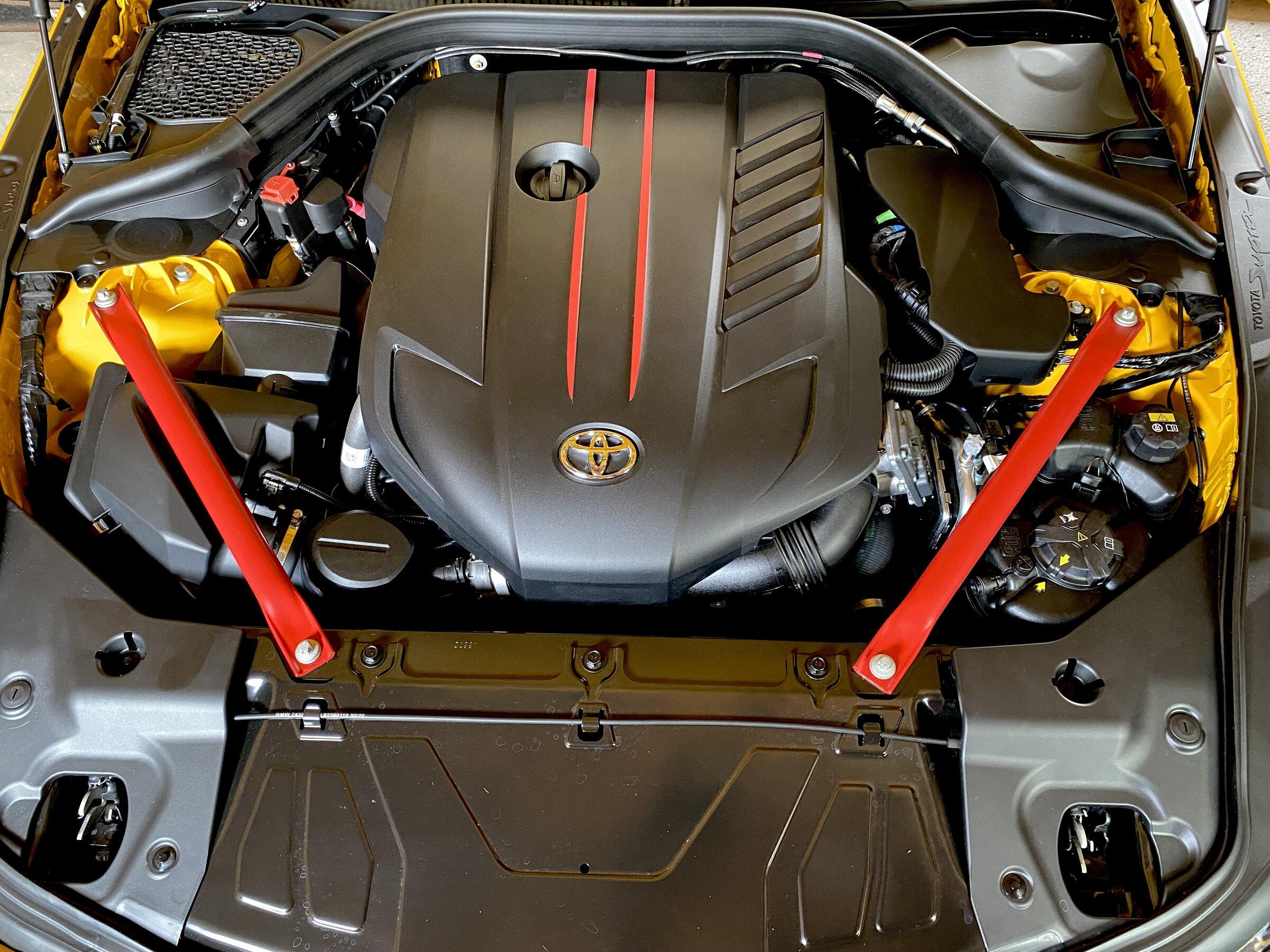

This was the first mod I did to my car. I used engine enamel and have literally no experience with any kind of spray painting. It was very easy and turned out well. It is holding up and still looks exactly the same 4 months later.

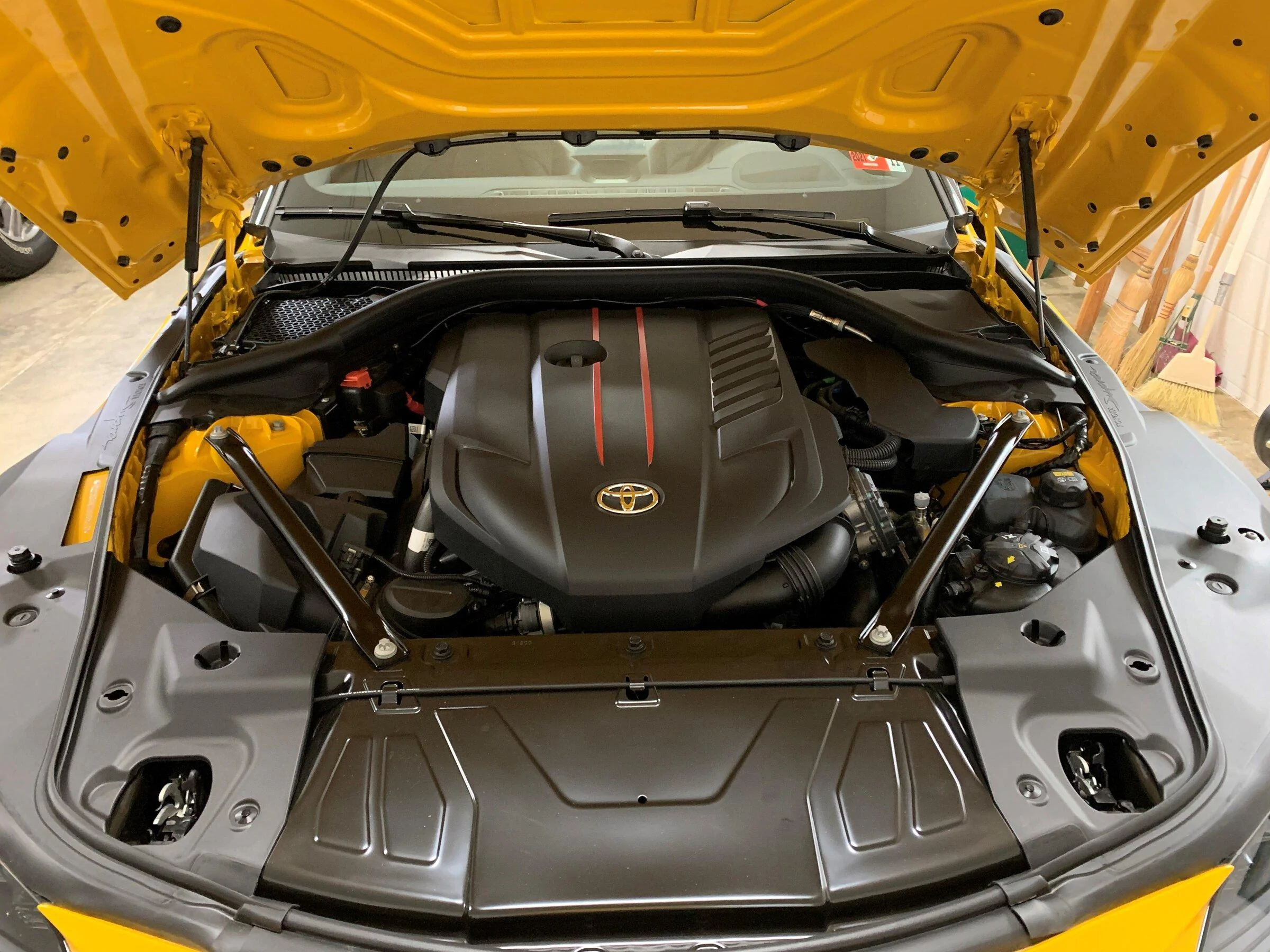

Nothing special needed and an easy DIY project. There's no heat impact. A cheap can of Krylon (whatever color you choose), some sand paper, and 3-4 lite coats does the trick. Just remember to scuff them up well before spraying and let them dry between coats. I don't recall exactly when I painted mine but at least 6 or 8 months later and still look like day 1. Edit - looked it up. It was last December when I did them (time flies I guess). One year later and still look like day 1!

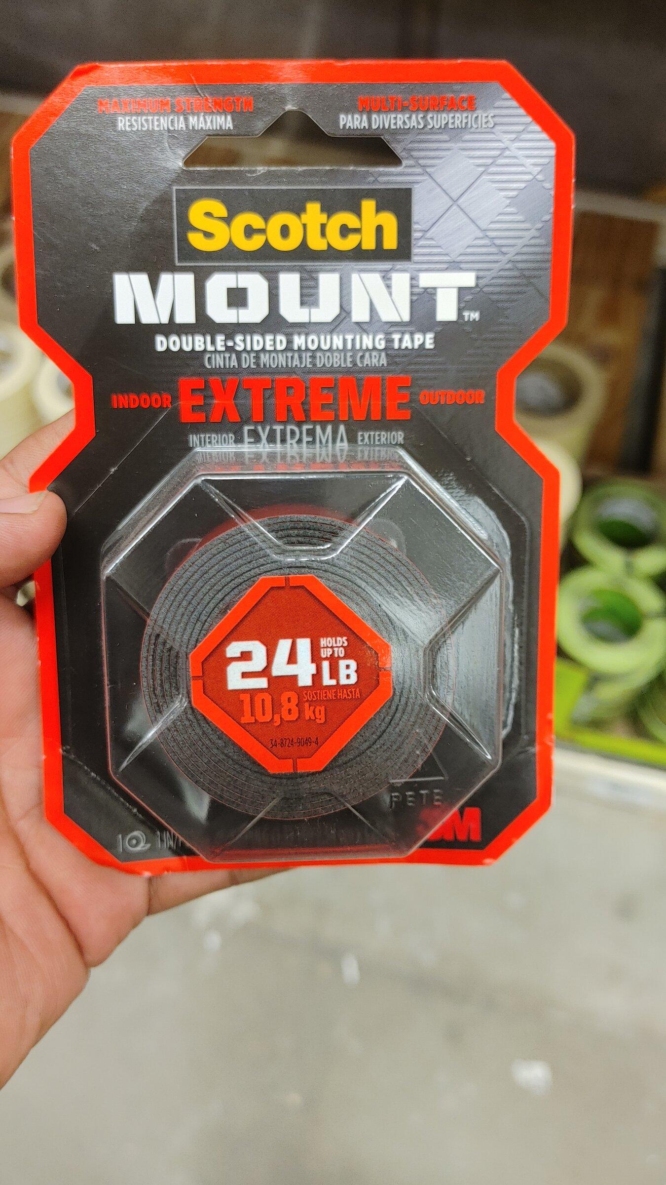

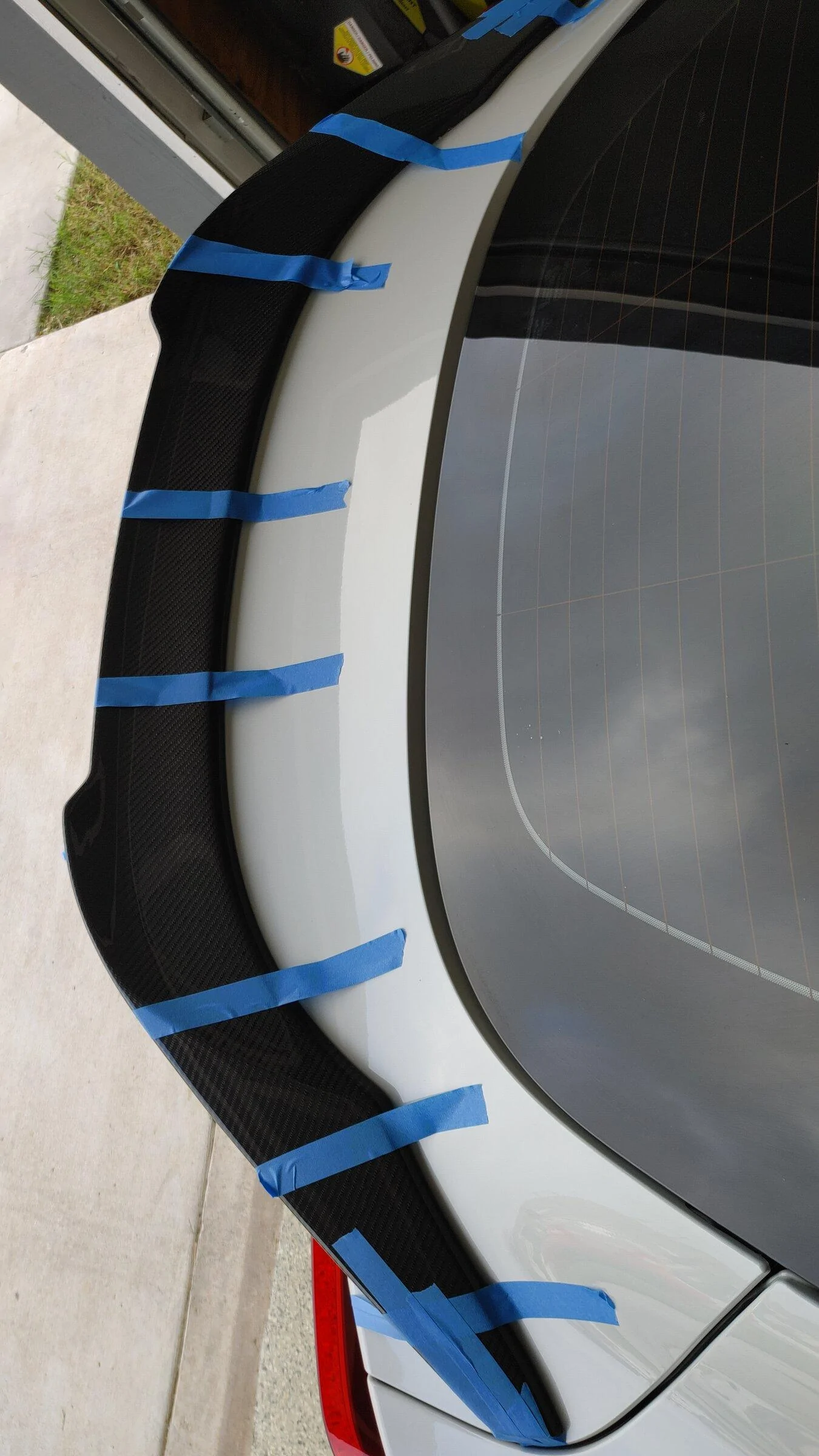

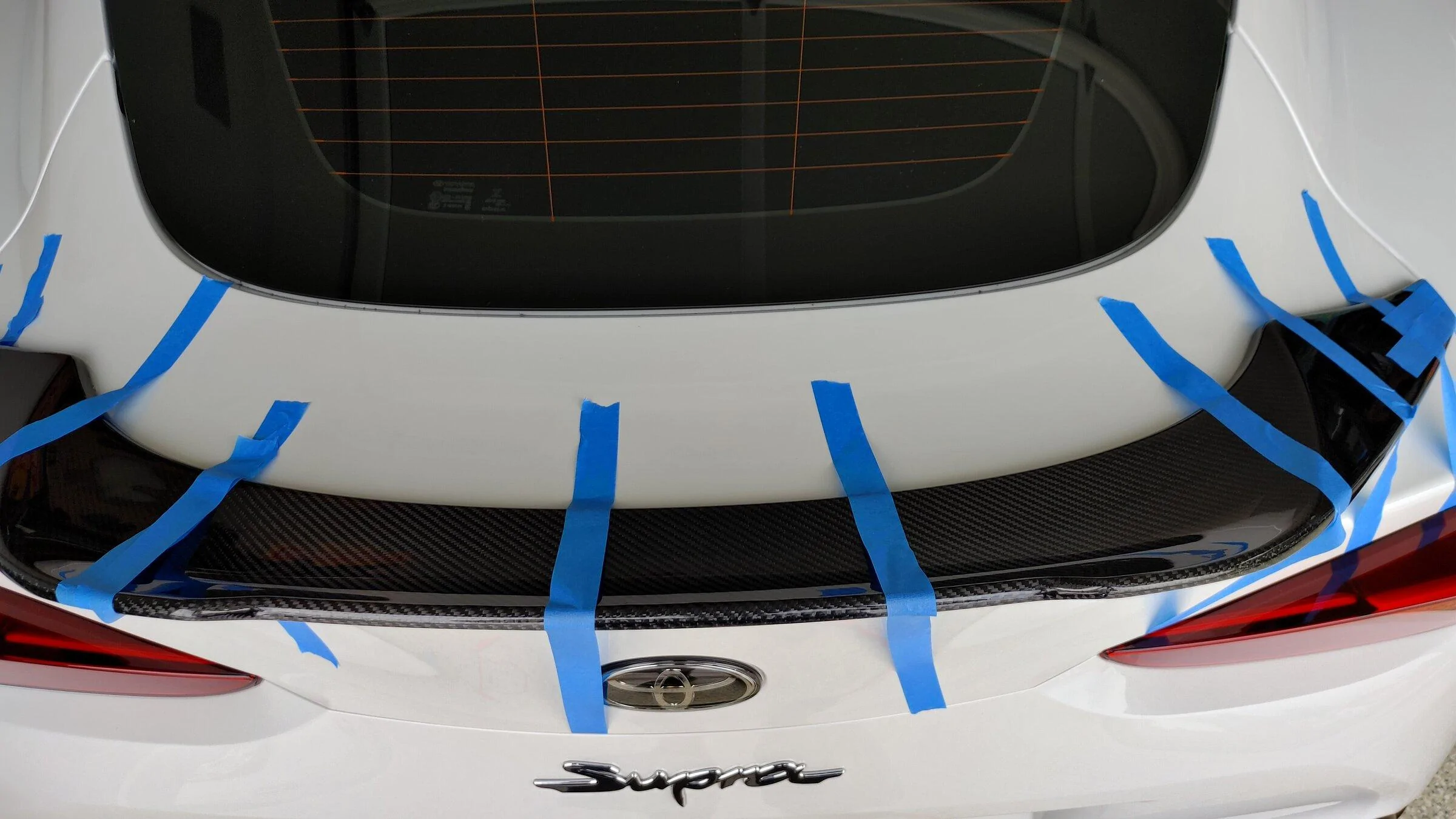

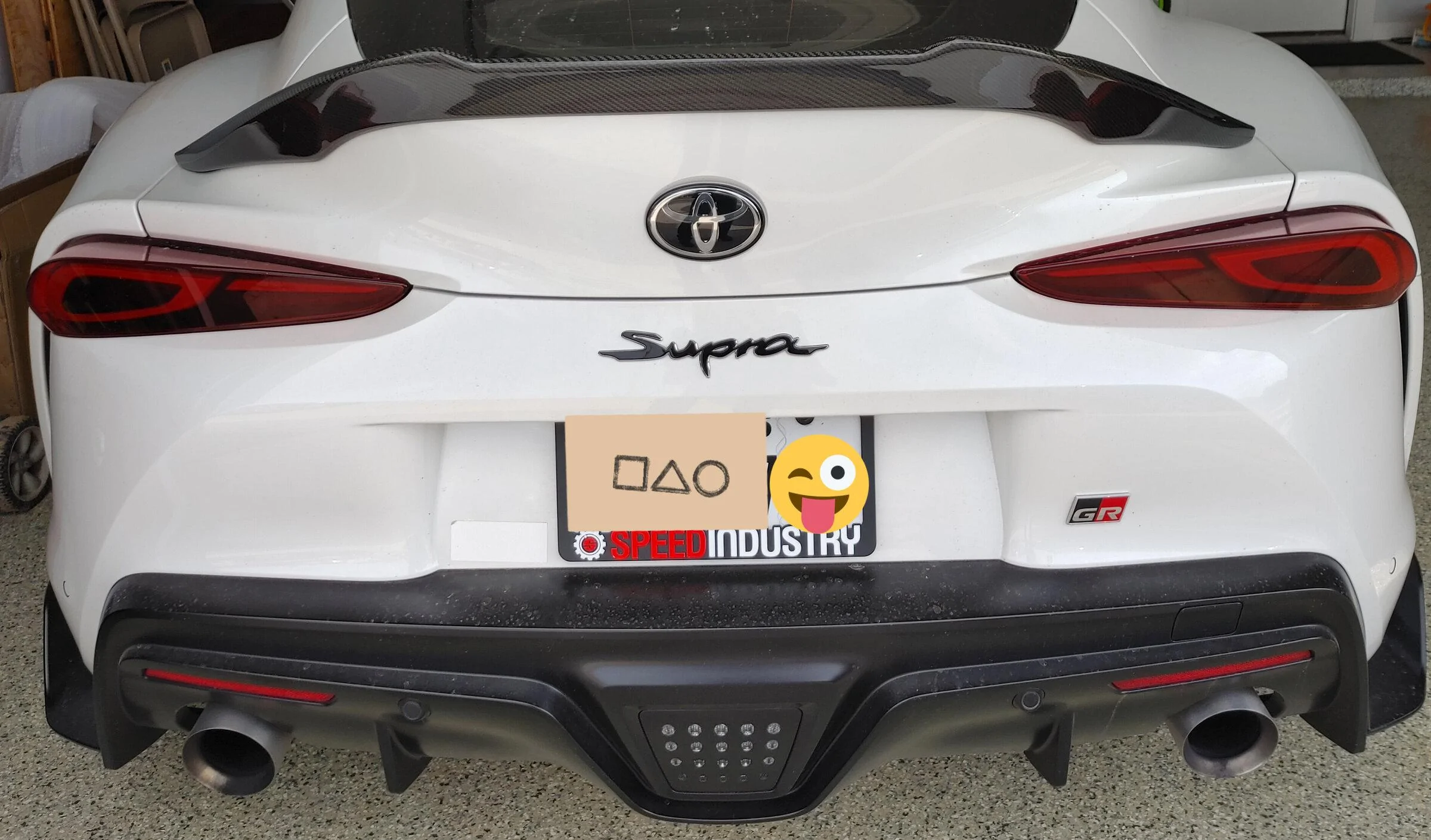

I received my CF DuckTail/wing a couple of days ago.. installing today let's see how it goes
Test fitting ??
Gonna let it sit here for a while... Had to buy the heavy/extreme? tape.. The one that came with i wasn't feeling it..

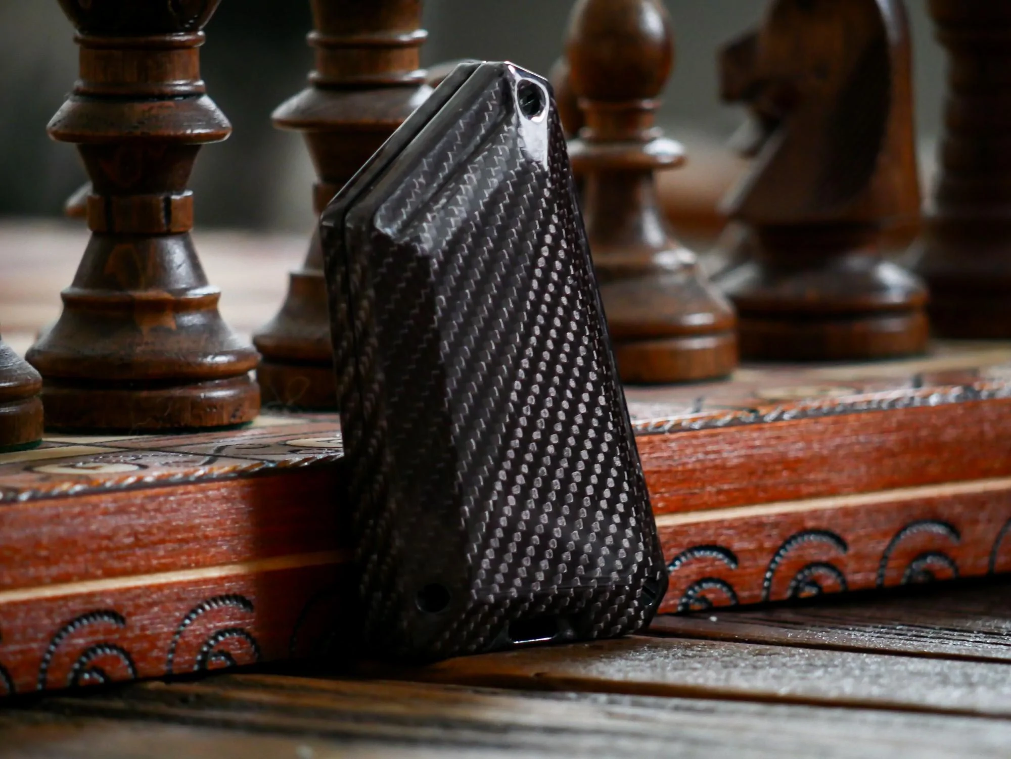

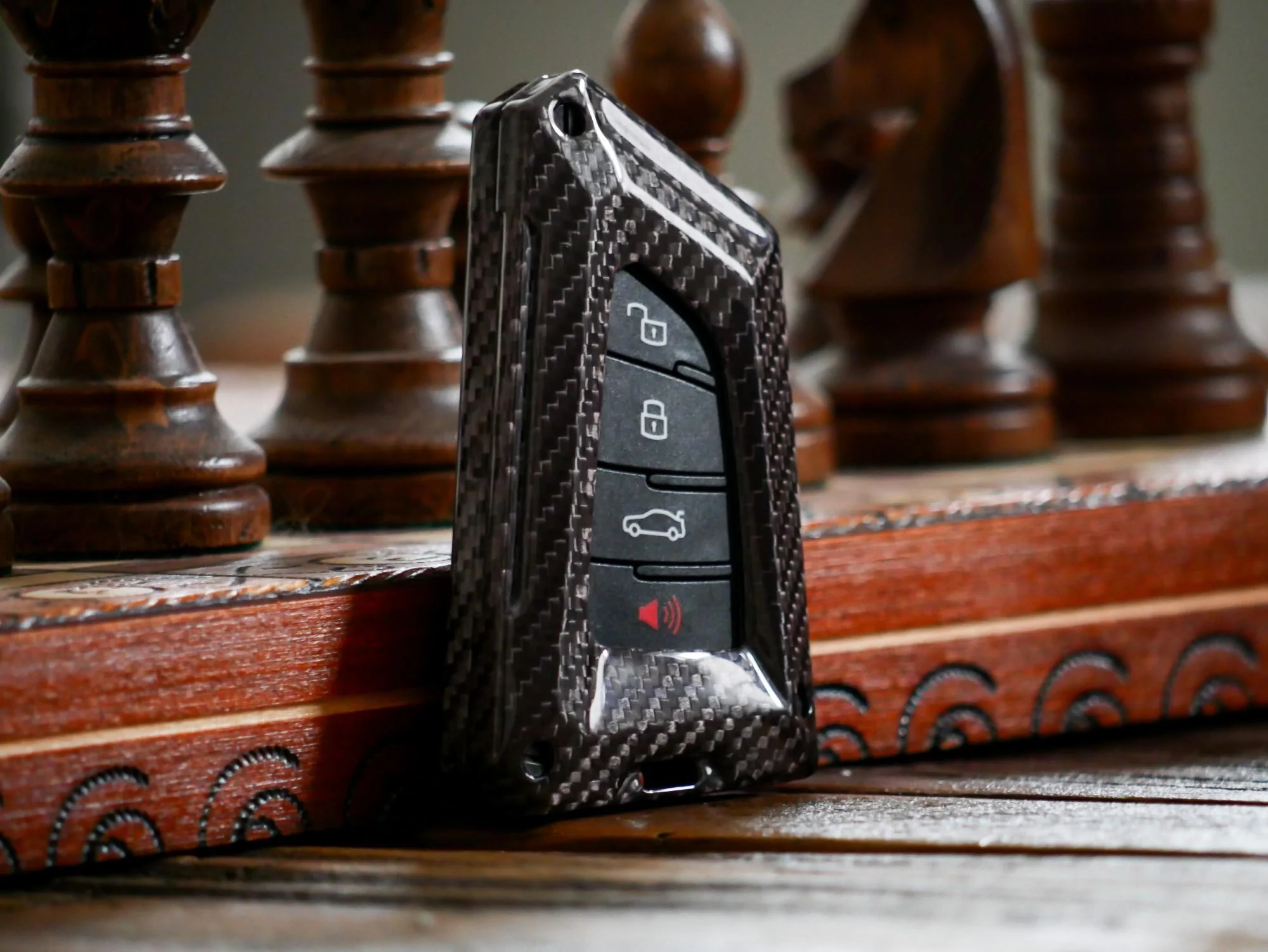

Got the Rexpeed Key Fob Cover. It came with some stick on felt to protect the plastic on the fob from marring. I had to shave down a screw for the to side. It's a little on the bigger side now, but I like it.

The remotes are way too big already. It's really nice but I can't have something that big in my pocket. No room......?
