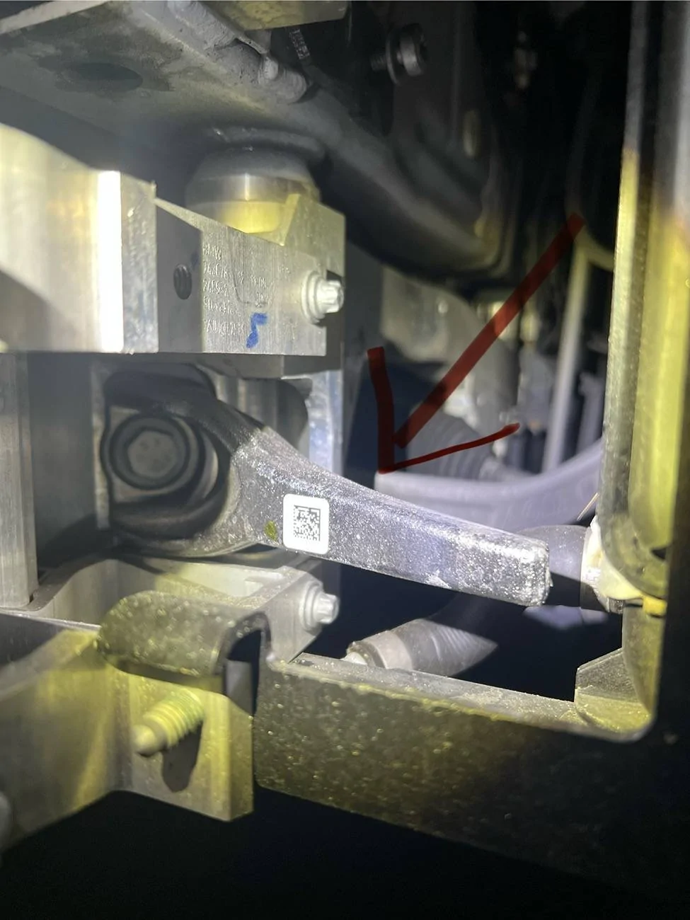

Can someone tell me what the main purpose of this arm? Some type of counterweight & spacer?

razorlab Well-Known Member First Name Bryan Joined Oct 2, 2021 Threads 29 Messages 8,806 Reaction score 17,278 Location NY Car(s) Not a Corvette. Mar 13, 2025 #3 Those are crash levers

garudathree Well-Known Member Joined Jun 9, 2021 Threads 13 Messages 293 Reaction score 346 Location ny Car(s) none Mar 13, 2025 #5 rips off the caster arm bolt in a small overlap crash, and avoid the wheel/rotor intruding into the cabin by letting it rotate eu cars don't have it, note the ncap crash vs US iihs above
