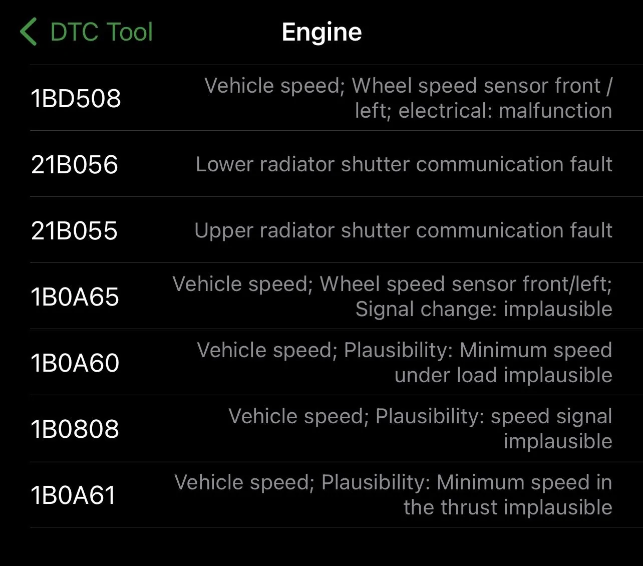

Hit a pothole the other day and immediately was greeted with a barrage of Christmas tree lights on the dash as well as a large serving of error codes. Car put itself into limp mode. Pulled the codes through ecutek as well as bimmerlink. When clearing the codes, all of them are cleared except 1BD508. I know 21B056 and 21B055
Error messages have been drivetrain error, chassis stabilization, driving assistance support reduced, pedestrian warning, frontal collision warning, cross traffic warning, parking assistance malfunction.
Replaced the front left wheel speed sensor (Part #89516-WAA03) and cleared the codes again, but same stuff happening.
Is this something I need to use Toyota ISTA to clear?
