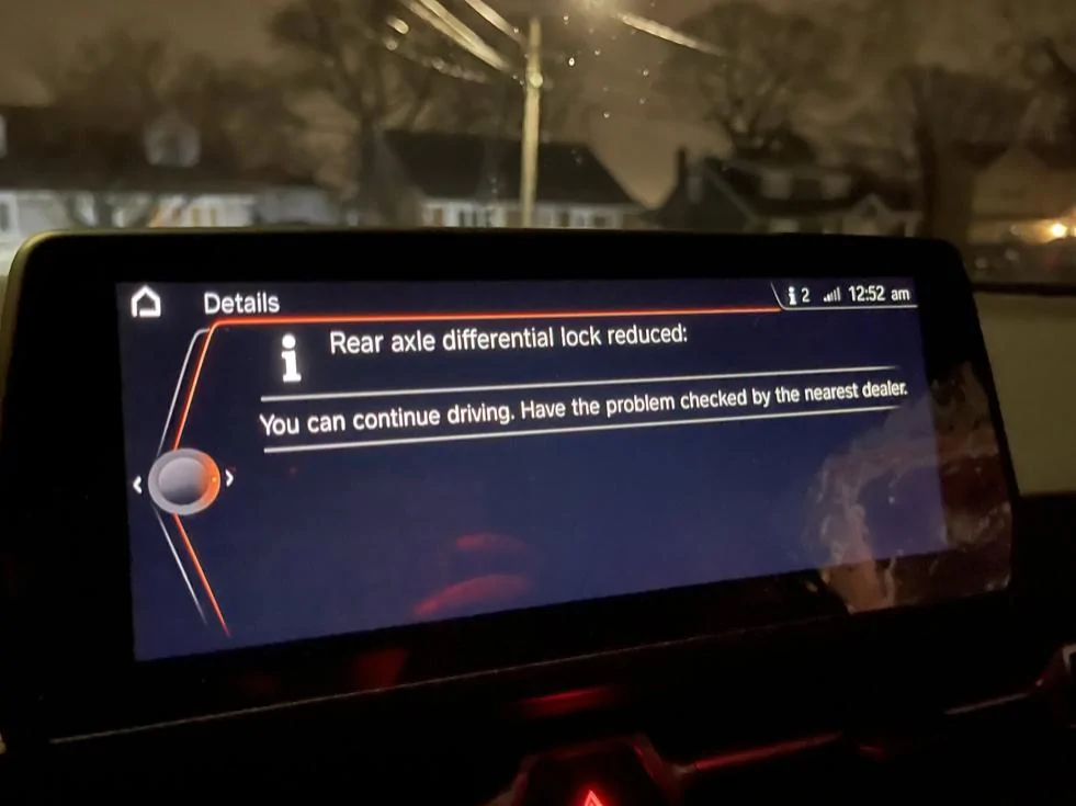

Hello i’ve been having this error come up randomly when driving. There’s a message that comes up on the screen that says that the rear axle differential lock is reduced and that i can continue driving but i need to take it to a dealership to get it looked at. So far the car still drives fine but i’m just worried about what it could be causing it because i only have around 6,000 miles. I was just wondering if anyone could explain what this means or just any help would be much appreciated!
Here’s a picture from another forum but it’s the same error i’m getting.

Update: Took it to the dealer and got it looked at. The technician that looked at it found no leaks and the only minor issue was a battery cable being loose. At the time when the error came on, the driver rear tire was 33 and all the other tires was at 40. That night i put the missing air in the low tire and it hasn’t came on since . Also it turns out their was a nail in it and it was slowly leaking out air. In addition the tech said he had another supra there for the exact same issue, only he couldn’t get the error to go away.

Has anyone else run into this issue with correct tire pressures? This message just started appearing for me when my car hit about 100 miles on the odometer…

Update, just got my car back from the shop (took 9 days). They replaced the differential lock/temperature computer (83294-WAA03), the differential lock actuator motor (41400-WAA01), and an o-ring (90118-WA286). After replacing all the parts, the transmission temperature read as 32,000 degrees Celsius and all the computers needed to be reprogrammed to get the faults cleared.

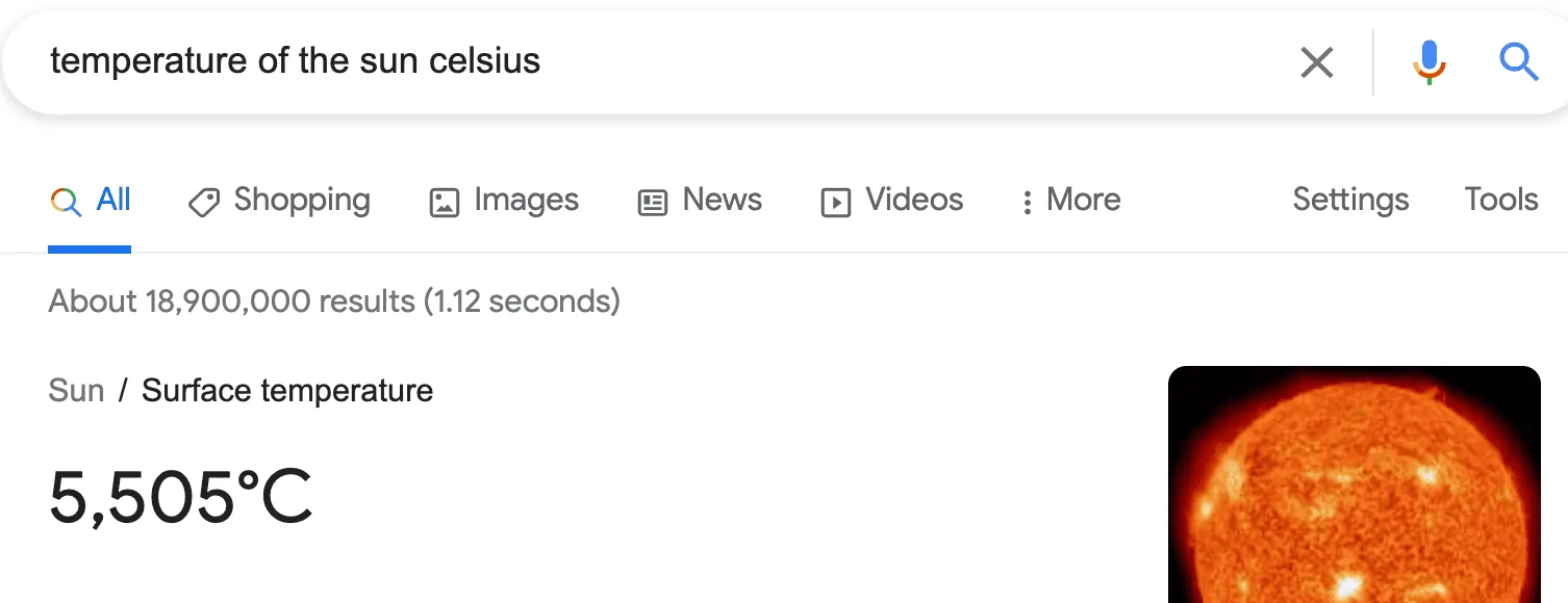

That's very hot.
All jokes aside, 32,000 (32,767, actually) is probably a 16bit integer over/underflow. And the sensor just wasn't reading, so it bugged out and overflowed.
