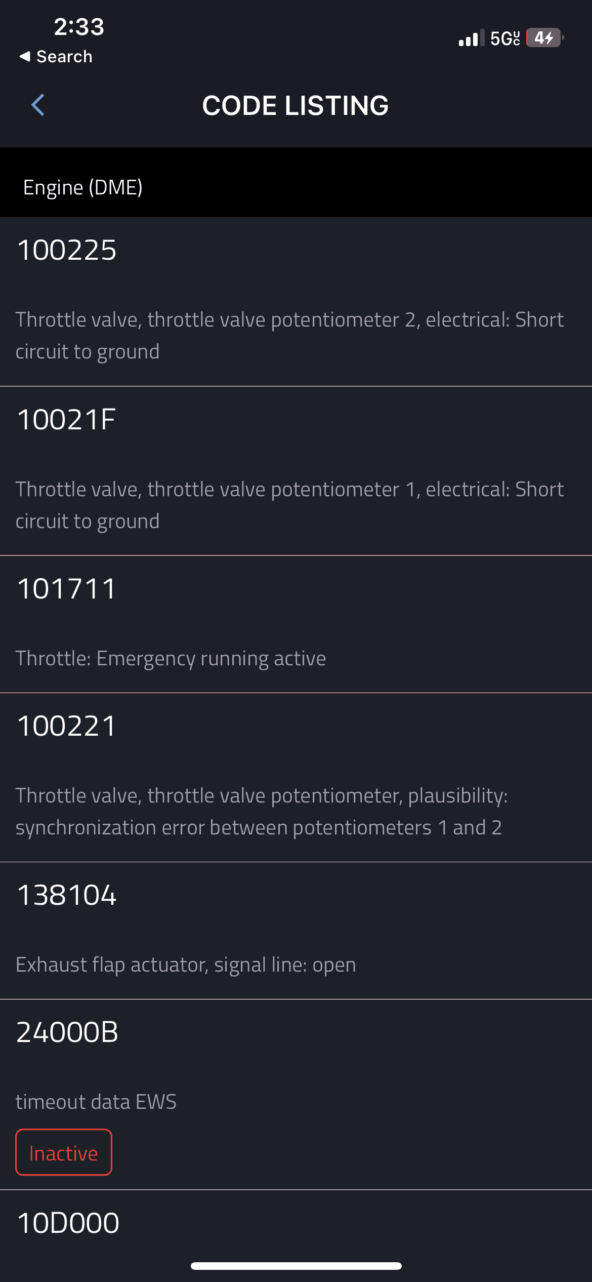

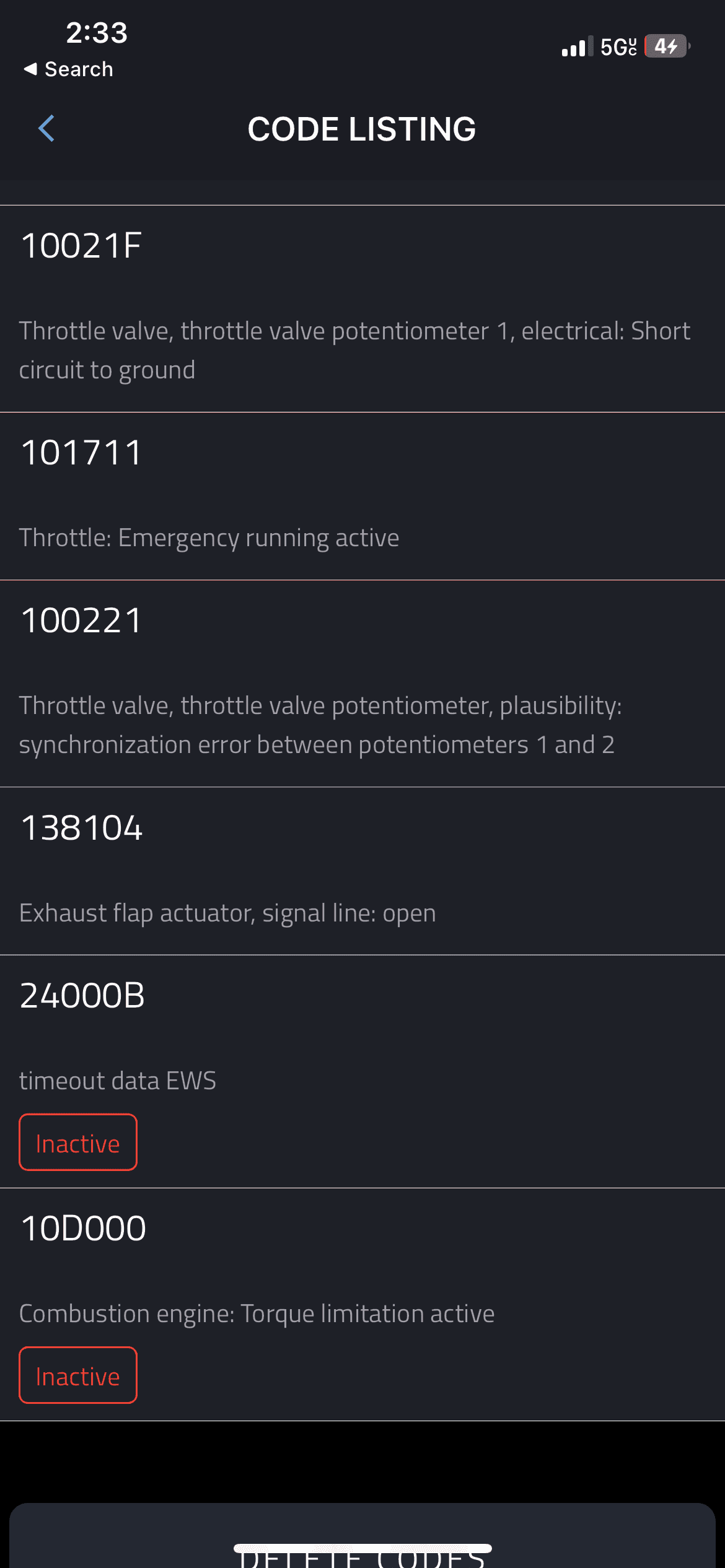

Got this error doing a small pull today. WOT from 50-75 mph. I looked at the codes and figured that the throttle body sensor wasn’t plugged in fully. I checked it and I plugged it in until it clicked all the way. Other than that I’ve cleared the codes and haven’t been able to get rid of the error every-time I turn the car on. I also tried resetting the throttle valve adaptation in BM3. Any help? The code I keep getting now is 100215.
