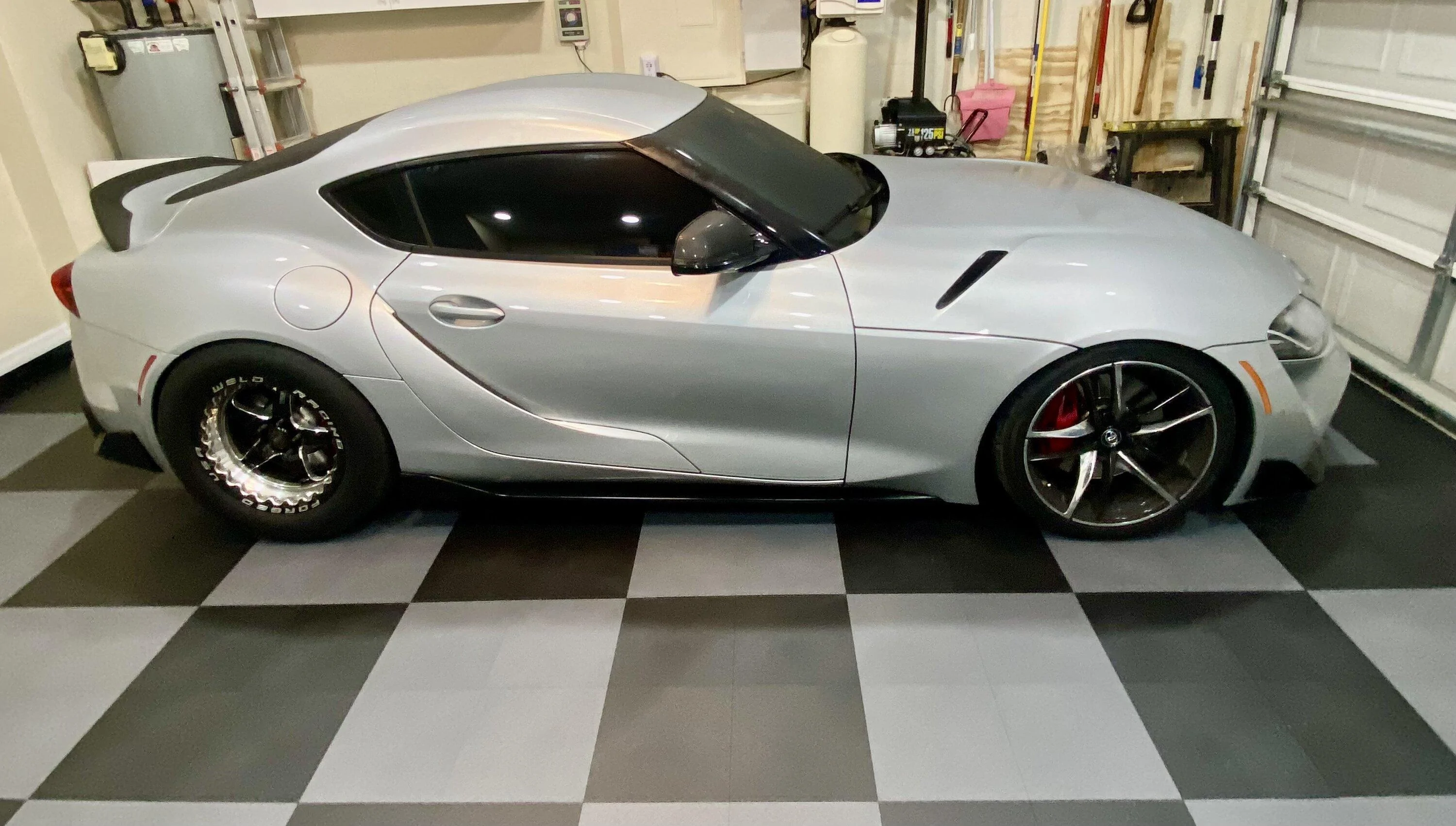

I would like to run my 2020 19” premium oem wheels on the front axle because I would like wider wheels on front and am hoping the offset would bring the wheel out more without spacers. I’m already running 10.5” Beadlock Welds on the rear. Ok I know this may sound weird but any info is appreciated.

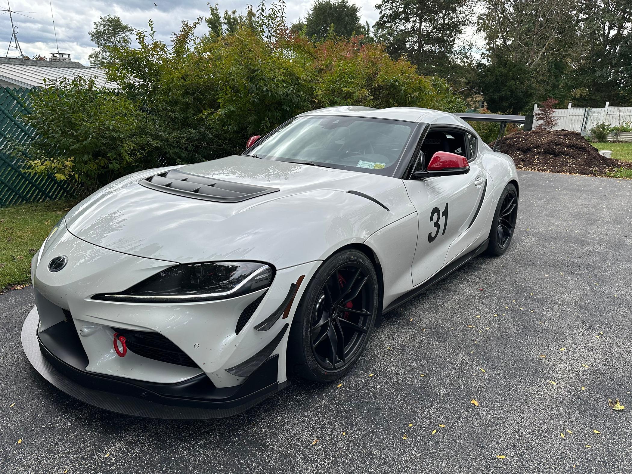

This has been answered at least a hundred times now. Yes, you can use the rear 19x10 wheels in the front, but if you are stock suspension you need a spacer.
My Supra with the OEM 19x10 wheels front and rear:
What size are your tires?
