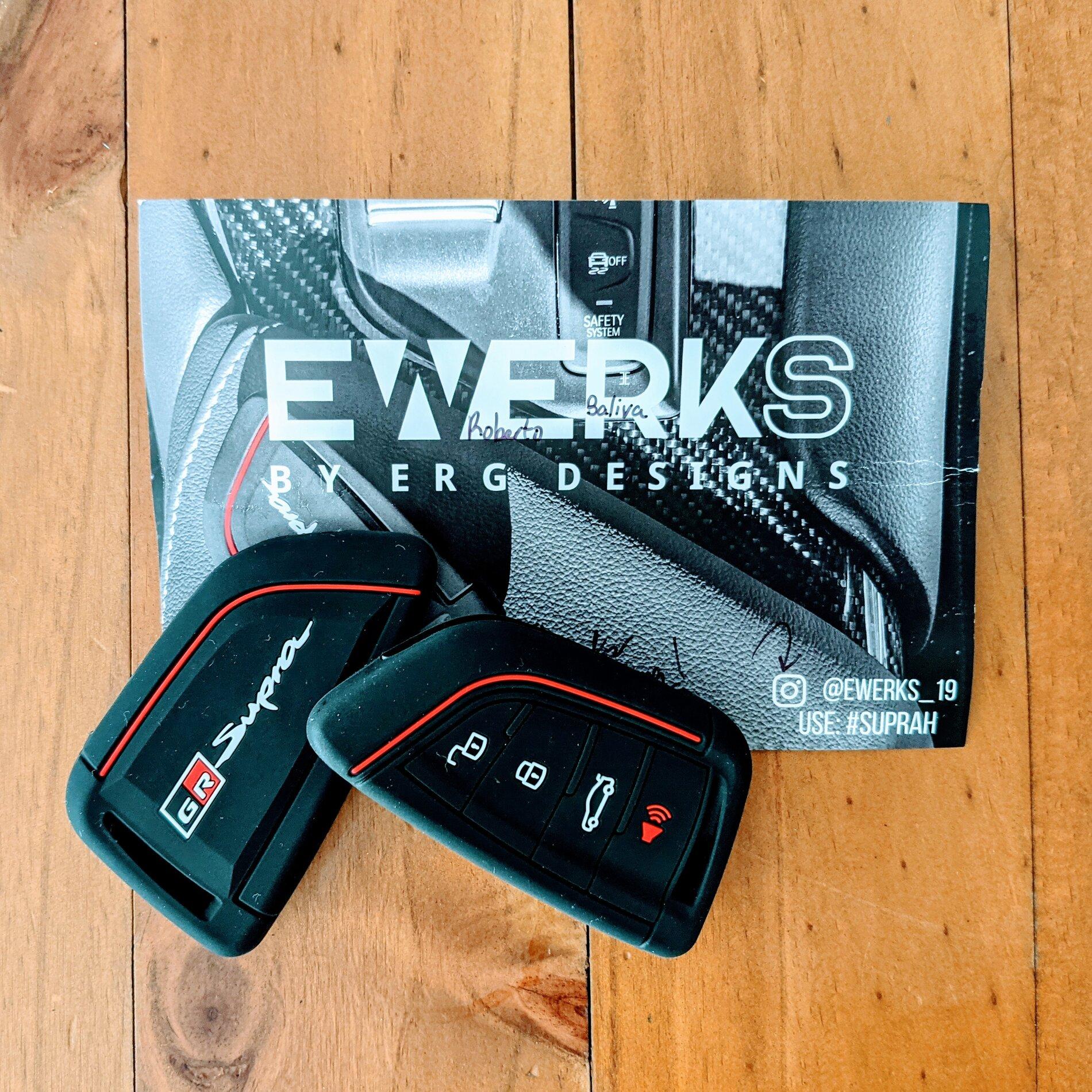

Sorry no answer from me but there was another discussion about replacement keys in the forum. Don't recall if a solution was found.
It fell out of my pocket once then I got this and solved the problem.
