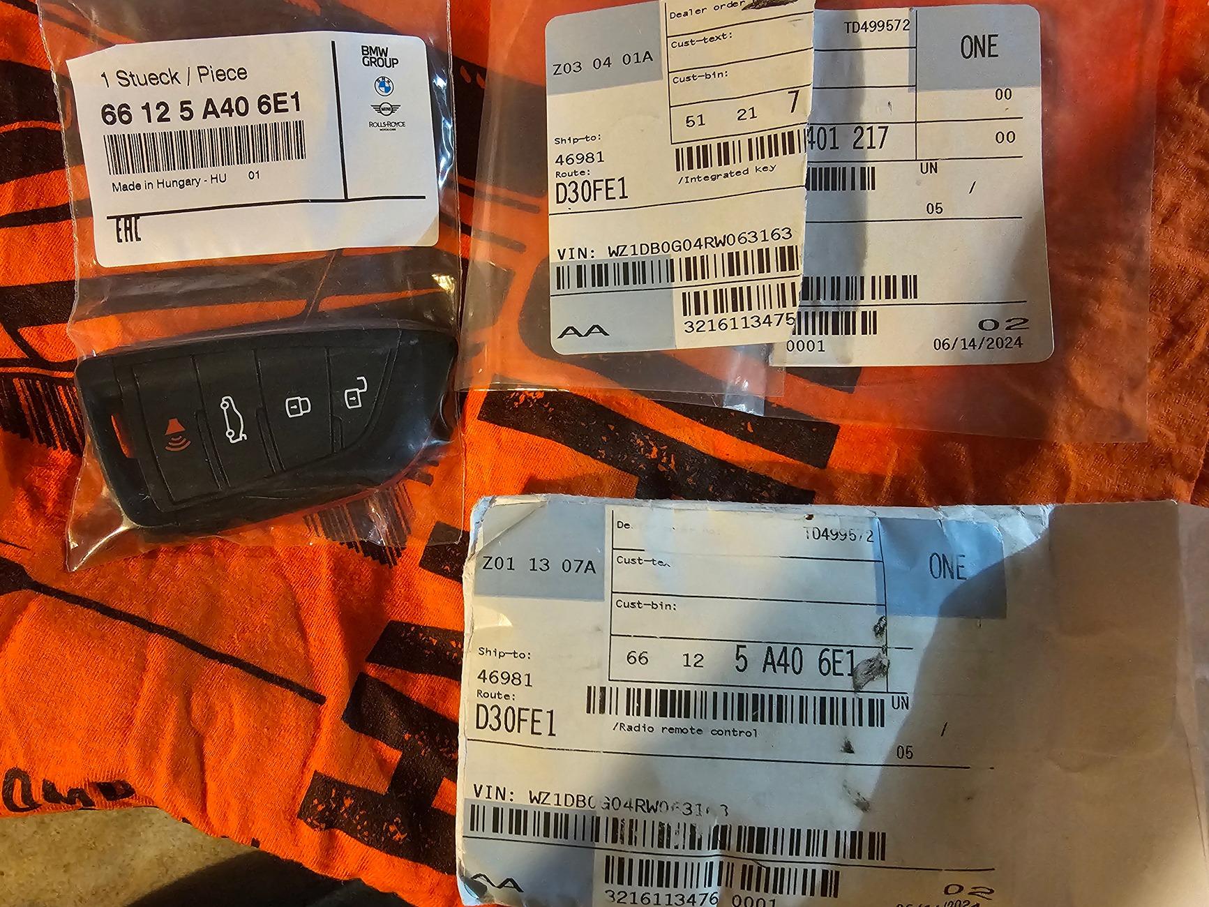

Toyota dealers are clueless. I had the same problem with my car. Only came with 1 key. Toyota did order a key for me but it came from bmw. All packaging and part numbers on it were bmw. Delaer said they needed to program it but when you order the key from bmw it comes preprogrammed to your vin and there is a short sequence you perform on your own with your original key and it syncs up. I got my car in May and my key arrived in July. I synced it to my car in my own garage no dealer needed.
This is good news. So I have to order the key through the dealer (1k) but i can pick it up and program it myself. Saving $200. Do you mind sharing the programming process or a link?

I don't believe the at home process will work with a used fob.
Google bmw key programming. Its something like use your original fob and lock the car. Wait 5 minutes. Unlock the car with original fob then place original fob at least 50 feet away. Now go inside vehicle and hold new fob where a normal key would go in ignition behind steering wheel, hold brake and press start button. Car should start and now key is programmed.
I personally would still try going through bmw with their part number... even if they gave you and unprogrammed key for 250 toyota would charge 200 to program and you'd still be less than 1k.
