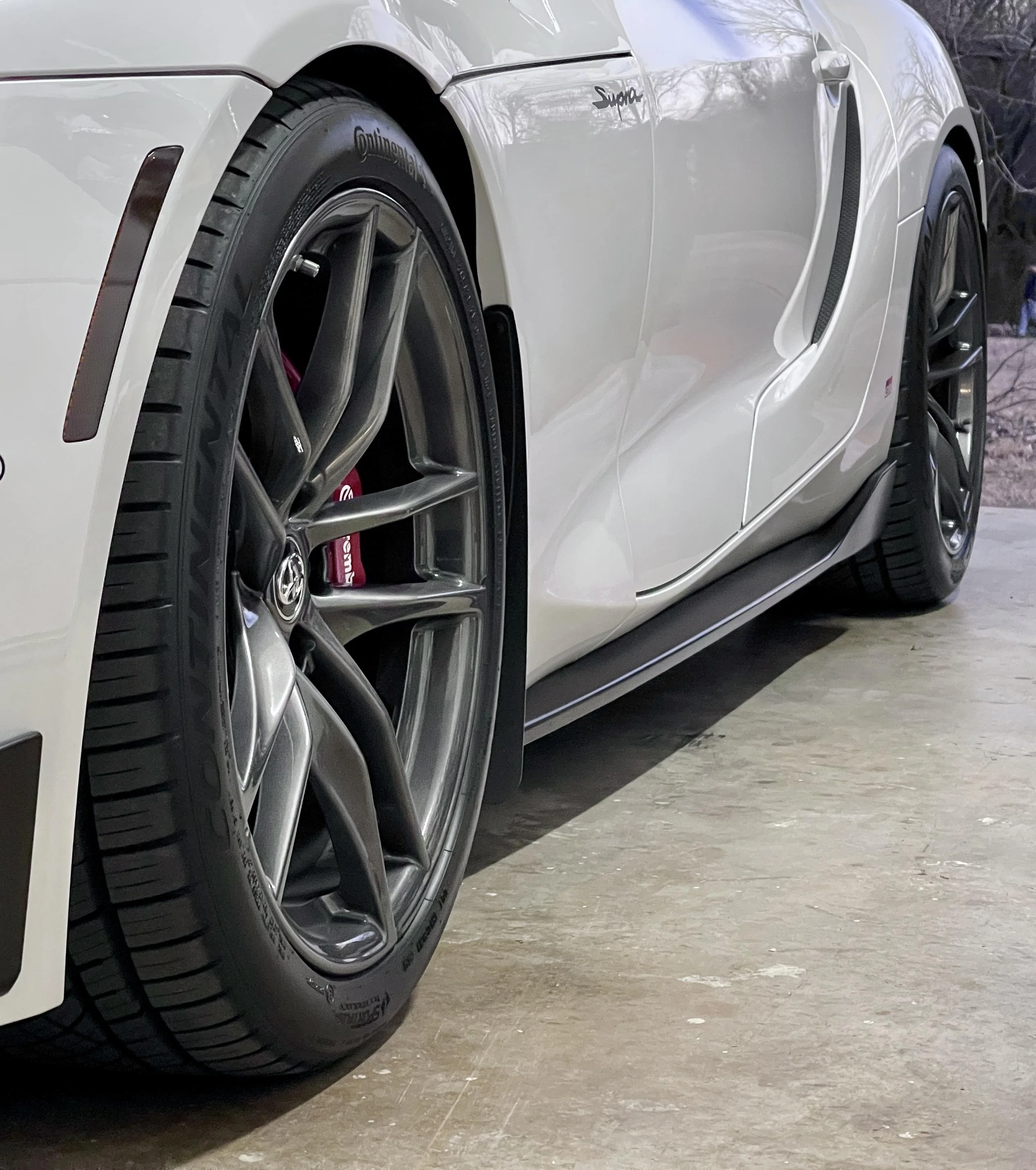

Just to give you a visual idea. Here's my current setup with OEM wheels (9F/10R).
265/35 front on 10mm spacers and 285/35 rear on 13mm spacers. Lowered on Eibach Euro/Z4 spec .8in/20mm drop.
