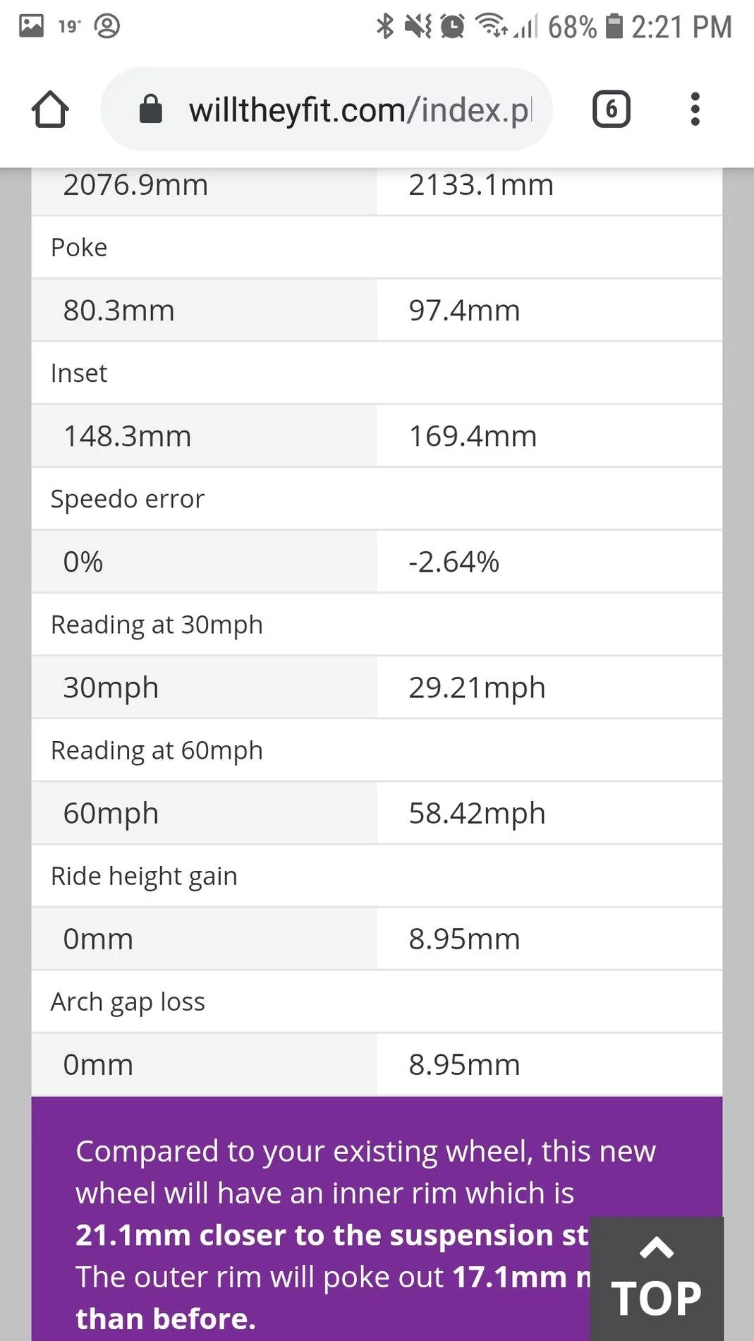

Hi would anyone know if the Supra will fit a 20X10.5 +36 offset on the front with 285/30/20? I'm thinking of doing a square set up.

Based on the comparison it's -2.64% difference. It's less than 3% so does this mean it will work?

I doubt it, i don't even think you will be able to bolt it in, I haven't check how much clearance we have inside,but it might hit the inside suspension... and it will poke way to much out.
I've seen someone on this forum put on 19X10.5 but it was 19 and not 20.
